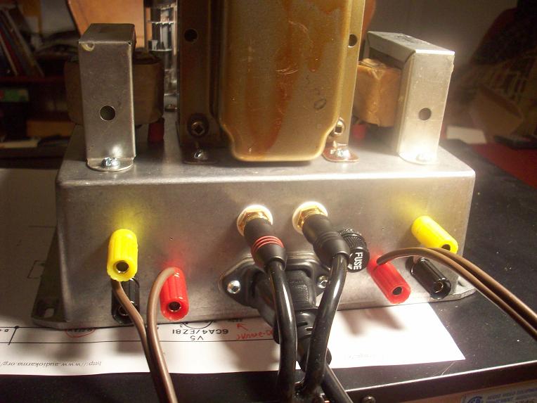

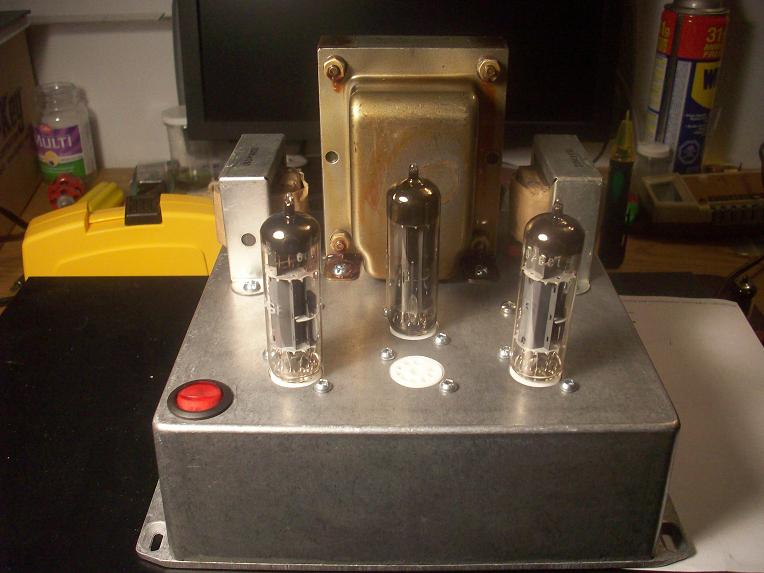

Here are some pictures of the completed amplifier.

I'll work on aesthetics a bit, perhaps a wood plinth, perhaps add an EM84, and that'll be it!
