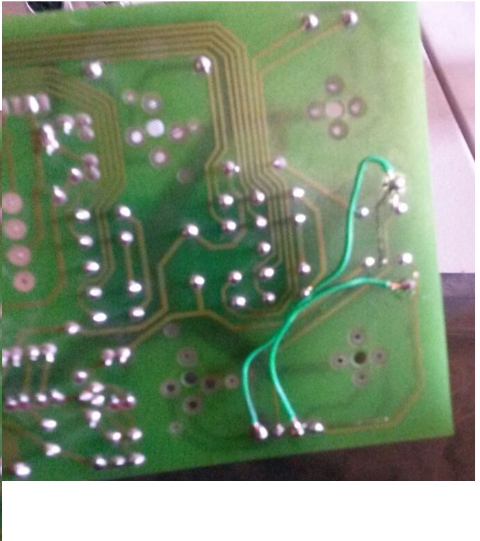

So i thought i repaired a klark teknik dn360 31 Band Graphic Eq but i just tested and audio output is really low i mean mV (barely hear)

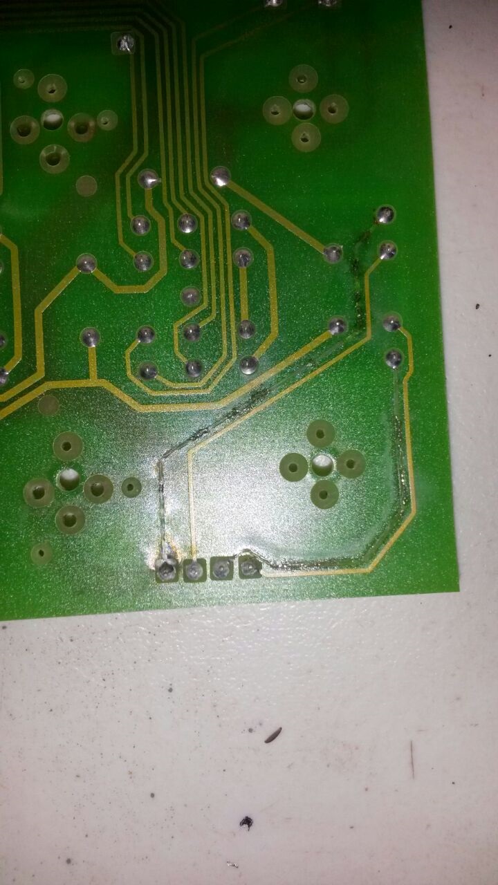

I replaced both input NE5532(I/o board) , Replaced Both 7818(psu) regulators misc caps and one of 2 DG308A(Eq Board) All of these Shorted
(initial problem link Need guidance repairing vintage 31 band EQ - Page 1)
Now unit turns on relays click no visual Overheat
So i pluged Xlr to Rca adapters and put some music , before turning on the EQ audio passes through. after relay´s click audio goes to the "inside" and comes out so so dim you nedd to turn the amp to 11 to barely hear it so i need some expert help looking at the Schematic and take a look were most likely is the problem i have no Oscilloscope to test 🙁
What i think may be the problem
#1 Bad conexion inside the relays , unlikely since bowth click , channel a and b but the do get warm
Update Channel B does not work , older problem
#2 Maybe the TL074 is not working properly
*Tested with simple led circit , it works
I assume all NE5534 are the frequency gain stuff so i assume if they don´t work only specific band will be missing (just my assumption)

Don't change things indiscriminately, it is a waste of time and money. All of the quad amps will not have gone down so you will have sound of sorts!
Use basic fault finding procedures.
Supply a signal and does it appear on the first IC? (IC2). If yes follow the signal path. If no check the input relay/transformer.
If yes but no output, has IC2 got + & - supply? If yes, check the IC.
There is a link panel that allows for an output transformer for balanced line out. Is it wired correctly? See page 8 of service manual.

i didn´t indiscriminately changed IC all the ones i changed where causing short on the PSU , i traced voltage to all the ICS and they are fine , will trace signal but not entirely sure , is was going to probe the inverting pin and ground (ic1), look for voltage then move to the output , next IC is this the way?

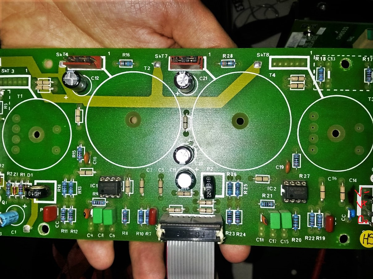

Interesting pcb, it seems to be 2 layer (power supply has tracks on top of pcb) yet there are lots of zero ohm links in the audio side.

1990 Tech i guess
