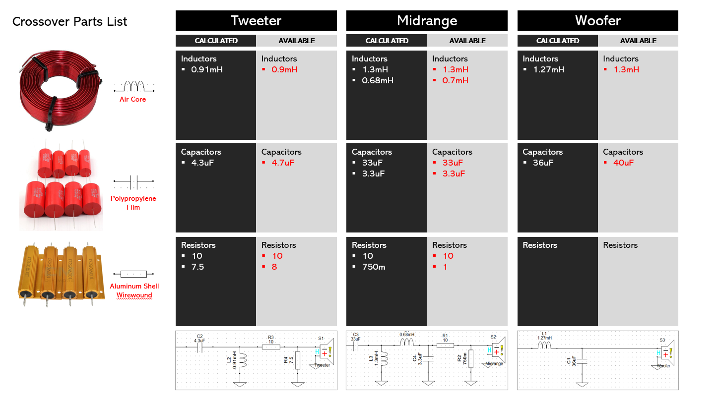

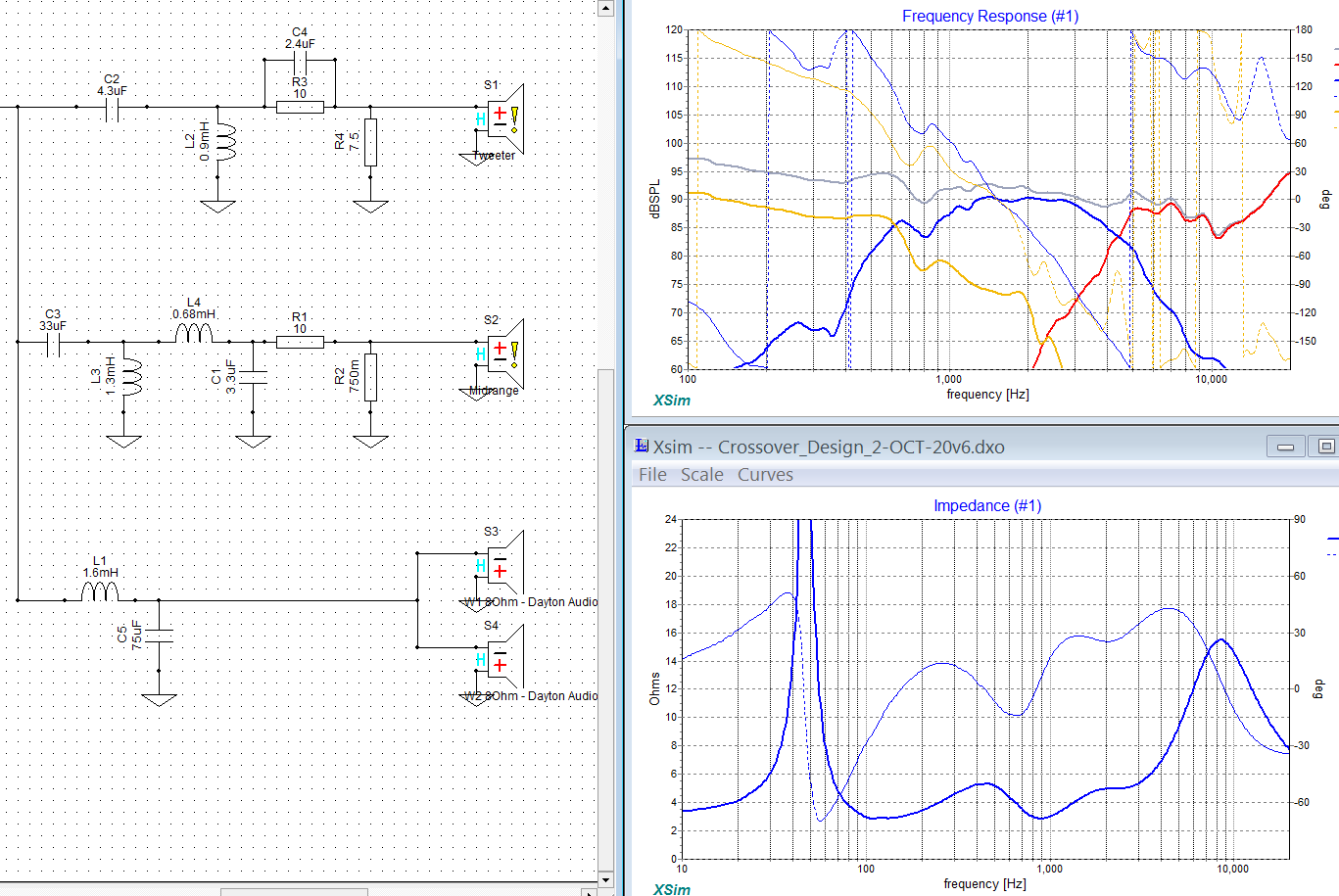

At this point it would not be helpful to blow your budget on expensive parts. This is not where you make the primary difference, that is done with your crossover calculations and the quality of your data.
It is likely that you will want to tweak the values anyway. It is often a challenge to equate what you hear with what the charts tell you. You might end up changing some of those components.
Are you happy with the crossover at this early stage, or can you see a place for improvement?

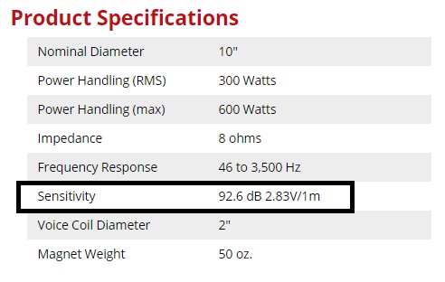

Sadly due to space limitations I can no longer use the big bulky boxes with the 15" woofer (see picture attached). Hence the move to 2x 10" woofer per speaker.
Plus the Emotiva center channel while very good can't keep up with the left and right (I prefer not to reduce the levels). So I want to make 3x speakers LCR with identical components.
I think the first thing to check is if the suggested 10" woofers would blend in better than the 15" woofer (where I am not too confident with manufacturer data anyways plus there is no zma available) with the right crossover?
I am reattaching the .dxo file with the data of the 10" woofers included. I am very confident with the data Dayton Audio provides.
