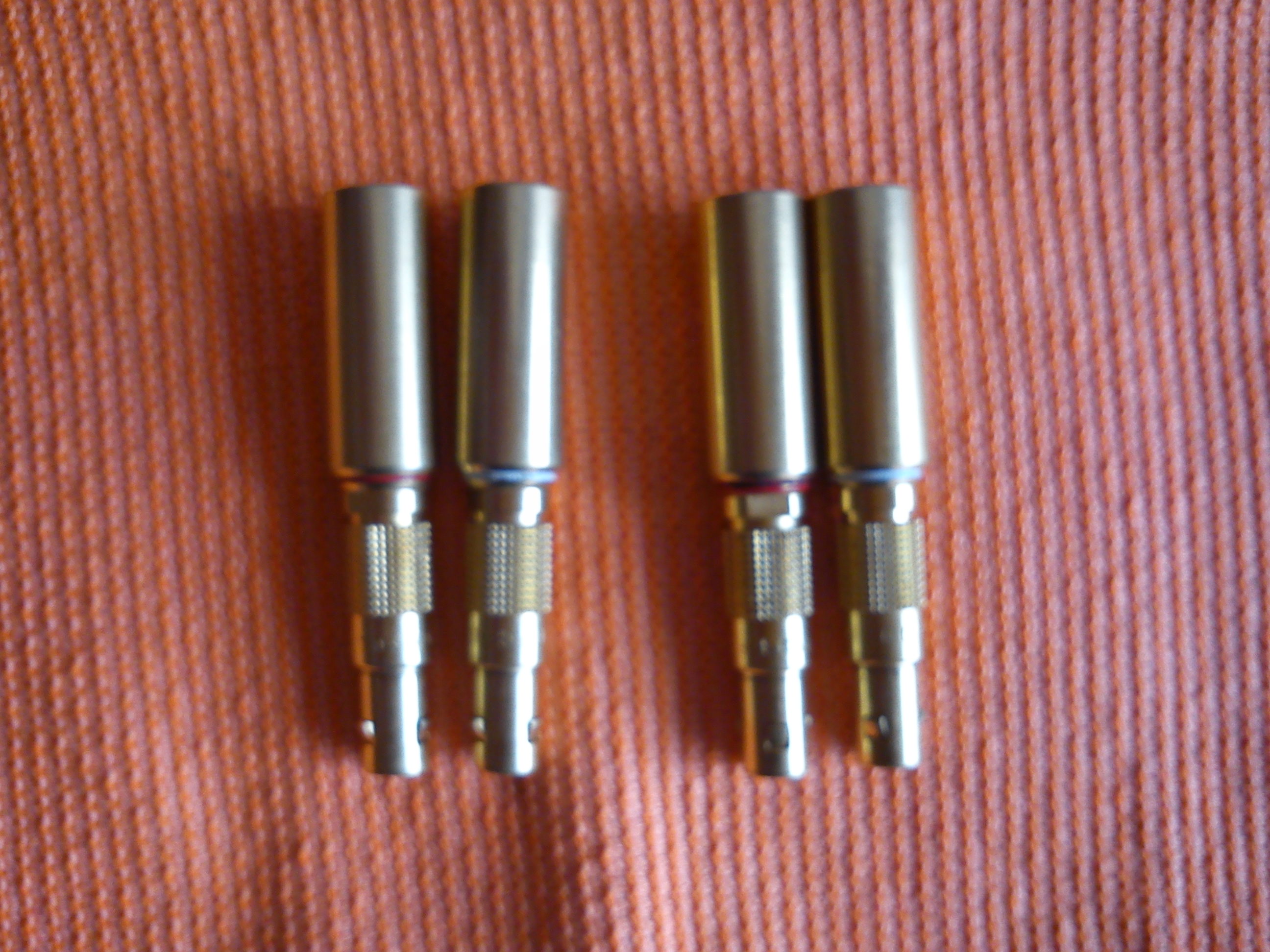

Camac (or Lemo) are not the same as BNC.
Besides that there are a lot of different sizes. If you want connect older Mark Levinson
equipment you need Lemo 00 plugs. Mouser for example stocks them.
Personally I think soldering a Lemo to RCA cable is a far better way than to buy
overpriced adaptors. If you do not want to solder those little Lemo connectors you
might consider to buy a Lemo to Lemo cable on ebay, cut it in half and solder RCA
connectors on the other ends.
