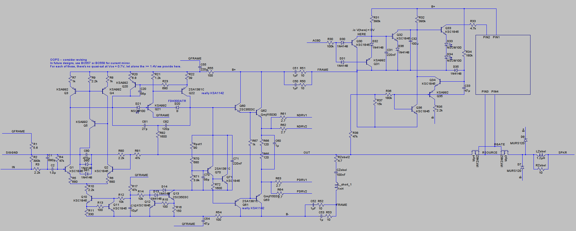

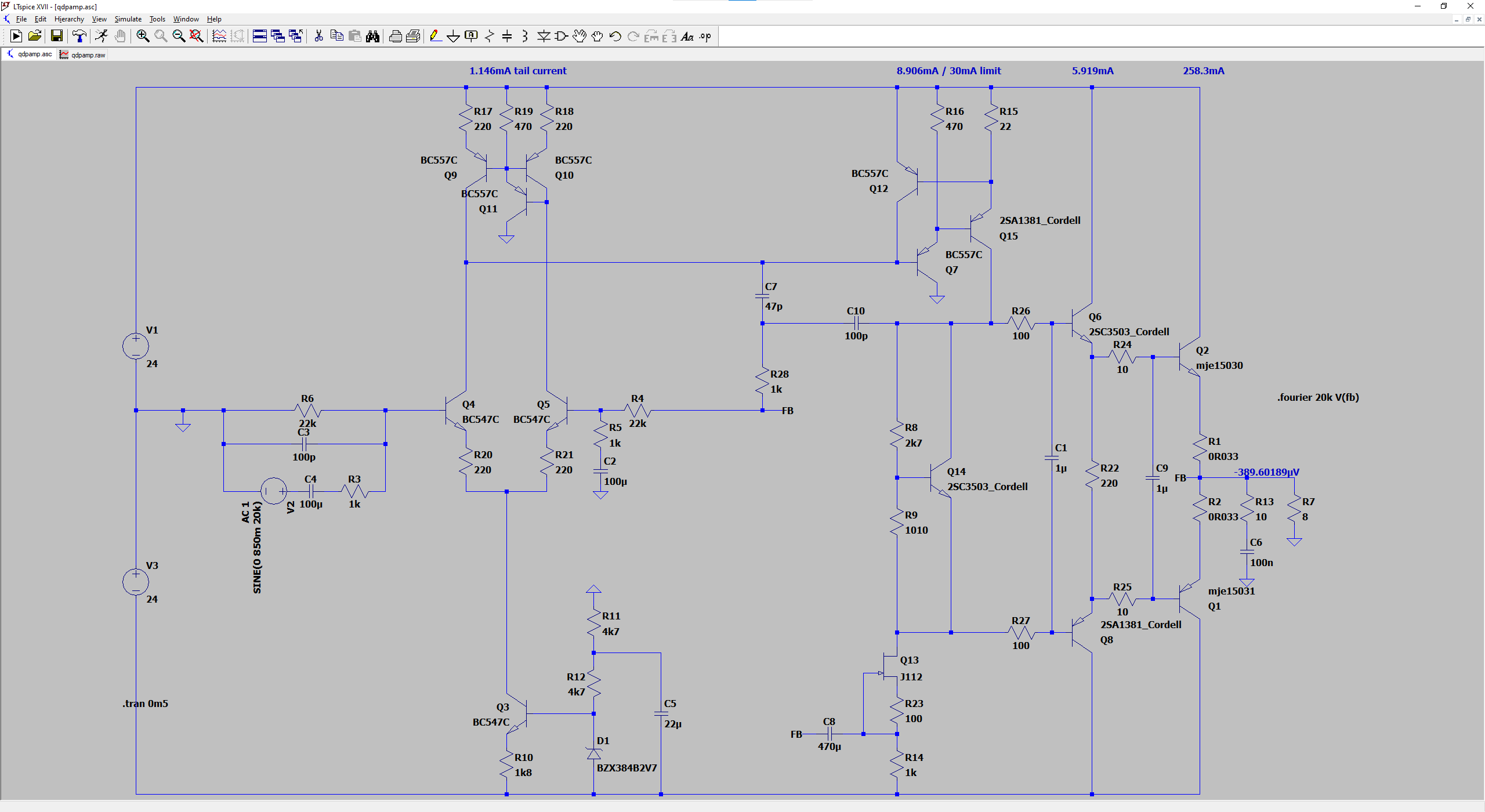

Hello guys.
I'd like some feedback on the design in the attachments :)
Basic idea is to get a "cost effective", reliable 20W per channel amplifier that works up to 2W in class A, then goes into class B. The initial name for it was "The Quick 'n Dirty" but it kinda grew. Thankfully it still has managable ammount of parts :D
The power devices will be MJW3281A + MJW1302A, drivers and VAS will be KSC3503 + KSA1381, other transistors are BC550C + BC560C.
I selected oversized output transistors hoping for reliability, but they also seem to be very linear devices judging from the datasheet.
Because of the quintescent current the idle dissipation will be around 20W per channel. I want to put both channels on the same extruded heatsink. I think that 0.7W/K should be good enough, giving around 25K temperature rise.
I don't know how big the transformer should be? Around 120VA?
Do you have any critiques of the schematic, or ideas of improvements? I added a strange way of current sinking the VAS - a JFET current source with bootstrapped feed point - simulation shows over 40 times less current fluctuation over just the CSS. Or is it better to go pure bootstrap for simplicity?
Another question is about the Vbe multiplier - what should be the current of the resistors vs the transistor? I went for around 10%.
The buffered VAS is almost literally lifted from "Designing Audio Power Amplifiers", along with the degenerated diff-pair.

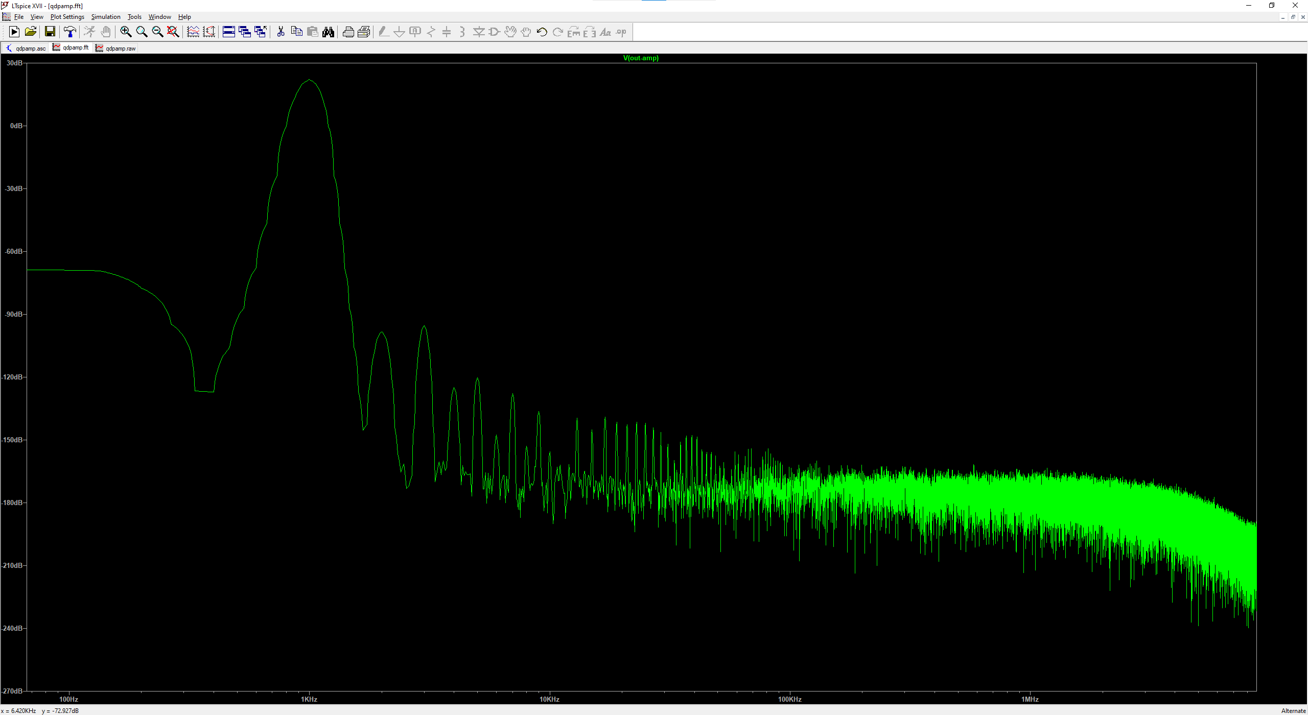

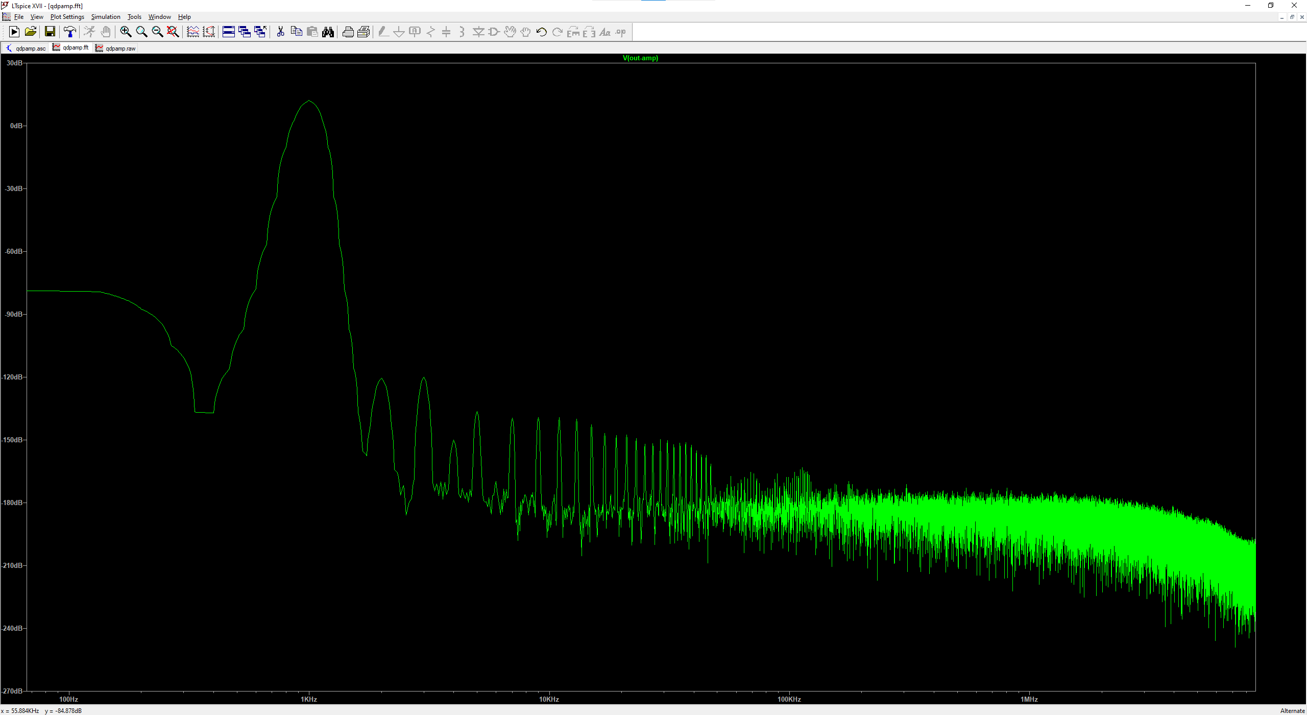

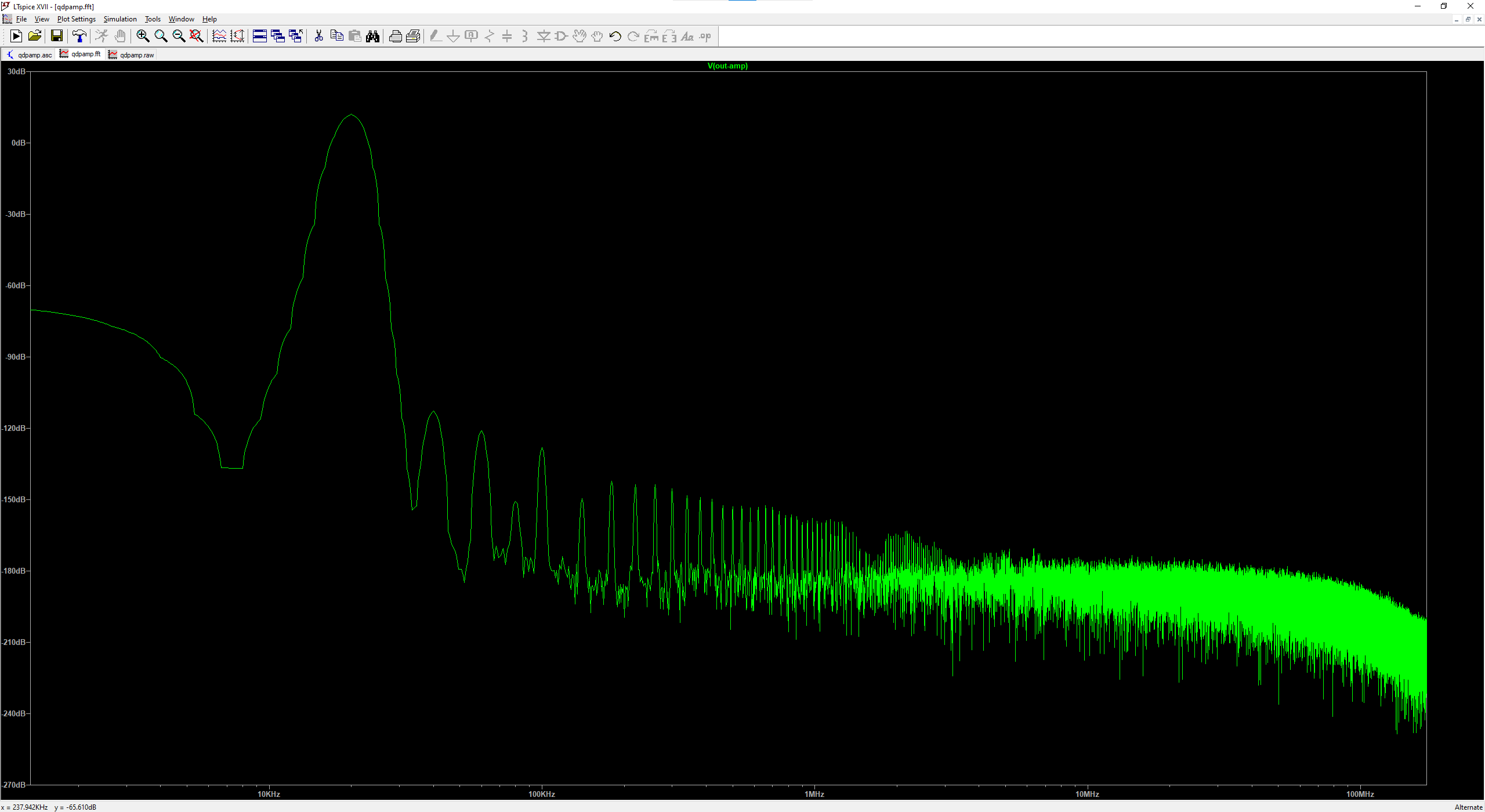

Distortion simulation:
Simulated distortion at 2W:
1kHz:
Fourier components of V(fb)
DC component:-0.00829615
Harmonic Frequency Fourier Normalized Phase Normalized
Number [Hz] Component Component [degree] Phase [deg]
1 1.000e+03 5.713e+00 1.000e+00 -0.04° 0.00°
2 2.000e+03 1.337e-05 2.340e-06 179.01° 179.05°
3 3.000e+03 1.229e-05 2.151e-06 125.77° 125.82°
4 4.000e+03 6.356e-06 1.113e-06 -174.36° -174.32°
5 5.000e+03 5.522e-06 9.666e-07 -163.92° -163.88°
6 6.000e+03 4.061e-06 7.108e-07 -171.09° -171.05°
7 7.000e+03 3.348e-06 5.860e-07 -169.00° -168.96°
8 8.000e+03 2.848e-06 4.985e-07 -168.37° -168.33°
9 9.000e+03 2.431e-06 4.256e-07 -166.52° -166.48°
Total Harmonic Distortion: 0.000368%(0.010447%)
20kHz:
DC component:-0.00047394
1 2.000e+04 5.710e+00 1.000e+00 -2.64° 0.00°
2 4.000e+04 5.607e-06 9.820e-07 -171.99° -169.35°
3 6.000e+04 1.547e-04 2.709e-05 89.22° 91.86°
4 8.000e+04 2.673e-06 4.681e-07 -82.28° -79.64°
5 1.000e+05 6.515e-06 1.141e-06 -104.59° -101.95°
6 1.200e+05 2.596e-06 4.547e-07 -83.36° -80.72°
7 1.400e+05 3.294e-06 5.768e-07 -82.14° -79.50°
8 1.600e+05 2.590e-06 4.536e-07 -80.86° -78.22°
9 1.800e+05 2.546e-06 4.459e-07 -79.49° -76.85°
Total Harmonic Distortion: 0.002715%(0.014649%)
Simulated distortion at 20W:
1kHz:
DC component:-0.0261355
1 1.000e+03 1.802e+01 1.000e+00 -0.04° 0.00°
2 2.000e+03 4.731e-05 2.626e-06 162.42° 162.46°
3 3.000e+03 1.734e-04 9.622e-06 77.29° 77.33°
4 4.000e+03 2.033e-05 1.128e-06 -169.34° -169.30°
5 5.000e+03 7.043e-05 3.909e-06 82.99° 83.03°
6 6.000e+03 1.312e-05 7.281e-07 -169.73° -169.69°
7 7.000e+03 3.008e-05 1.670e-06 98.53° 98.57°
8 8.000e+03 9.625e-06 5.342e-07 -167.02° -166.98°
9 9.000e+03 1.468e-05 8.147e-07 156.30° 156.34°
Total Harmonic Distortion: 0.001097%(0.014298%)
20kHz:
DC component:-0.00146531
1 2.000e+04 1.801e+01 1.000e+00 -2.65° 0.00°
2 4.000e+04 7.307e-05 4.058e-06 168.82° 171.48°
3 6.000e+04 9.948e-04 5.525e-05 70.31° 72.96°
4 8.000e+04 1.388e-05 7.709e-07 2.20° 4.85°
5 1.000e+05 3.045e-04 1.691e-05 13.13° 15.78°
6 1.200e+05 8.406e-06 4.668e-07 -93.06° -90.41°
7 1.400e+05 2.128e-04 1.182e-05 55.56° 58.21°
8 1.600e+05 7.834e-06 4.351e-07 -69.22° -66.56°
9 1.800e+05 1.633e-04 9.066e-06 64.24° 66.90°
Total Harmonic Distortion: 0.005981%(0.015468%)
Is this any good? I know that the simulation uses different output transistors, but it should give some idea to more experienced designers than me.

Id say you've got a pretty good result there, though with only 47pF of compensation you may find it unstable in practice.
Consider using an LED for the LTP's current source reference. They are lower noise.
Also do a startup simulation using the options "startup uic" in LTSPICE. This will show you what the circuit will do on power up. Set the signal input to 0V when doing that

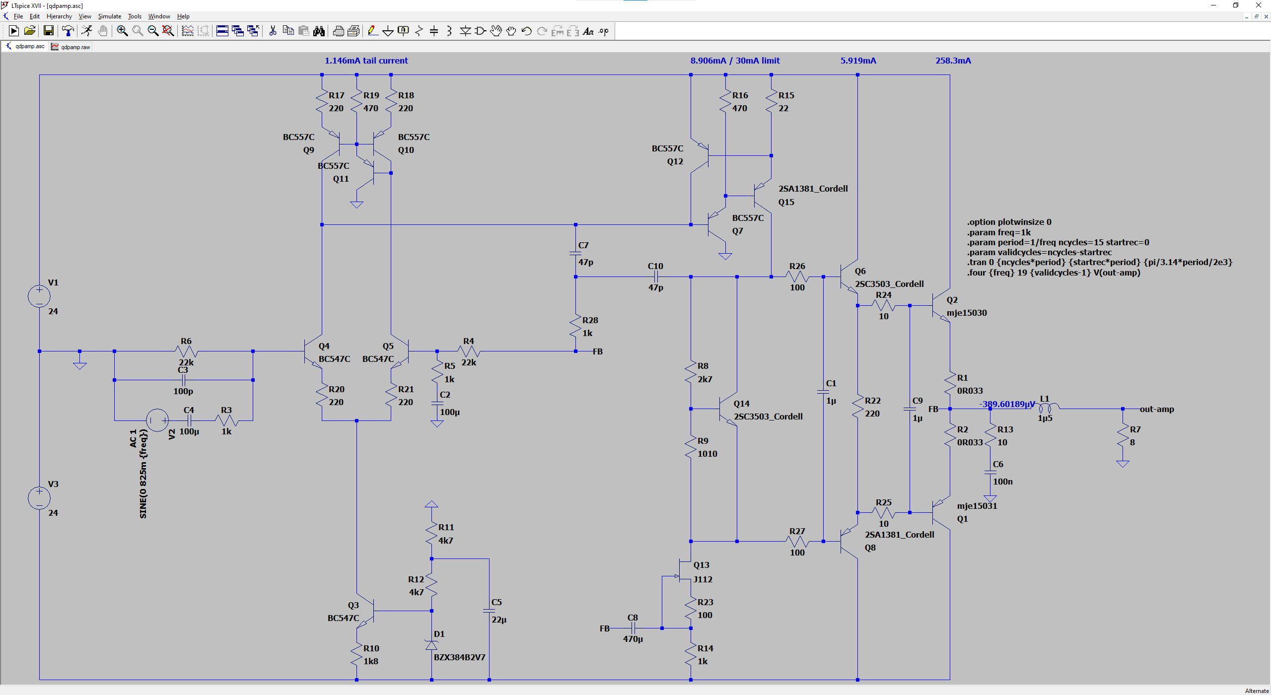

@jaycee About the LED vs Zener LTP reference - I started with a green LED in that position but then remembered that zener noise goes lower with accumulated on time. But that might have been about ovenized voltage references :D Also the output impedance of the CSS should be higher with higher reference voltage. I will go back to the LED though - seems a lot of amplifiers use them here.
Thanks for the comment about the miller cap - I read some more and found that Baxendall proposed to split the compensation at low frequency with a resistor from the midpoint of two capacitors in series in the position of the current miller cap to the amplifier output to get higher open loop gain - how would one pick optimal values?
On startup simulation I get a transient on the output towards the positive rail that settles to 0V after ~0.5ms, pushes 2.7A current spike into the load in this time.
No cross conduction in the output.
The VAS CSS doesn't go to full operating current for ~100ms - probably because of the bootstrap capacitor charging slowly - boostrap point takes ~2.5s to settle to its nornal operating voltage.
After VAS CSS loads the stage output gets biased.
Seems like 'normal' behaviour - would get a loud pop from the speaker likely.
Plan B, go for a 2.7-3 V zener, these are much quieter as well (thermal stability obviously is not quite as good).
Input tail current of >2 mA seems a bit hot to me, I'd shoot for more like 1 mA. Slightly modify the VAS if need be.
If you do need 378 mA of idle current, 0R1 emitter resistors actually aren't optimum. Try something like 0R033 instead.

Going back to TMC - more open loop gain should help distortion across the board, right?
At least where it's important. The whole idea behind higher-order compensation is gaining higher open-loop gain in the audible and near ultrasonic range where it's needed, and then dropping back down quickly and returning to a first-order response before unity gain rolls around so that stability is not affected.
That said, get the rest of the circuit sorted out first.

About the LTP current - at lower current the transistors will get more hfe? Or what other motivation do we get here to lower the tail current? As is VAS + miller feedback needs ~71uA RMS drive current for 20W output power. Seems that lowering drive capability might hurt slew rate and THD?
The idle current was just somewhat random, I didn't play around much with it - probably 250mA might be enough for what I wanted to do. With emitter resistors you aim for some maximum voltage drop rule of thumb?

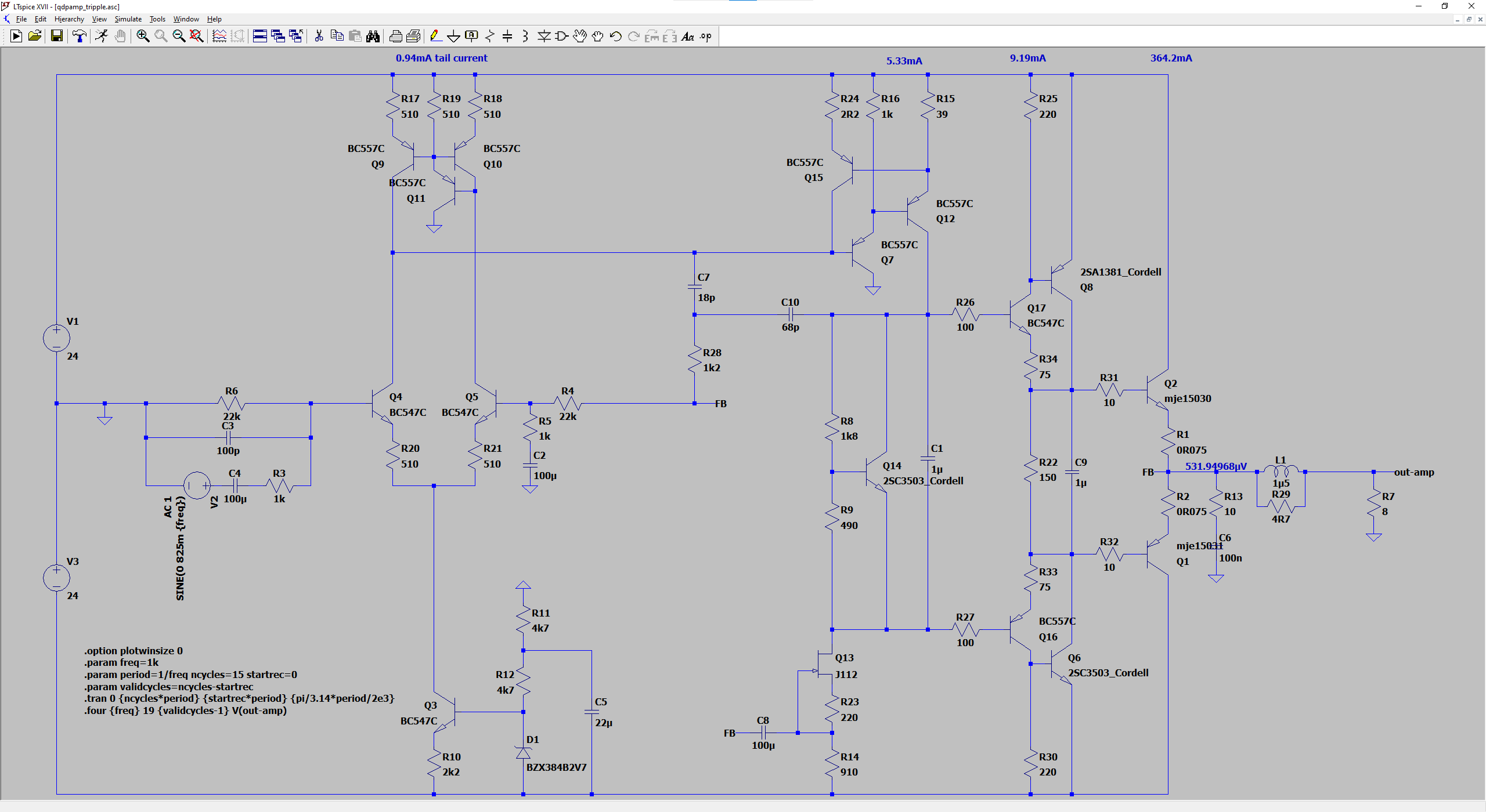

I edited the schematic a bit and thrown in TMC - at first glance it flattened out THD across the power range!!!

Okay, schematic after tweaks in attachments.
Changes:
Modified VAS miller feedback to TMC, lowered LTP tail current to ~1mA, lowered emitter resistances to 0R033, changed idle current to ~250mA.
Output offset increased, but is less than 0.5mV.

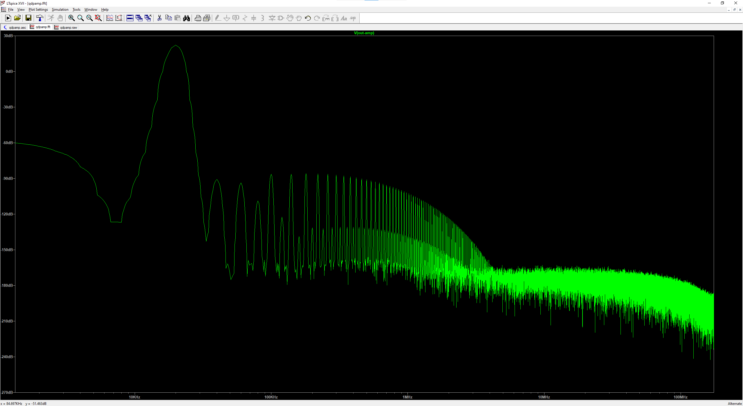

New distortion figures:
Code:
1kHz:
DC component:-0.00866705
    1   	1.000e+03	5.713e+00	1.000e+00	   -0.05°	    0.00°
    2   	2.000e+03	1.308e-05	2.289e-06	  176.92°	  176.97°
    3   	3.000e+03	7.567e-06	1.325e-06	 -176.65°	 -176.60°
    4   	4.000e+03	6.395e-06	1.119e-06	 -174.01°	 -173.96°
    5   	5.000e+03	4.991e-06	8.736e-07	 -173.34°	 -173.29°
    6   	6.000e+03	4.060e-06	7.108e-07	 -171.56°	 -171.51°
    7   	7.000e+03	3.361e-06	5.884e-07	 -169.78°	 -169.73°
    8   	8.000e+03	2.822e-06	4.940e-07	 -167.58°	 -167.54°
    9   	9.000e+03	2.435e-06	4.262e-07	 -166.65°	 -166.60°
Total Harmonic Distortion: 0.000321%(0.010275%)
20kHz:
DC component:-0.000845273
    1   	2.000e+04	5.708e+00	1.000e+00	   -2.77°	    0.00°
    2   	4.000e+04	4.107e-06	7.195e-07	 -135.01°	 -132.24°
    3   	6.000e+04	1.362e-06	2.387e-07	 -121.11°	 -118.33°
    4   	8.000e+04	3.839e-06	6.726e-07	  -81.43°	  -78.66°
    5   	1.000e+05	3.078e-06	5.392e-07	  -79.82°	  -77.05°
    6   	1.200e+05	3.829e-06	6.709e-07	  -77.37°	  -74.59°
    7   	1.400e+05	3.678e-06	6.443e-07	  -76.47°	  -73.70°
    8   	1.600e+05	3.851e-06	6.748e-07	  -72.95°	  -70.17°
    9   	1.800e+05	3.804e-06	6.664e-07	  -70.88°	  -68.11°
Total Harmonic Distortion: 0.000176%(0.009541%)
1kHz:
DC component:-0.0265072
    1   	1.000e+03	1.802e+01	1.000e+00	   -0.05°	    0.00°
    2   	2.000e+03	4.358e-05	2.419e-06	  161.17°	  161.22°
    3   	3.000e+03	4.893e-06	2.716e-07	 -164.84°	 -164.79°
    4   	4.000e+03	2.057e-05	1.142e-06	 -169.87°	 -169.82°
    5   	5.000e+03	1.495e-05	8.297e-07	 -170.13°	 -170.08°
    6   	6.000e+03	1.362e-05	7.559e-07	 -168.35°	 -168.30°
    7   	7.000e+03	1.098e-05	6.097e-07	 -166.95°	 -166.90°
    8   	8.000e+03	9.875e-06	5.481e-07	 -165.00°	 -164.96°
    9   	9.000e+03	8.545e-06	4.743e-07	 -163.98°	 -163.93°
Total Harmonic Distortion: 0.000306%(0.014295%)
20kHz:
DC component:-0.00183475
    1   	2.000e+04	1.800e+01	1.000e+00	   -2.77°	    0.00°
    2   	4.000e+04	3.866e-05	2.148e-06	  179.35°	  182.13°
    3   	6.000e+04	4.826e-05	2.681e-06	  -18.77°	  -16.00°
    4   	8.000e+04	1.001e-05	5.561e-07	  -55.73°	  -52.96°
    5   	1.000e+05	1.400e-04	7.780e-06	    7.01°	    9.78°
    6   	1.200e+05	1.023e-05	5.682e-07	  -88.09°	  -85.32°
    7   	1.400e+05	1.472e-04	8.177e-06	    5.06°	    7.83°
    8   	1.600e+05	9.171e-06	5.095e-07	  -79.04°	  -76.26°
    9   	1.800e+05	1.554e-04	8.633e-06	    5.39°	    8.16°
Total Harmonic Distortion: 0.001465%(0.014481%)
They seem very optimistic to me, LTSpice might be lying here?

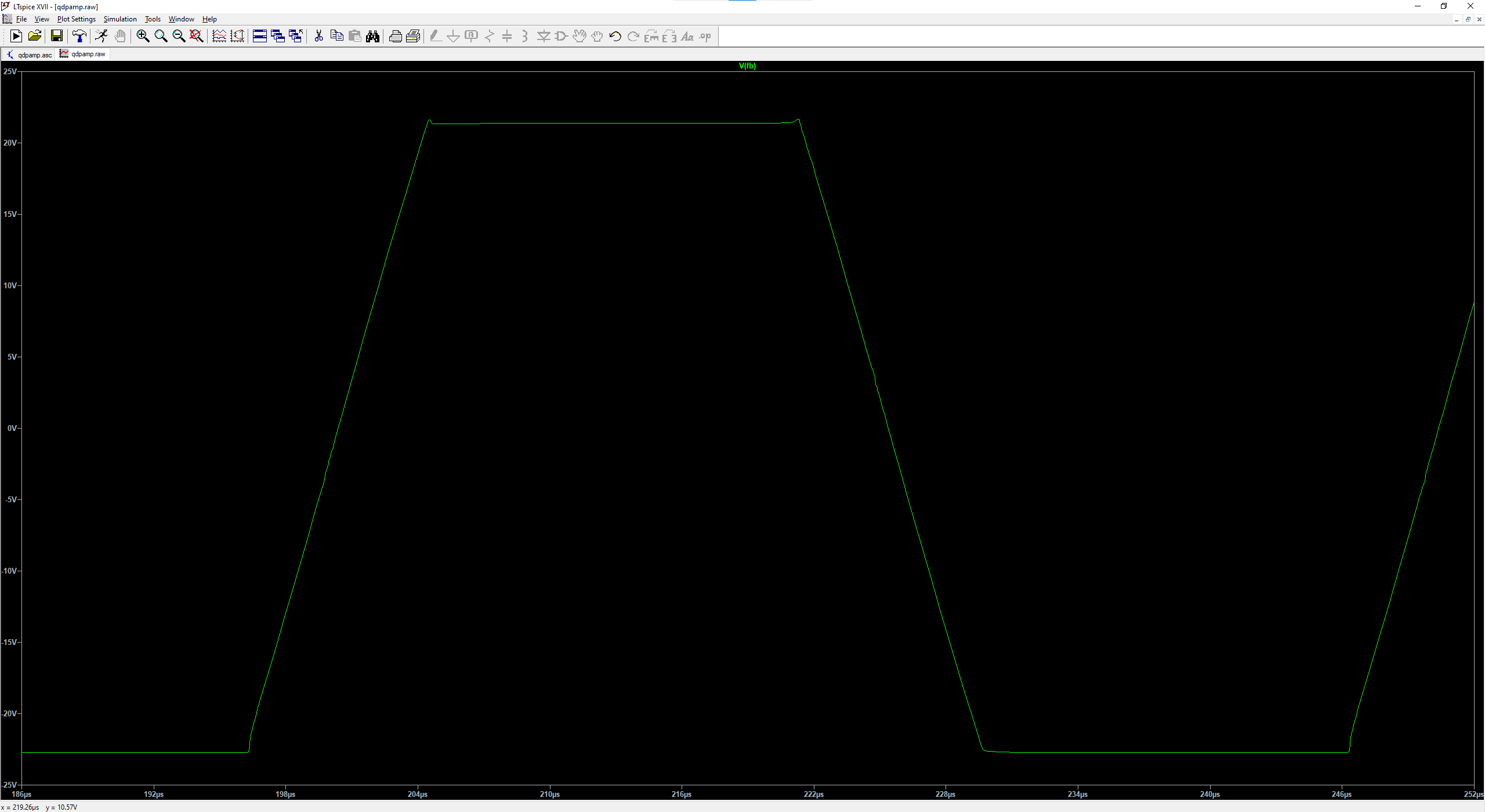

EDIT: Simulation shows that on clipping negative excursions stick to the rail (bootstrap fault?) and positive have something that looks like gain inversion near waveform peak (horns on the waveform).

At this lower idle current, go to 0R039 or 0R047.
Yes and no.
Yes - perfectly matched parts at constant equal temperature, perfect impedance balance, and I think BJT parasitic capacitance nonlinearity still is not modeled particularly well, so things would definitely tend to be optimistic.
No - even as-is, you're hitting some accuracy / compression related limits, I think. I'd suggest adopting something like this:
Code:
.option plotwinsize 0
.param freq=1k
.param period=1/freq ncycles=15 startrec=0
.param validcycles=ncycles-startrec
.tran 0 {ncycles*period} {startrec*period} {pi/3.14*period/2e3}
.four {freq} 19 {validcycles-1} V(out-amp)
with a SINE source of frequency {freq}. Also compare .FOUR results to FFT (N = 65536, Kaiser-Bessel window, Beta = 20 or so). .FOUR can be upset e.g. by coupling capacitors that aren't more than ample.
A "blameless" 80 wpc amp can hit <0.001% THD, so results of this magnitude definitely are quite feasible.
You should probably go research the subject of clamping diodes and other rail sticking fixes.
BTW - output inductor? (~1.5 µH || 4R7 or so)
I added the inductor (it is parallel with 4R7, it just isn't visible in the schematic) and simulated the circuit again, FFT plots, actual schematic and asc in attachments. (Haven't touched the rail sticking problem yet.)
I changed SPICE relative tolerance to 1E-12 to get more accurate simulation (should I go even lower?).

Seems that .fourier is not accurate (20kHz @ 2W has almost 0 THD... while in the plots it has clearly more than 1kHz @ 2W).
Also there are large ammounts of high order odd harmonics for 20kHz @ 20W - how can I fix this? Miller comp?
offtopic: can I make the code tags to collapse?

For a.c. R28 and R14 are in series. You are asking the feedback line to represent 0 volts in one sense and to drive R14 and modulate a constant current arrangement in another. The voltage drop across R14 would generate a feedback signal which would merge with that in R28. The only way that I can see to separate these paths is to connect R28 to ground.
But FB is driven by low impedance output pair - so shouldn't this work as desired with R14 being bootstrapped through C8?
Then R28+C7 provides miller feedback from the output stage untill C10 impedance isn't smaller than R28 resistance (~500kHz), at which point miller feedback is closed just around the VAS with C7+C10 - this is how I see the arangement working here. Should give more open loop gain in acoustic frequencies than just straight miller compensation.
I think that I have arrived at the final version of the schematic.
I recalculated the emitter resistors for ~10:1 degeneration in all stages.
I replaced VAS transistors with TO92 packaged ones (BC5** series) due to low dissipation and Ccbo being just 2.5pF.
I modified the miller feedback a little, but this compensation scheme is somewhat black art to me :D But it seems to help higher frequency THD figures. Fortunately it's super simple to ommit if it will misbehave.
I was contemplating cascoding the VAS transistor, but decided it overkill and not contributing much for the added complexity.
The bootstrapped CSS can also be simply changed into a straight bootstrap or CSS for testing.
The driver was also modified to use CFPs instead of straight EFs - I wanted to unload the VAS, but didn't want 6VBE drops of the tripple topology. Without base stoppers at the output pair I got oscillation - seems to happen often with CFP. I might add the possibility to tame the lower pair with a small miller cap, but in the simulation base stoppers, well... stopped the oscillations. Also C1 (discharge cappacitor for the buffer) was moved away from the transistor bases, in front of the stoppers - in that position it amplified the oscillations(?).
I decided to use 346.7mA idle current and selected 0R075 emitter resistors for the output pair - might be cheaper to implement as controlled geometry tracks on the PCB than buying resistors of this value :D <= scratch that, this would need a 1mil trace of ~3.5mm length, no way it would survive the currents needed ;-)
Sugestions welcome as always :)
I have one question though - the output inductor shouldn't be in the global NFB loop, right?

I think if one was to draw up a Gm plot of the output stage Ic on the x axis and Vbe on the y axis the angle of the plot would be very steep and with near to 350 m.A. of standing current.
As the result the crossover point would be at an intermediate power level. If one is going to cross over water make that a stream rather than a river getting up near flood levels.
I hope you are just using MJE transistors for simulation purposes. You need something beefier than 150XX types.
