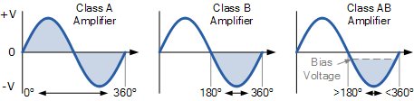

Class AB is somewhere between class A (where conduction happens 100% of the time) and class B (where conduction happens 50% of the time).
The switching from class A to class AB is achieved by changing the bias of the two transistors in the amplifier's output stage. Then each transistor will conduct between 100% and 50% of the time depending on the amount of current output.

The BIAS is what determines the class. In class A, the transistor/tube/MOSFET handles the whole signal swing. Think of the BIAS as a midpoint between + and - signal across the output device. A single ended 300B circuit is a good place to start in understanding this.
In a push/pull arrangement you still can have class A. The PNP/NPN output transistors are each biased for class A - but think of them "overlapping each other" when summed at the amplifier's output terminal.
It is this "overlap" we exploit in class AB. Here each output device is biased so that each output device is still operating in class A for smaller amplitudes - but goes into class AB at higher amplitudes. The BIAS itself does not change. The signal amplitude does.
