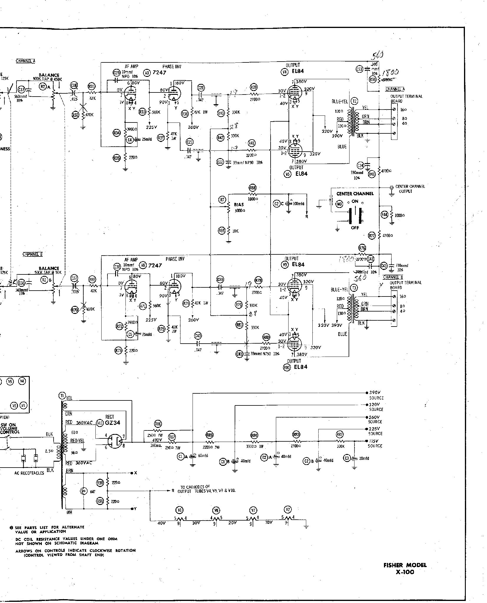

Hello, I am in great need of help, as a diy Newbie i just don't know enough. I have a Vintage Tube amplifier - It's a Fischer Integrated Tube Amplifier that is missing the main Input Transformer, How easy is it to find a modern replacement and will it hurt the performance of the amplifier compared to the original main input transformer? It still has the two Output transformers, can it be saved? And what company would you recommend? -- -- Thanks, Dean
Hi, First - thanks, Cal,
-- sorry the Model is a -- Fisher X-101 B stereo 7591 ... thanks
Definitely go to Heyboer. The odds are long that they already know what goes into a Fisher X-101 B.
Member Tom Bavis may be able to help out in providing a schematic for the unit.
This much I can say, current production 7591s are intolerant of the liberties Fisher took with grid to ground resistance limit. Fortunately, the foundation of a good solution to the problem is provided in Fisher's earlier X-100. Use the 7247/12DW7, instead of the 12AX7, in the O/P section.

Probably an obvious point, but if you are new to this amplifier, and the transformer was kaput or missing when you got it, then it is worth considering that the failed/missing transformer was a symtom of another problem. I.e. don't just fix the new transformer, and switch on without due diligence.
Also, if it has been many years snce the amp was last powered up, you might need to consider bring up the power slowly over an extended period to enable the electrolytics to reform.
Reforming the old 'lytics is poor practice, as (all too often) they have literally dried out over time. Outright replacement of all the old 'lytics is strongly indicated.
BTW, dried out electrolytic caps. may have caused the OEM power transformer to fail.
Hi, thanks Kevin and Eli , I sent a message to Heyboer to see if they can help... and thank you for the info on the 7591 tube problem as well. I also appreciate all the other suggestions / help too. I don't know what else might be wrong with it - If I can find a good transformer for it , I was planning on replacing the caps just to be sure and to then after some more checking of the resistors and etc. , to power it up slowly. I will let you all know what Heyboer's reply is as soon as I hear from them.
My policy with old electrolytics is scorched earth, I'm tired of catastrophic failures minutes to months after putting an old piece of gear back into use. Replace them all, you'll be much happier.
Replacing the coupling caps to the output tubes generally are a good investment in that they keep old leaky caps from upsetting bias and frying your new output tubes.

What sort of mounting method did Fisher use for the power trafo? If it's drop through, a Dynaclone PA060 might fit and definitely could be adapted to the task. I've previously mentioned this possibility for Scott 7591 units. Scan the archives here and over on AA.
Moderately extensive, but quite manageable, PSU design changes would be necessary. For instance, Fisher used "full wave" voltage doublers, but FWCT topology is used with the PA060.
If all else fails, salvage the excellent O/P "iron" Fisher used and install it in a new chassis. A suitable toroidal power trafo can be sourced from AnTek, at modest expense.
