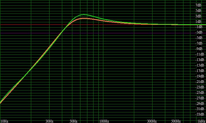

I have a Radio Shack 40-13001A 15" woofer with the following specs:

I modeled a 100l non vented enclosure on Winisd and get a hump at approx 60hz and a falloff of low frequencies. The graph is flat w/ a 400l enclosure but ...save the trees. That's too BIG!
Anyway, what is the best way to proceed. I have a 50 W rms gainclone and am intending to build a 3rd gainclone monoblock for the sub. Should I use a passive xover or is there a simple active surface that will help the linearity?
This is the response in 100l non vented enclosure:
I've modeled it using Unibox and the response is not good. A 15" with an xmax of 1.9mm and an f3 of 45Hz (peak at 73Hz, max excursion with 7w input) in 100litres is not worth the effort IMO.
