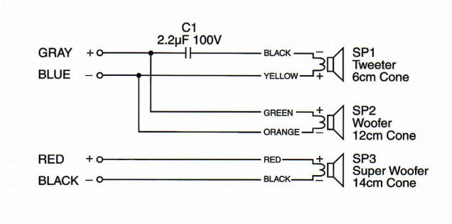

Hello guys,
I have two technics brand loudspeakers which i got from a bargain, the model is sb-eh550, each cabinet has a 6cm tweeter, 12cm bass and a 14cm bass.

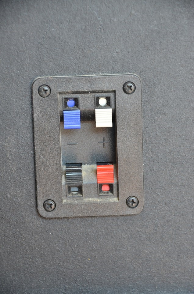

Each loudspeaker has 4 wire connection behind, two going to the 6cm tweeter and the 12cm bass in parallel, tweeter has a 2.2uf high pass cap; another two wire is going to the 14cm bass alone.
I checked the service manual and it lists 200Hz and 4kHz as crossover frequencies. I assume that 4kHz cut is achieved by the 2.2uf high pass cap and 200Hz low pass is intended to be on the original amplifier of the whole system, but i just have the speakers.
Should i be okay just putting a passive 200Hz low pass filter before the input of the 14cm driver and drive the mid-high input directly from the amplifier? Or should i split the amplifier output at 200Hz with a two way crossover, feed the low to the 14cm input and high to the 12cm-6cm combo?
The schematic of the loudspeakers taken from the service manual is in the attachment.
I know active crossovers before the power amplifier would be the normal way to go but simply increasing the amplifier power and using passive crossovers is much cheaper for me right now.
Thanks for any help!

First you need some sense of what you've got. Are they quality pieces worth investing in? Can you run freq responses using REW and your laptop mic, esp with the drivers directly powered individually?
My guess would be that the top feed is full-range and the bottom feed is crudely below 200 Hz. Not likely to too good quality but then some small ambition is evident.
Bi-amping is almost always smart and here might be used by Technics so that two modest chip amps drive the two feeds instead of a single large amp with passive crossover.

If you guess that top feed is full range and the bottom feed is crudely below 200Hz, then why do they mention another cutoff frequency of 4000Hz in the service manual?
So do you suggest me to analyze each driver for their frequency response and decide on crossover frequencies solely according to that? I definitely can do that but i also kind of trust on what Technics engineers have already done and decided on those two cutoff frequencies.
And also, would i lose too much in terms of quality if i just use one big amp with crossovers instead of bi-amping? It might be efficient and smart but it's that i find it more complicated for me.
thanks
The 4000Hz is the 6dB/oct high pass/low cut filter (C1) for the tweeter.

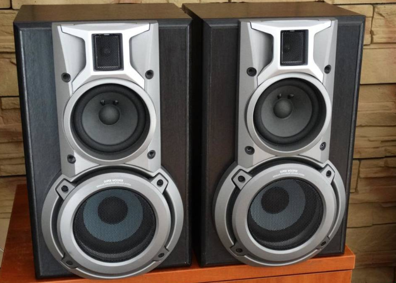

These are the speakers from the boombox of the same #? If so you may be spending money where not wise. They might be good for the workshop but you might find them not suitable for the living room. Maybe hang a coil on the lower woofer to prevent too much midrange.
Yes these are the speakers i'm talking about. Do you think they are worse than common 2.1 speaker systems that can be found at any electronics shop? if not, they'll cost less and i'll be learning stuff from diy.

The 70W on your speakers tells you nothing really. It might just be the total amount of power that they can absorb, before they start to smoke or smell badly.
Your speakers belong to an old complete stereo system, that was of modest quality, but you can ofcourse enjoy them anyway - fx in the garage or workshop, where they would fit great 🙂
