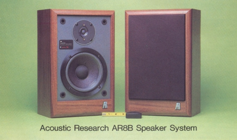

Hello All, I recently was gifted AR 8B bookshelf speakers. Of course the foam surrounds are dry rotted and I have the kit to refoam the woofers.
While I am doing that I got inspired to tweak the crossover thinking that i can improve the sound over the original. The woofer is running free-range with no LP filter. The tweeter uses a 5.0 uF capacitor only. Per what I posted below, it sounds like this was done as a cost-cutting effort and not necessarily to deliver the best sound. I'm thinking a 12 db per octave LP crossover at 2000 Hz is a good idea to prevent distortion. According to AR, the tweeter has an "effective" rolloff of 18 db at 2000 Hz using the single 5.0 uF cap. Should a more sophisticated HP filter be used incorporating an induction coil and a cap, and should the HP filter use a 12 db/octave slope as the tweeter was designed to have a natural rolloff giving an effective 18 db/octave slope? Or should the HP filter use a 3rd order filter? Please advise, the more I look into this the more I am getting confused! Thanks!
