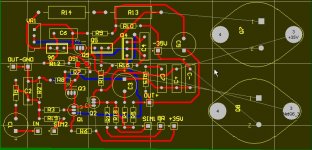

First off, having read some of the threads about ripping off copyrighted PCB designs, please rest assured that I did this PCB by myself using protel demo. Actually, I already bought a PCB from Rod and will probably buy a real P3A as I will need Rod's expert guidance while building the amp.
Nonetheless, since I really want to learn how to design my own PCBs eventually, it would help a lot if I can get your comments on what is wrong with this attempt of mine. I'm just using P3A as an example because I know many are familiar with it and it's not too complicated.
I used MJ2955 and 2N3055 as output transistors and will mount them on a heatsink and connect them directly with wires instead of copper traces.
Thanks for the help.

Putting a schematic scratch, and avoiding the brand title
Will be easier to help....
I was trying to see the possibility of output to input coupling...common when zobel filter is near the input.... also output magnetic field....i could not because no schematic at hand.
Of course i can find the schematic, but will be more easy to us, if already in place to use.
If you avoid the P3A name, we can be out of copyrigth problems too.....so, this way, when you put the brand on it...people will run of you to avoid problems.

To me, the layout looks overcomplicated. You can get a P3A onto a single sided PCB if you try hard enough. I would look at some more PCB layouts for other amplifiers, note how they are arranged, and follow accordingly.
I won't elaborate further because most people here get very annoyed at people asking for help making their own PCB's for Rod's designs, as he sells them and makes a living from them. I made my own merely because I wanted the experience of creating a PCB.

If you want to try something that may be an improvement, thus mooting the rip-off arguments and further relieving your concience, arrange the VBE multiplyer so it can be mounted on the sink very close to one of the output devices. Should keep the bias closer to optimum as the operating temp changes.
Previous comments about keeping output circuits such as the zobel far, far away from the input is good advice. I had to learn this for myself. Very irritating experience.
Maybe use wider tracks to reduce impedances.
