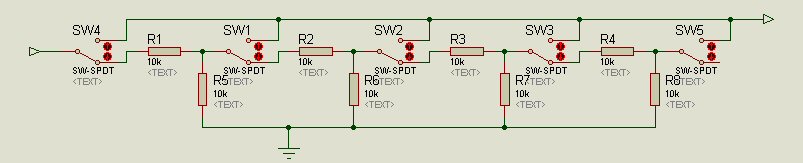

well -6db is half the voltage so 2 equal value resistors in series, one end is input the other end is ground and the middle is 6db down.
then if you split the bottomn resistor in equal values again and take the signal from that point it will be half again or 12db down, continue to get -18db and -24 db.
remember -6db is half voltage, -12db is quater -18 is 1/8th and -24 is 1/16th
so if the botomn resistor is 1ohm what are the rest?
Or build four 6 dB attenuators in series. Of course, they'd all be loading one another... Tricky business. I think T networks are commonly used for this - at least in the RF world.
Multisync's idea is the one commonly used for audio. It's essentially a crude potentiometer - or voltage divider.

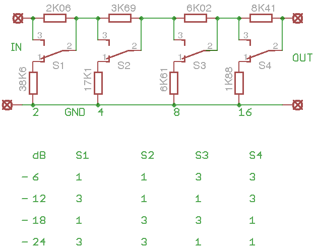

For instance, you can design 6, 12, and 24dB L-attenuators between 50k and 50k. You can now switch them into and out of circuit (using a DPDT switch per stage) to give 0, 6, 12, 18, 24, 30, 36 and 42 dB attenuation (using a binary switching pattern) and both source and load will see 50k looking into the attenuator (or looking into each other) regardless. Each DPDT switch is wired to switch in an attenuator or a short. Make the source and load impedances different and the whole thing falls apart. It may well be possible to design a complicated arrangement of switches and resistors to achieve the desired result, but each pad must be modified in the switching to change its output impedance to be identical to its input impedance and this will change its attenuation which much again be corrected for.
If the source and load impedances are different you need to design 7 different T- or pi- pads (to match the range given above) and switch just one into circuit. Or modify the source or load impedance (or both) with a series or parallel resistor to make them identical (and accept any losses) and match the attenuator to this.

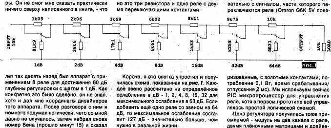

The attenuator circuit has input and output impedances 10K. It works fine in between my
cd-player (Marantz cd5003) and my amp which I built using LM3886. Each stage
has matched impedance with the previous and the next stage. This is the reason
why it has got the unusual resistor values. Actually it is part of the attached more
advanced attenuator.

The attenuator circuit has input and output impedances 10K...........
No.
The diagram is showing that when the output is loaded with 10k that the input impedance seen by the source is also 10k.
If the load were changed from the suggested 10k then the input impedance would no longer be consistently 10k.
But when looked at from the receiver end, the output impedance of this attenuator is NOT 10k.
Set Rs for the source to 200r. Set all the relays to 0dB. The load is still 10k. But looking back from the load to the output of the attenuator, the receiver sees a source impedance of 200r. The load sees Rs when set to 0dB.
Be careful.
To get the benefit of balanced impedance connections, the impedances matches MUST be VERY accurate. You must aim for much better than 1%. Usually 0.1% is accepted as the maximum tolerance, but benefits are to be found by achieving <0.01%.
It would be worth looking at typical switch resistances and how they vary, to see what effect, if any, these inconsistent resistances would have on the precision of your very accurately matched resistances and capacitances.
This matching requirement will make it costly if low tolerance resistors are used. The audio source, if it is not a fully differential design, can be modded to accomodate a unipolar volume of your choice. This will give better results to maintain the CMRR of the setup.

Not really... the original poster has an unbalanced source (which could start a whole different discussion) I like the russian design, though it really doesn't quite accomplish what it says it does. (just did the spreadsheet with combinatorial attenuation characteristics, using the Thévenin equivalent resistance and attenuated source voltage as the feed...) But its in the right direction.
With only 4 switches ... The resistor matrix would be much simpler, as only ONE switch at a time could be selected for attenuation.

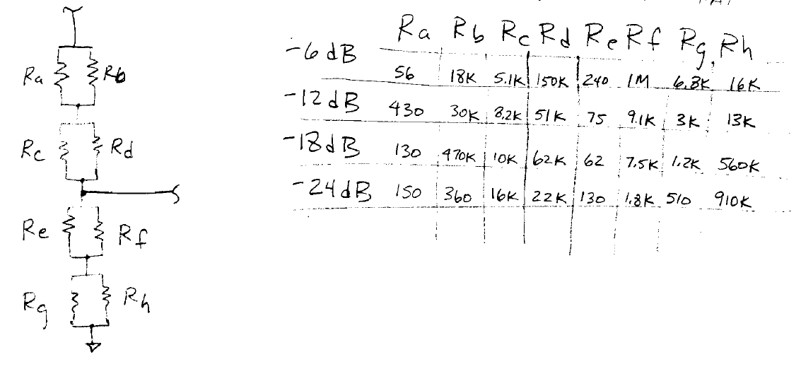

OP: the formula you're looking for starts here:
dB = 20 log10( ratio ) therefore ratio = 10 ^ (dB/20)
You wanted ... 6, 12, 18, 24 db
The ratios would be 0.501, 0.251, 0.126 and 0.063 respectively
These in turn correspond to the following resistor pairs (to "kind of" match the 10K sink)
1K:1K -6 dB
1K:335R -12 dB
1K:144R -18 dB
1K:67R -24 db
Even figuring the 10K load into it (which will reduce output a bit more), the worst case is the -6 dB case, which becomes -6.4 dB... hardly worth worrying about. Its not as if you're building a precision instrumentation pad. You're building an attenuator for your CD player!
