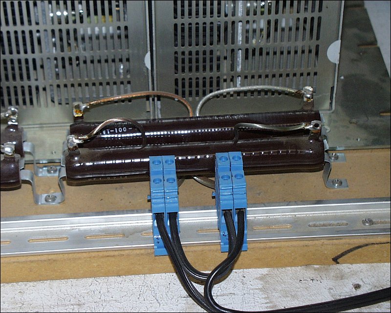

The next time you order parts, buy a 2 ohm 100w resistor like the one shown below to use as a limiter. If you buy 2, you can use them in series for a 4 ohm dummy load. Fan cooling from the end (through the hollow core) will significantly increase their power handling.
