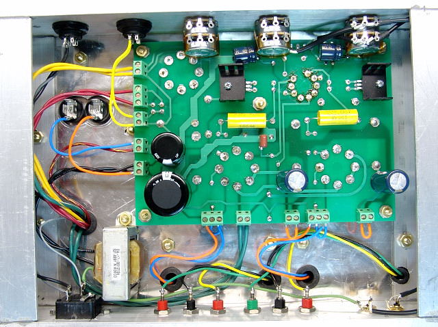

1)Mount two sets of dual banana jacks on the back and wire the common connections together and connect it to the common (0 ohm) wire on the OPT. Connect the 4 ohm wire on the OPT to the hot terminal on the 4 ohm jack and the 8 ohm wire on the OPT to the hot terminal on the 8 ohm jack set.
2)If using individual banana jacks you can mount the common one (I used black) in the center of three jacks, with one jack on one side for the 4 ohm output, and another on the opposite side for the 8 ohm output. When plugging in speakers you use the common black jack with one of the other jacks for 4 or 8 ohms.
Here is the under chassis picture of my old SSE. The chassis is far too small but I had very limited space in my Florida house. I was going to use red for the 4 ohm jack, and green for the 8 ohm jack, but only had one green jack.

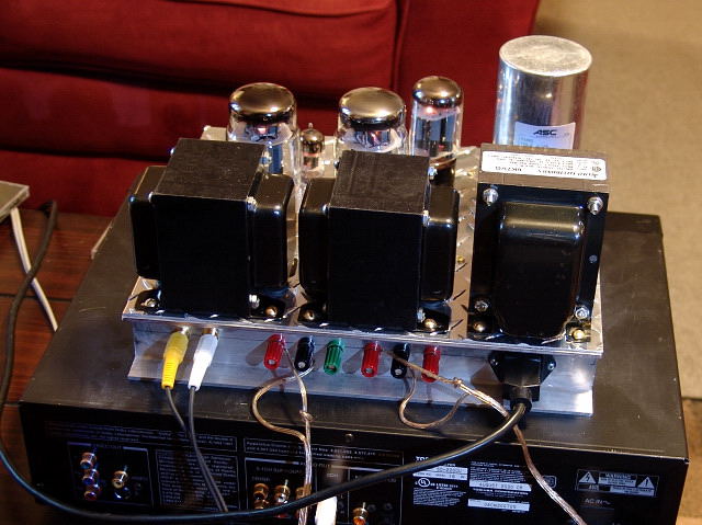

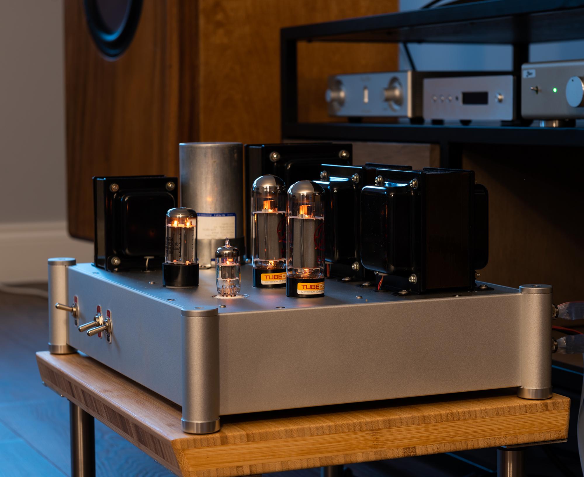

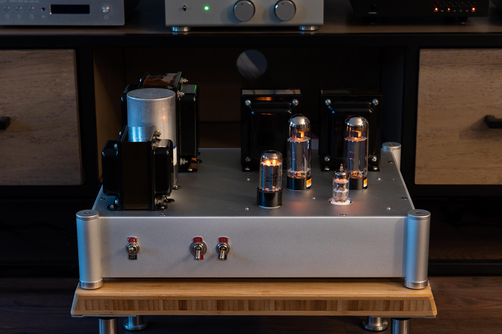

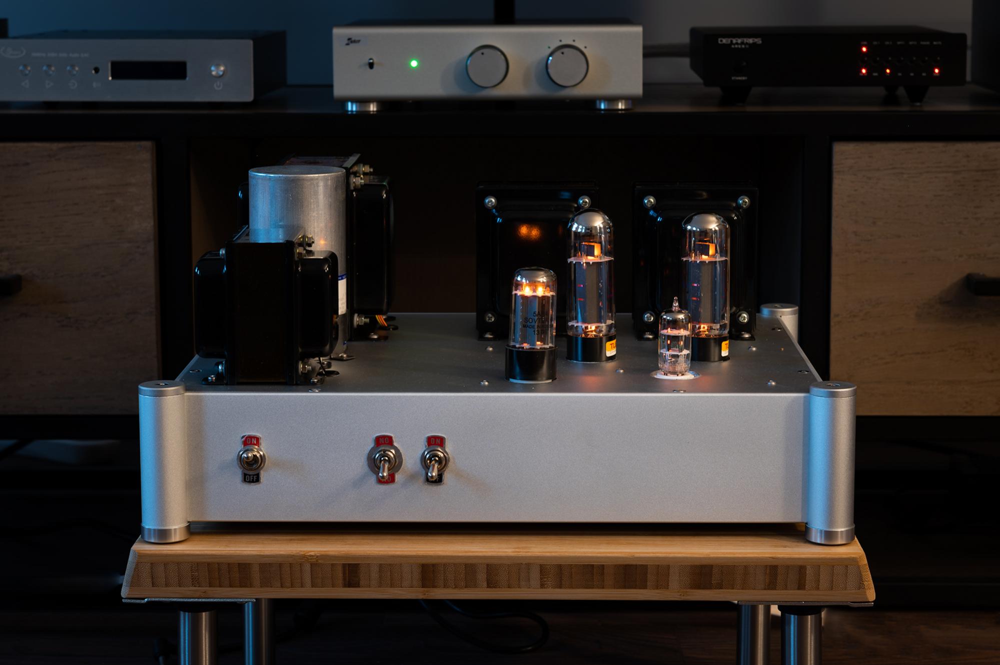

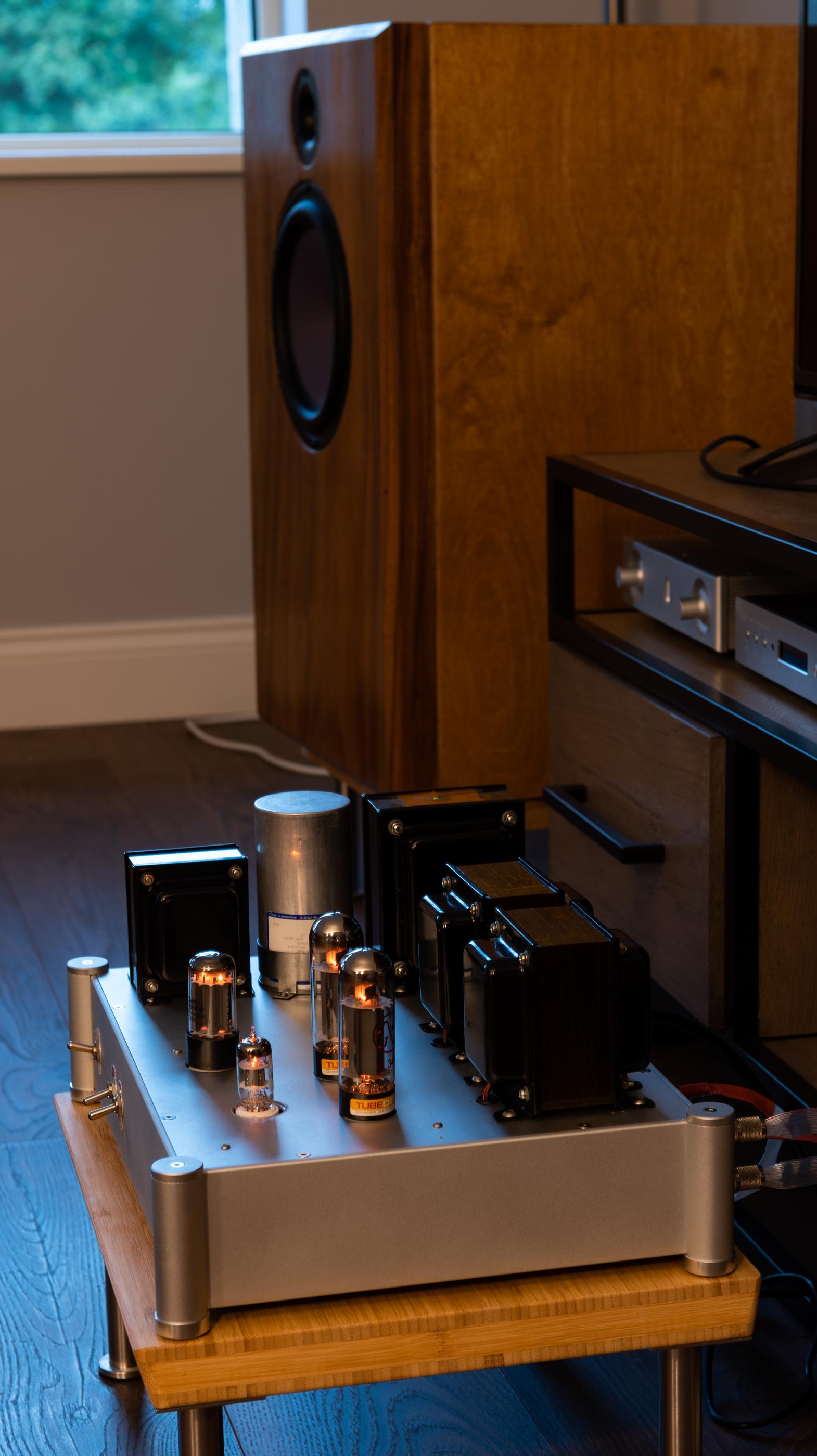

update; my Tubelab SSE project is alive!
Right now it is in basic triode connection without feedback, it has been playing flawlessly from first power up and the past couple of days.
thanks for all your help here, i appreciate it.
