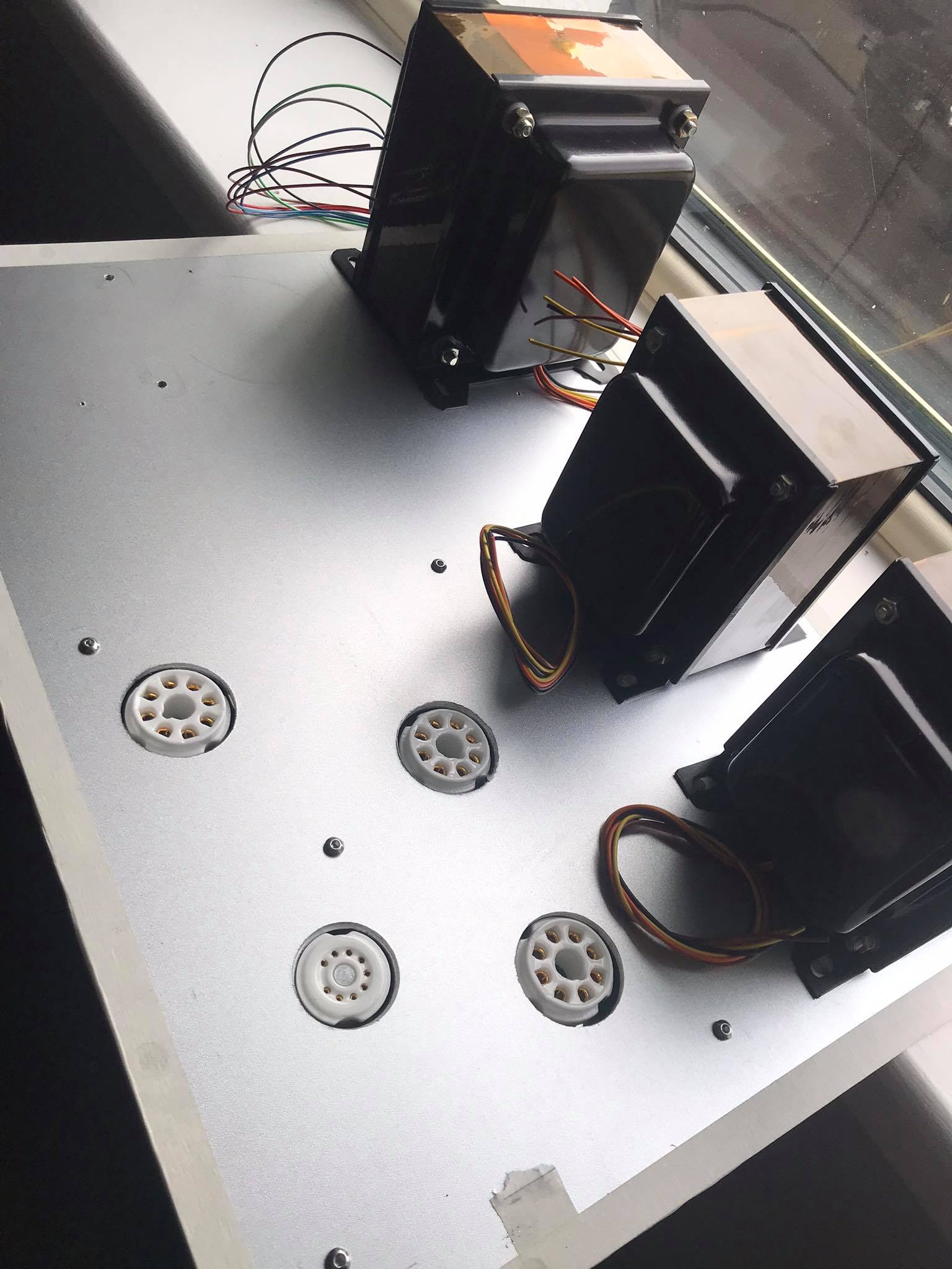

Second question is about layout, attached is the photo of my mock up. the silver plate is the actual top plate of the chassis. Pls let me know if this is ok or if I need to move anything.

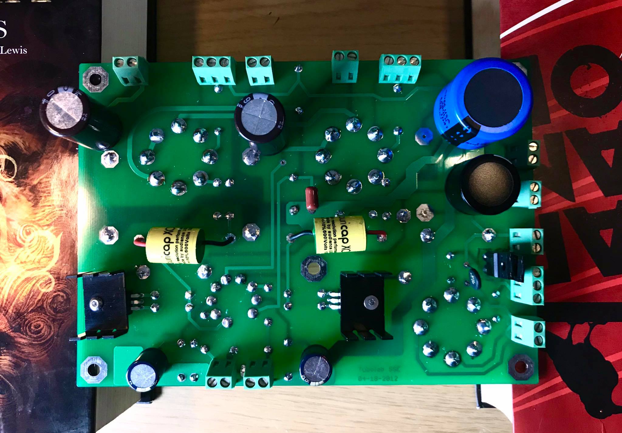

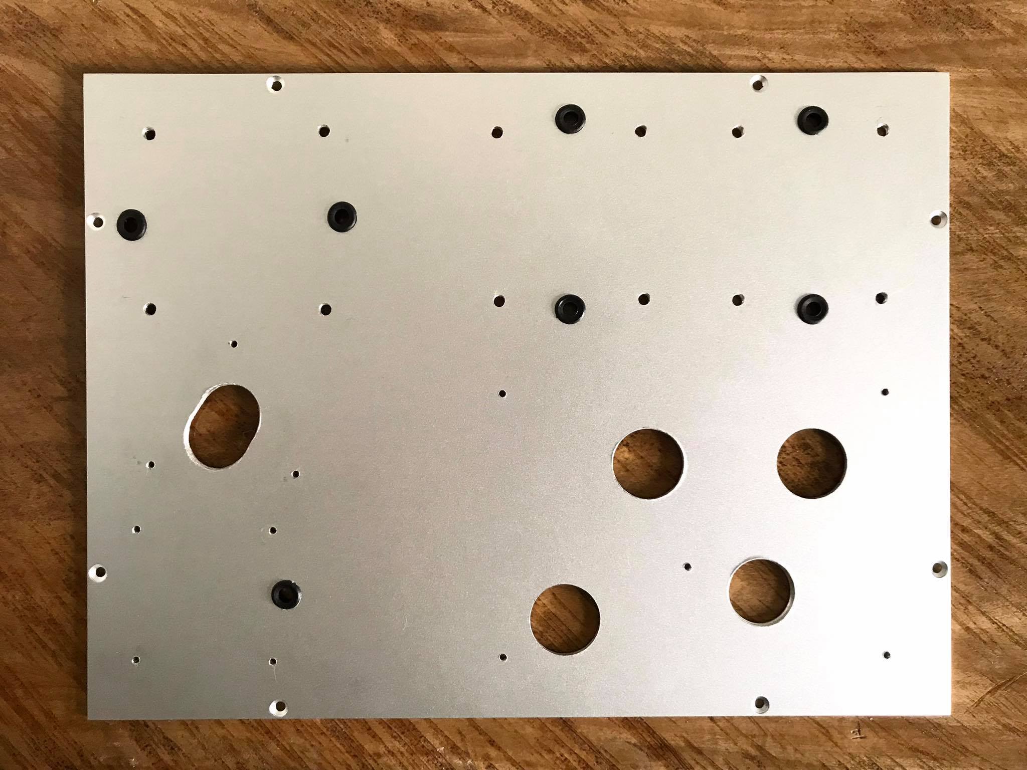

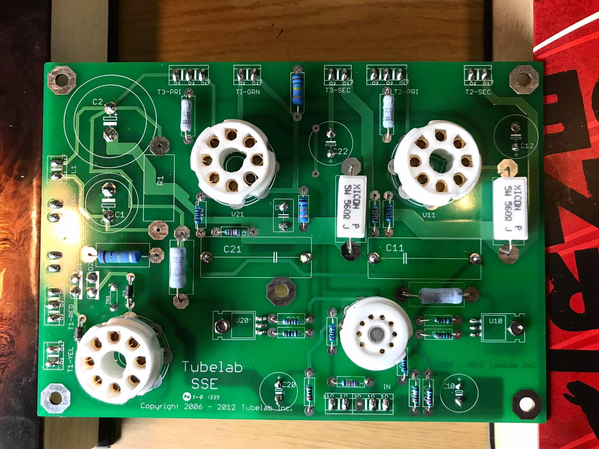

build is coming along slowly, here are some photos:

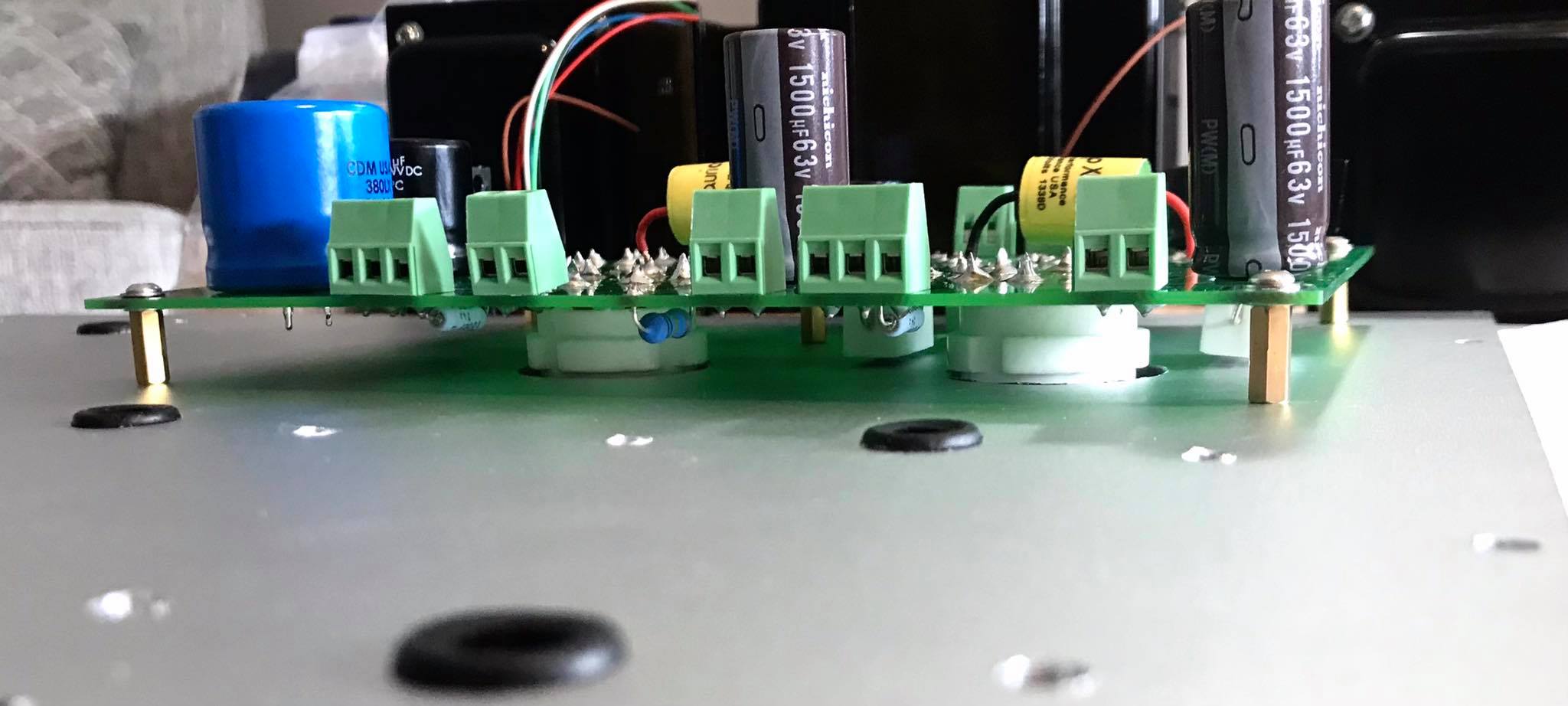

board is done. mounted it on the top plate.
