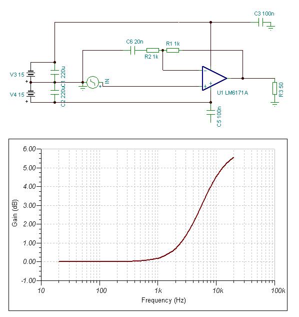

Hey Guys,
I've been trying to design a simple, linear, active, second order low shelf filter with around 6dB attenuation without much success. Research on the web has proved a massive time consumer without luck.
The design of the low frequency shelf cut specs are around 5-6dB between shelves and a 1kHz corner. Needs to have low phase shift, and low group delay variation and have low noise & THD.
I've got a high pass shelf working based on Linkwitz Shelving Filter, but I need a low shelf cut.

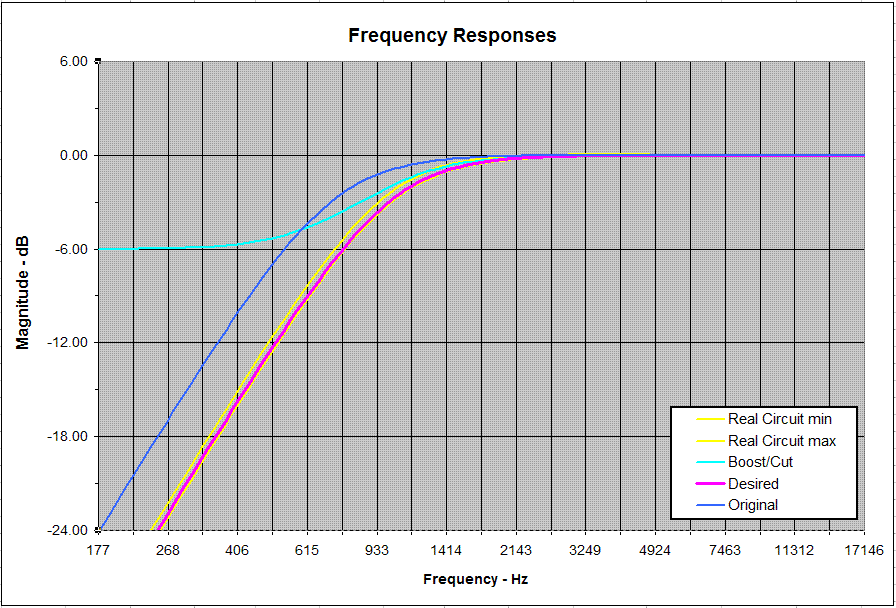

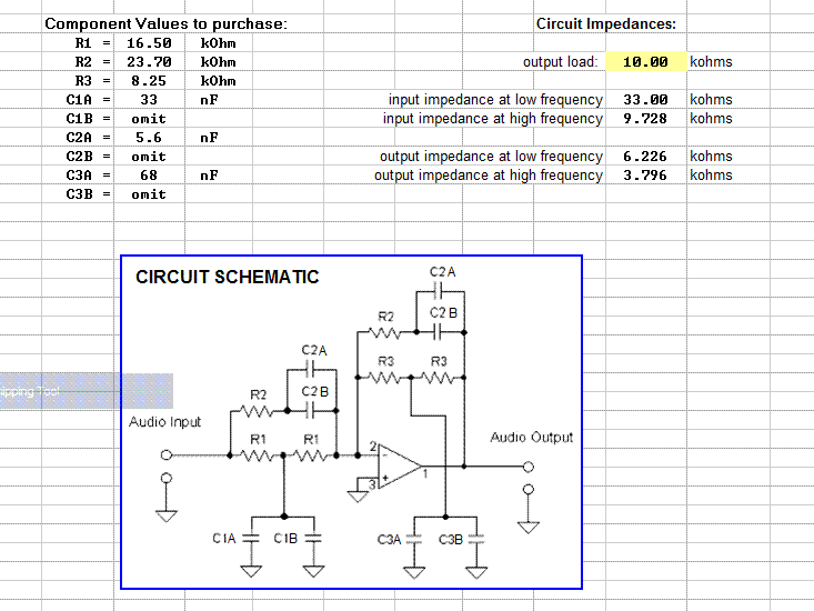

See if the attached circuit works for you...
You can design this yourself, using the LT designer I wrote:
CFL Linkwitz Transform Designer with Monte Carlo Sensitivity Analysis
There are other ways to make the second order shelving filter. You have to implement a biquadratic filter, and you can do that using various "biquad" circuit topologies.
As others have said, phase shift and group delay are a direct consequence of the frequency response and are independent of which circuit you choose. The distortion is dependent on what amplifier (op amp) you use and the resistances in the circuit, etc. and is something that you can tweak.
-Charlie

I've tried the Linkwitz Transform circuit and yes, it works quite well for the response curve. Nice spreadsheet CharlieLaub. Very interesting and looked like some work to put together.
! However ! Regarding the Linkwitz Transform:
- There are too many components in the signal path
- It inverts the signal
- Lots of noise & distortion added by the network
Is there a simpler, cleaner way? Similar to the high pass circuit I posted? Even if it is 1st order.
Yes. Non-inverting opamp, with CR in parallel in the feedback arm and R to ground from the inverting input. Make sure the opamp is unity-gain stable. Unity gain at high frequencies; gain set by resistors at low frequencies, rolloff set by C (in conjunction with R's). Should be in any decent electronics textbook, or Google.
