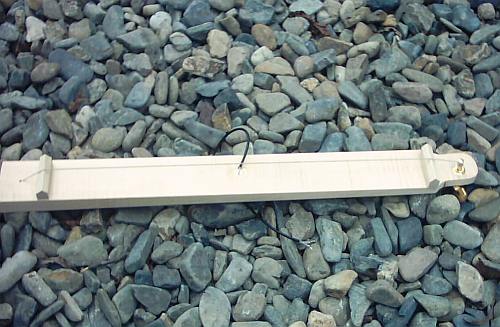

I build instruments together with Gerald in the same workshop before he really started his own business. Thats ... years ago. I made some bass guitars and guitars that time, if i will find some time i will post pictures. I never managed to do this work for a business, to much other things happened inbetween and also i´m involved in woodworking still i make other things now. i don´t know if the harshness is really from the piezo - and i´m not so sure if the transducer itself is the main part responsible for sound quality. In the instruments we have low power circuits for preamplification, and my impression always was these circuits have shortcomings alone from the fact they are made from low power opamps. How good they are adapted to piezos ... Another thing with influence on the sound is the connection between piezo and wood, and the place. A few mm may change a lot - a lot of coincidence involved here.
I never really seriosly did play these instruments, and also i would still be very interested in building and experimenting this does not happen because i´m not into the musician scenen.
For the sweet spot of pick up placement i don´t think it exists. The sound is different, more full to the middle and bright and more overtone to the end of the string. But this does not mean one place is really the best. I think mostly they are placed were is enough space and it looks good - and a lot of myth is spread around for marketing reasons. You may find a place that is really not good, but this happens incidently same as acoustiv instruments may have a fundamental resonance by accident. An old instrument builder i knew had this, he build string instruments and one of a series of identical had a bad resonance ("Wolf"), so he descided not to sell the instrument but hide it away on his attic...

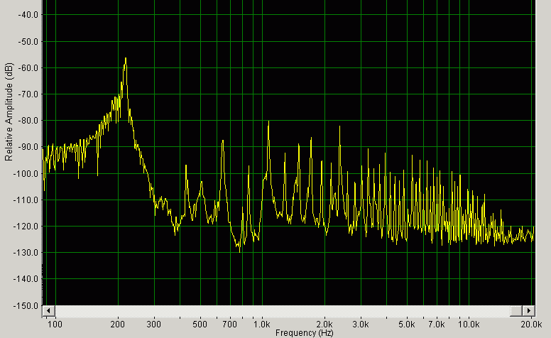

i went over to the workshop - build a piezo monocord. Piezo is from an old cheap piezo tweeter . At the scope i can make something that looks pretty like a sine. With the scope 10MOhm in get up to +-5Vpeak! i don´t know what input impedance opamps they use for the preamp inside the instruments, but high impedance with 9V block batterie may be a reason for bad sound.
Hi Till,
Thank you for sharing your experiment and it's results.
I had the same impression regarding the true reasons of a piezo's harshness.I remember the first generations of Ovation guitars fitted with piezo transducers (...apart from the initial spectacularity,on a second listen,they showed THAT caracter),and things being somewhat improved on the later versions.
Do you have an idea on how to build a "harsh-free" on-board piezo preamp for our beloved instruments?
...Maybe a hint?...Anything?
Thanks,
I think for a better in - instrument preamp the problem is we would need more voltage. Batterie power and low power design may be not the best way. An external powersupply providing real voltage and the opportunity to build something with discrets or opamps at +-18V and some more bias would be my way. I also wonder why mostly dynamik PUs and sometimes piezos are used, but i don´t know any case of build into instrument micophone capsule. I woudl really like to experiment with these, but i would need an instrumentalist for the testing and valuation.
