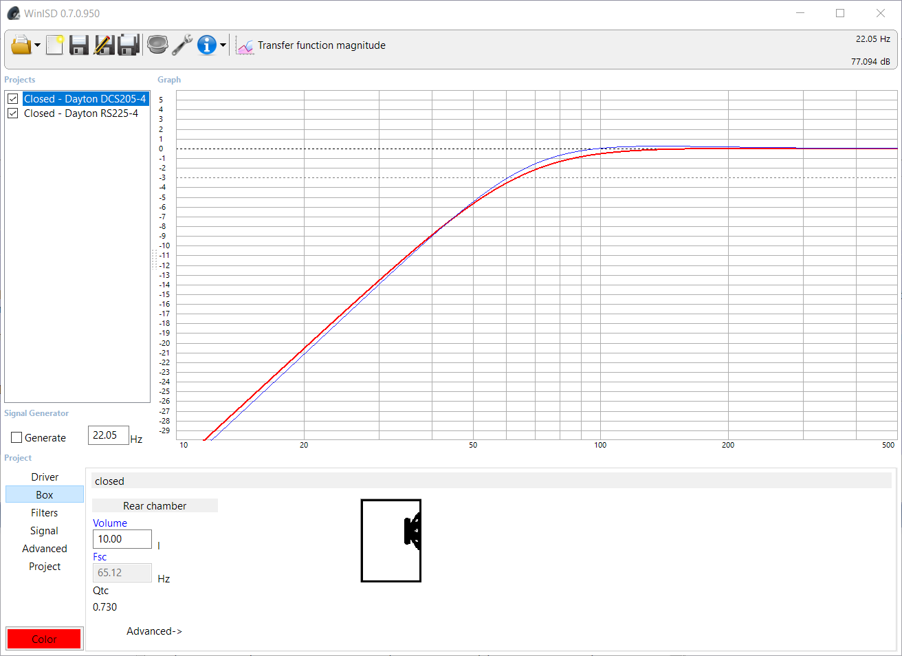

We played again with a few drivers with closed designs and the Dayton RS225-4 and DCS205-4 produced good results with our desired and existing MDF box (see attached graph).

GM
Joined 2003
Greets!
??? I'm saying nothing about the driver, only the differences of the box alignments.
Technically, the blue curve has the lowest distortion, hence the best sound quality [SQ], but as you can see the trade-off is it has the least bass until down really low where there's only the low B pipe organ [16 Hz] and LFE special effects, so not much of a woofer unless in a solid/massive room corner plus a bit of EQ to just get a minor bit 'rumble' since it's a tiny sub and so many dBs down.
The green curve has second best SQ, more [mid] bass, but more distortion.
Obviously then, the orange curve has the most distortion, gain bandwidth [BW].
That said, vented alignments are the most used in most apps, so its distortion is considered acceptable by most and at a relatively minor loss of deep [rolled off] bass, its distortion can be lowered down almost to the green curve's by critically damping the vent or just adding some minor internal stuffing between the driver/vent, so by far the most common variant.
But the room's acoustics dominates how it will perform in room, hence my first response. Best overall is to go with damped 'orange' and use DSP to time delay [TD] and frequency shape [EQ] it in room where it and you sit.
