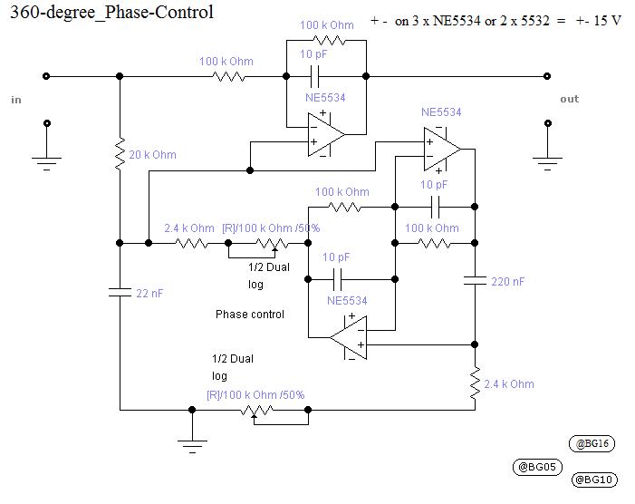

does any one have an idea where to find some kit for subwoofer which have controls for phase (beside frequency and volume) ?
I have search ebay but could not find any...
there are number of chines kit's with frequency cut of, and volume but non of them have phase controls.
The thing is that I have a sub inside coffe table and it's like 50cm from my siting place and the main speakers are like 200cm...
(have XXLS12 sub, 300W amp...but need some controls for subwoofer )
Hi, FYI:
b🙂
Thanks bjorno
this looks easy to build even via point to point 😀
Here is another implementation of a phase control circuit, with some additional references/links:

the project106 was the first thing that I found and was hopeing to find some pcb or kit based on it...but no luck...
the one that bjorno post is easyer to build than eliots...i hope 😀
the link that you post, to another theme on diyaudio is interesting but I can't see the final version of circuit...don't se last picture that Danne post...maybe it's an old tread and the link to picture doesn't work any more...
and I'm not EE so I can't figure values on my own 😀
I need something which is a final project 😀

Jea, sorry...it's my mistake, I wasn't clear enough what I nead...
I have it in my mind, but somehow messed up a question while posting...
