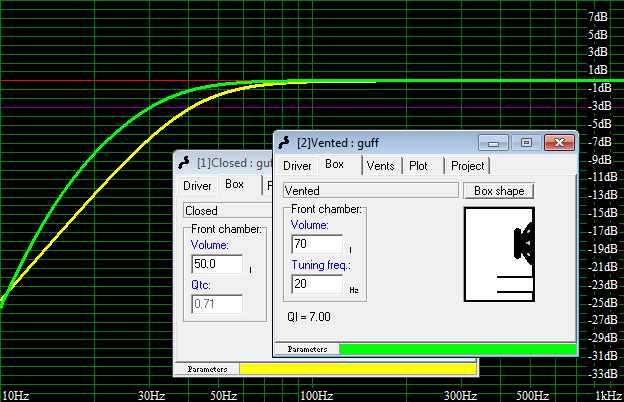

If your amp has a buily in bass boost option the LAB12 in compact
sealed box would work very well, if not a larger vented box is good.
-3dB @ 40Hz and 30Hz, - 6db @ 31Hz and 23Hz, -10dB @ 24 Hz and 18Hz.
The vented version has a lot more output capability very low down, and
you'd probably need it to be able to hear the very lowest bass notes.
rgds, sreten.
