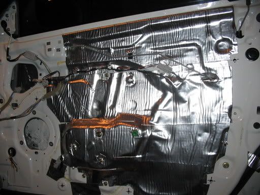

To best deaden the door, do this:
1. Apply 1-2 layers to the outer door skin (if you think of the door as a box, the "back" of the inside of the box).
2. Apply some closed cell foam behind the driver (Parts Express has some for a good price)
3. If your car door has a flimsy plastic sheet covering the inner door skin, tear it off and throw it away.
4. Apply 1-2 layers of deadening material to the inner door skin. Seal up as many holes as you can. You're trying to make the door act like a good IB enclosure, so you want to separate the rear wave from the front wave.
5. If your stock mid is mounted on a flimsy plastic baffle, get rid of it and build a MDF ring to mount the driver.

rammat is a very good option too, but it's sitll a little more than peel and seal. some people have issues with P&S's adhesive, but they don't use heat, or enough of it. I use a hair dryer to put mine on and don't have any problems. Either product will work though, and the guy that owns rammat is a great guy who stands behind his product
Hi.
I bought Peel n Seal today at Lowes. I also have enough Dynamat left over from my last car to do around the mids.
The peel n seal has aluminum over it like metal duct tape--so I'm hoping it won't smell bad in the summer. (It is a rubberized asphalt product).
I'm experimenting with an elastomeric roofing compound for the outer door skin. If it doesn't smell bad when cured I'll coat as much of the outer skin as I can reach. It's very thick, rubbery, and I can put it on with a trowel for a non-smooth finish.

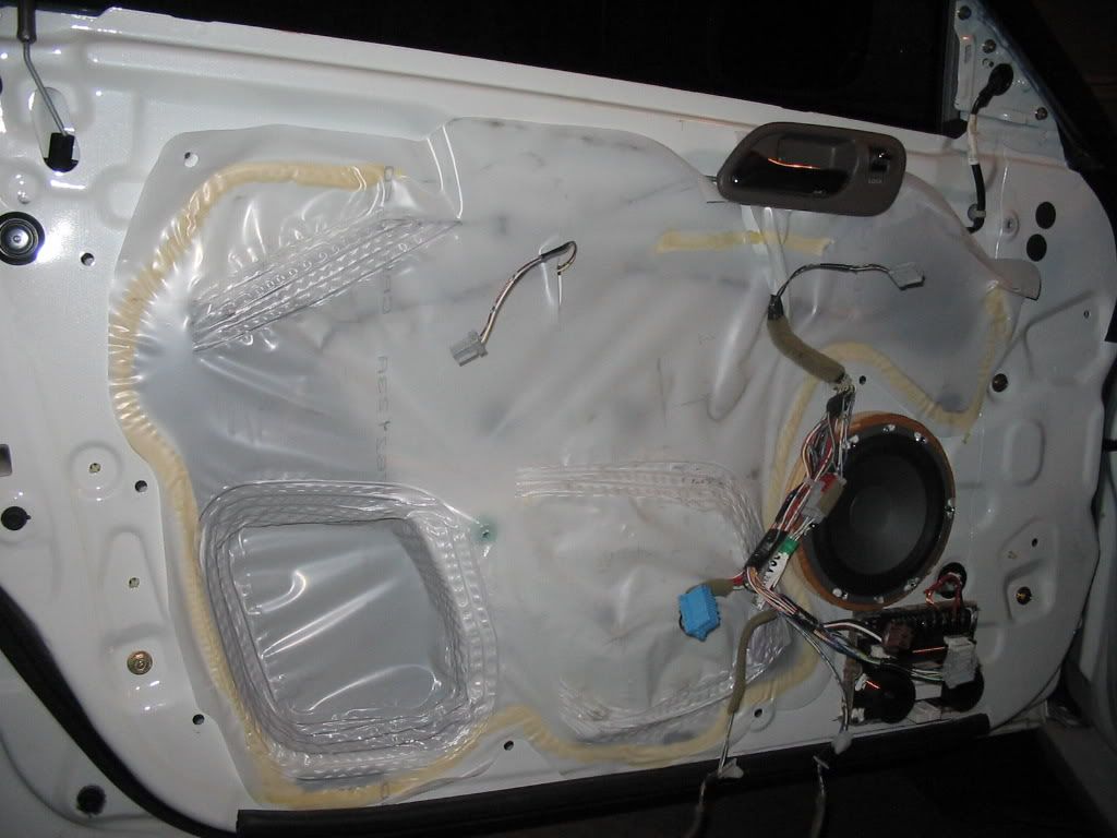

What do you mean by putting closed cell foam behind the speaker? I know what closed-cell means, but I'm trying to figure out where you mean I should place it.
Also, are you certain I should discard the plastic wrap? There's a big hole in the rear part of the door that I'm hesitant to cover with asphault. (The peel n seal would sag--i'd need something stiffer like dynamat or foam there. I do have some stout 3/4" closed cell foam available). For some reason, the door cover has a big plastic box that fits into the metal door with the open side of the box facing outward. I assume it's some kind of sound-dampening device--but I can't figure it out. I guess if I don't cover the giant hole I'll never truly get the rear waves away from the front waves though.

outer door skin
Roofing stuff isn't going to work. I haven't let it cure fully, but it smells so strongly of petroleum that I'd be nuts to put inside my doors.
I guess Dynamat make a spraycan for that specific purpose. (Coating inside of outer door skin). I think it's $20 per can, and one can cover 4 sf or something.
I'm almost done with the first door. Took me over two hours.
I put two strips of Peel N Seel (I'm gonna call it PnS) on the outer door skin, then covered most of the inner metal with it too.
I also used a trowel to apply silicone rubber caulk behind the area where the speaker will mount. I'm hoping to break up some of the sound reflections back there.
Funny thing: Acura put a small piece of PnS on the outer door skin when the car was manufactured! Was only a 4x8 inch piece, so I had to wonder, if it helps, why so little?
Here's a picture of my driver's door before starting:
http://img.photobucket.com/albums/v608/DerrickM/Door0001.jpg
Here's a picture of my passenger door nearly complete.
http://img.photobucket.com/albums/v608/DerrickM/Door0006.jpg
