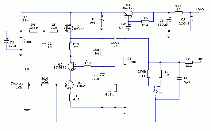

there is no so versatile DIY preamp around , marrying two things - wide range of possible gain (and output swing!) and painless switched gain ratio transition - without need to readjust output offset (or at least output node voltage potential)
my :Pumpkin: is more than capable regarding gain and swing but , as long I'm not implementing offset servo subcircuit , you can't simply switch feedback ratio - to change overall gain
... Instead of 3 separate preamp, is there any diy preamp design with variable gain?...
Sure, I'm testing the prototype now - the complete build with pics will follow.
The input is low-noise, high gm, current production JFET (BF862) cascoded with BJT (if you can remember, it's the "modulated cascode" from F3). This gain cell is loaded with BS170 made gyrator (basically it's a choke with no wire and no iron).
The current through this SE preamp is about 10-12mA, it's set by R4. The gain is set by R16/R10 (6 dB) or R11/R10 (23dB).
The preamp will swing at the output more than 20V_peak (more than needed to drive F4 to full power). Zin is roughly 10k and the Zout is less than 50R (R12 included) so it will drive successfully even F4 without its input buffer.
BC547C has max. Vce of 45V, the BC546B is better choice.
The BJT and BS170 should be equiped with small TO-92 heatsinks (or a piece of copper foil) - they reach about 70 degrees C. I tried different devices - 2sk2013 instead of BS170 is good but with doubled Id, and IRF610 is not good even on cascode duty.
Listening to this pre, it has that nice F3-like "velvety" quality, but with no "darkness" and no impotence - very lovable. Still testing the addition of LATFET SF for a complete amp...

- any reason why using high voltage supply? Am i correct that all component from +55 until C5 are regulator? What is the voltage on C5?
- instead of only gain 2 and 15 options, what about additional options such as gain 1, 2, 4, 6, 8,15. wouldn't it be nice?
That's impresive Juma, i cant wait for final version, pcb with transistor kit 😀
That won't happen, I don't have enough free time for such an enterprise...

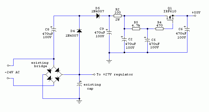

If you want enough output voltage to drive F4 to full power (40V peak-to-peak) it has to come from somewhere. Anyway, 55V is not high voltage - I got it from 2 x 12V AC transformer and voltage doubler...
Yes, Q4 and surrounding parts form a capacitance multipler.
About 53V.
Sure, you can do it with 6-position switch where each position will engage different resistor. But I wouldn't do that - it's only 6dB between positions and 6dB is just 2 clicks on the usual 24-position volume attenuator. So high gain/low gain switch makes most sense or you'll be using your volume attenuator in a very narrow range ...

.. I assume one would also want to select parts in the 12-15mA idss range?...
Almost all that I've got (500 pcs.) are in the 13-14mA Idss range so I guess it's to be expected. Anyway, the datashet says that maximal Idss for this part can reach 25mA. Practically, it's OK too, the only concern would be higher current consumption i.e. higher disspation in cascoding BJT and gyrator MOSFET. JFET's disspation will stay low because it's limited by low Vds (about 3.5-4V).

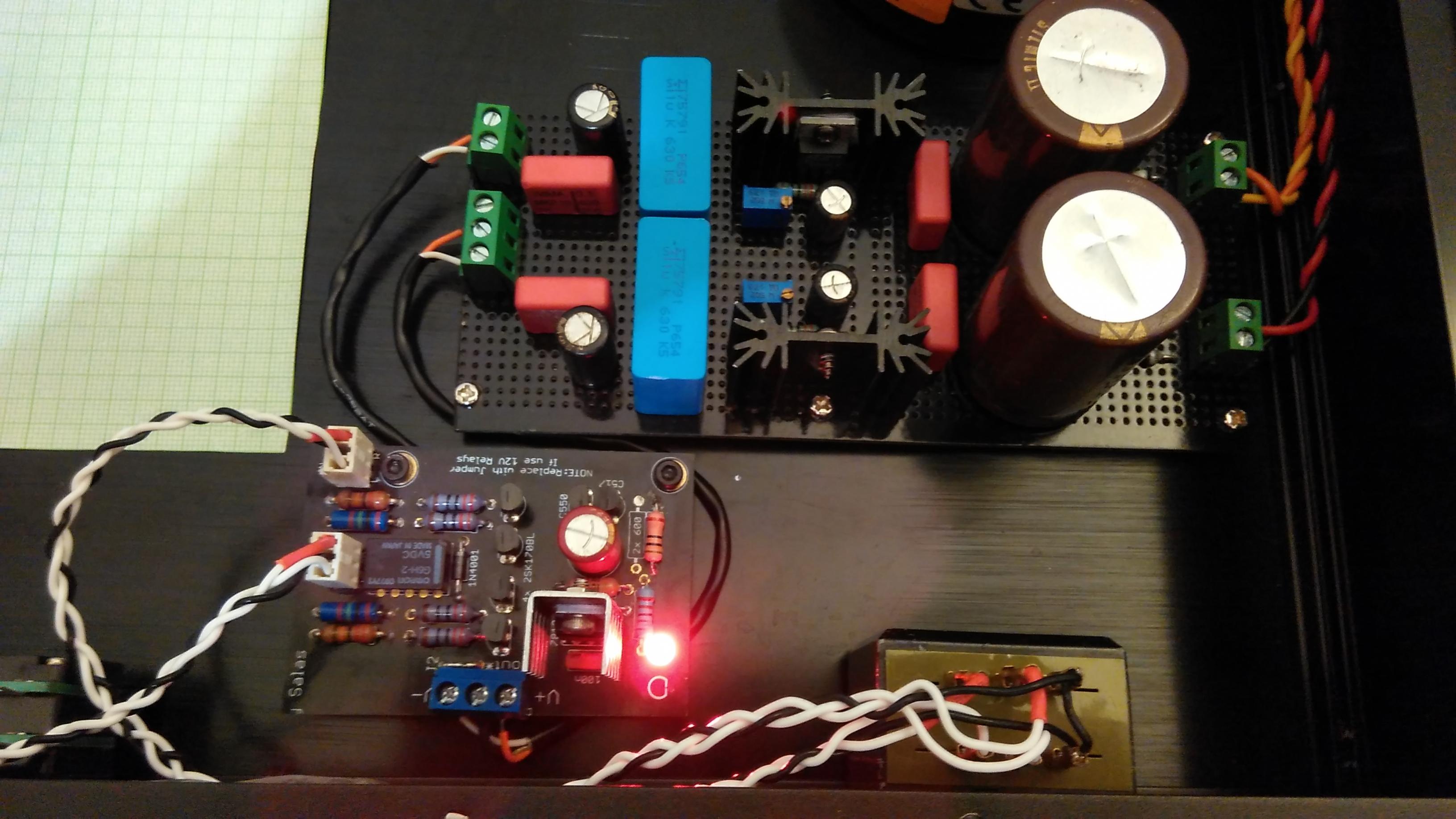

finally yesterday I finished my dfb1 using LT1084/1033 regulator, powered by 2x18V transformer. volltage out is set to 10.5V on both + and -. buffer board is still using teabag pcb but without salas shunt. i have prepared an area for ba3-fe or juma preamp pcb if extra gain needed someday.
configuration : qls qa550 -> ad1865 -> dcb1 -> gainclone mauro penasa -> 3way floorstand rated at 88dB 4ohm. they are placed on my bedroom 4mx3m
at this time i dont need extra gain from preamp. at night listening, potentiometer is set to 9 o'clock, measured 78dB on average and 82dB peak using android sound meter apps. while on daylight i can set to 11 o'clock position.
now my impression :
previously, i use my laptop out directly feed to gainclone and foobar equalizer is always configured on 'soft rock' and additional boost on first and last equalizer bar.
now with the new setup, i'm dissapointed that for all this time i rarely noticed between good and bad recording. most of my music collection (the corrs, mltr, celine dion, and other 90's pop music) sound terrible or maybe bad. I am just wondering why those major label dont make a good mastering just like audiophile record. I can smile now and enjoy good music eventhough they are downloaded from torrent 😀
Thanks to Papa for the great design 🙂 also for others like teabag,crt for the pcb, and juma for preamp idea.
Could you please tell , what modifications we may need to do here to increase the input impedance to around 500k or 1Mohms (without the 10k volume control potentiometer )?
thinking to use digital potentiometer, which expect to drive a very high input impedance stage.
...increase the input impedance to around 500k or 1Mohms (without the 10k volume control potentiometer )? ...
It can't be done with circuit from post #3 because (if you omit the volume pot) R10 sets the Zin and if you make it too high a bunch of problems will follow. Viable solution is to use the buffer (B1 or similar) in front of the preamp.
