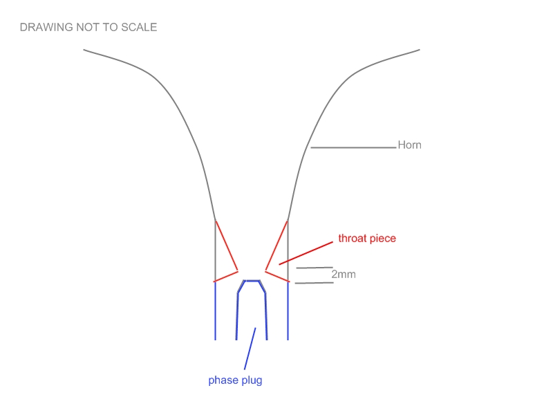

I've dismantled the device to check on the design (see attached picture) And I've found one thing which could certainly be the cause of some problems. The throat of the horn has a quite large (38mm wide, 45mm height) piece which is almost straight, this is the part which goes through the magnet of the LF driver. Then the real horn starts with a quite abrupt bent, all possible HOM generators.
My idea was to create (having it tooled from aluminium) a throatpiece which turns the original throat (black line) into the modified throat (red line), basically narrowing the throat entrance so it can expand to the horn flare.

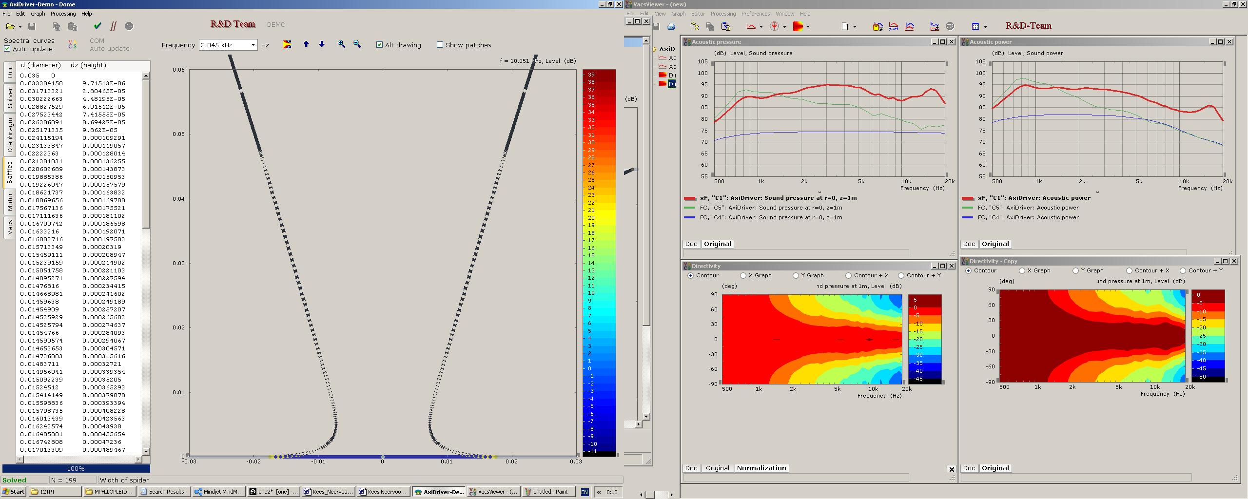

I have run some BEM simulations on this, as seen in the picture, and the results look quite promising, smoother FR, smoother off axis response and even higher output.
My question is: before I get the piece tooled, which will obviously cost some money, I would like to know if I am really missing something here and if it, for some reason is a very bad idea to do this. (compression, distortion, heat, diafragma destruction etc.)

Actually, the phase plug looks pretty complex (the HF is a coax driver itself), so I really wouldn't know what it exactly does and how to model this. The simulations I've made now are based on the assumption that there is a plane wave at the exit of the HF driver (the blue line in the picture).
By trial and error I have found that the current "throat plug" design gives the best results. This means that the center hole of the throatplug rises 2mm from the sides. I am aware of the fact that the very sharp corner which follows can create HOM etc. but when I simulate a rounder corner the results are worse.

Ahhh... a BMS unit. I see what you are saying.
What I am wondering is what the distance between the rear of the horn and the phase plug?
Do you have a jpeg of the disassembled unit?
You might find that a flat rear to the piece that you are making is not correct, depending on the geometry of the exit of phase plug...
But, if it ends up making that HF response flatter, then it is all good! 😀
_-_-bear
See the attached picture for a schematic drawing. The "throatpiece" won't be flat at the bottom, but will rise 2mm to the centre. This is empirically based on the BEM simulations I've run.

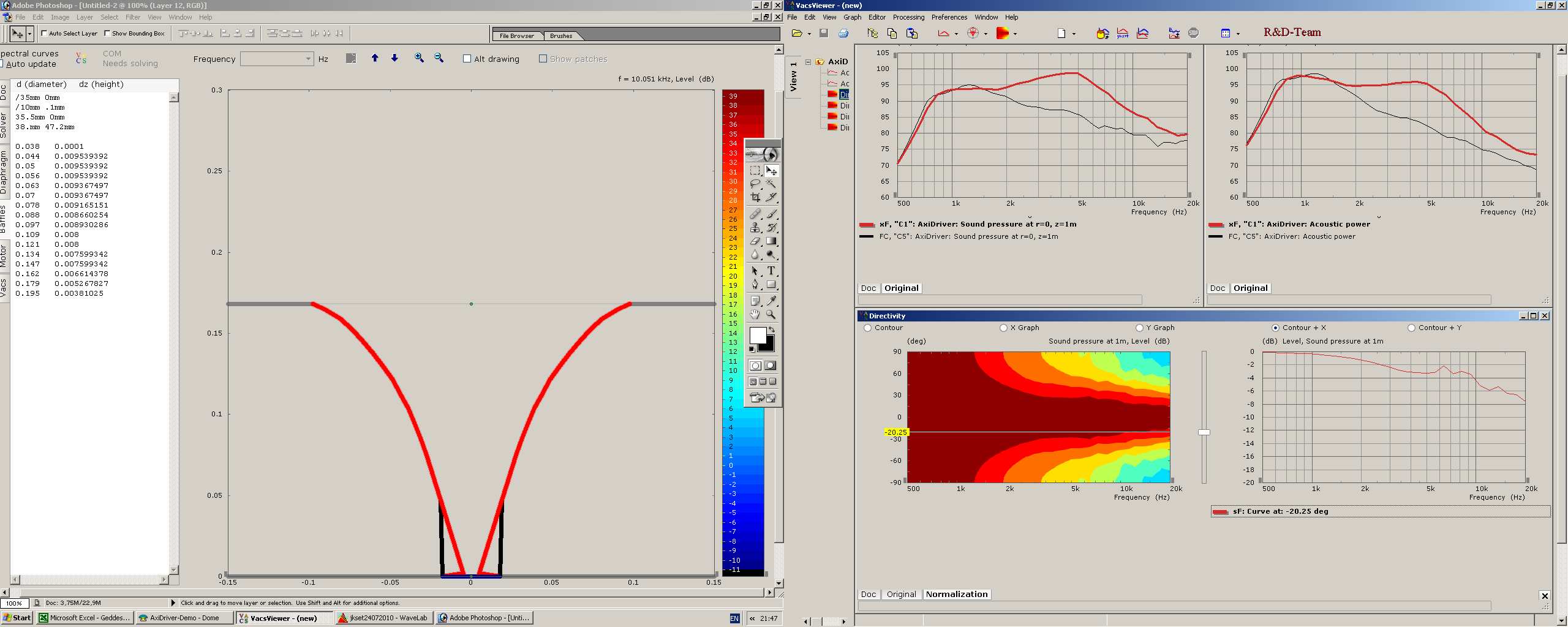

Kessito,
The throat piece as you have shown is likely to introduce substantial diffraction artifacts. I don't know what the actual geometry in there is, but the key is to make extremely smooth and clean transitions, and to have zero discontinuities in slope of the walls of the horn... of course maybe the drawing is just very crude and the actual piece will be ok. No way to know from here.
I don't exactly buy the explanation the Geddes applies here, but who knows, he is a PhD and I am not.
Please see the picture attached. I created the curve for the throatpiece with a 5th order bezier curve, giving me the possibillity to exactly match the horn angle and the dimensions.
If you look at the graph's, axidriver predicts that the horn with the throatpiece (red curve) will have more output above +-1,2kHz than the horn without the throatpiece (green curve). Below 1,2kHz the output suffers, which is fine because I'll be crossing it at 1,3kHz.
