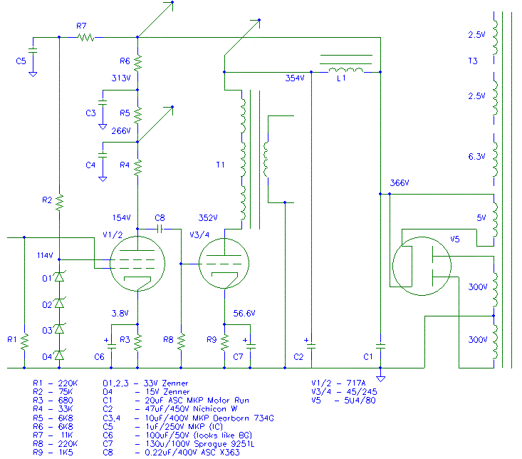

Hi nicoch46, yamamoto amp in your meaning is A08S that using #45 tube? If not do you have any circuit to sucggest?
