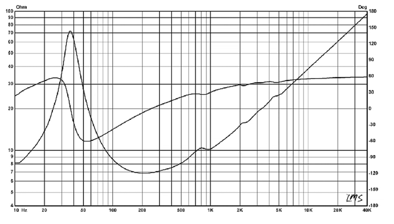

Okay, so my understanding of what you're saying is the means must match, this being the individually calculated means such as the ones below:
HiVi: 36 Hz Fs
35mm VC dia. = (34400/pi/3.5) = 3128.5 Hz
mean = (36*3128.5)^0.5 = 335.6 Hz
3FE22: 110 Hz Fs
3FE22 - 19mm = (34400/pi/1.9) = 5763 Hz
mean = (110*5763)^0.5 = 796.2 Hz a very poor match, so
I assume they don't need to match correctly, but be quite close?
But then you said
so the mean between the 1st two is .......
(335.6*796.2)^0.5 = 516.9 Hz
So I take it this mean is the crossover you'd use if you wanted to make the drivers work together
Sorry for the million questions, I'm just trying to make sure I understand correctly. I think the issue is me misunderstanding the terms you use and not knowing exactly the context you are using them for such as iterations.

Would the mean not be (Fs*2500)^0.5 = (62*2500)^0.5 = 393.7 - I believe this is how we calculated it earlier and that's how I've been calculating it this whole time.

I guess my question to you is, in your opinion, how different can the means actually be. Ideally I want the Midtweet to have the smallest diameter possible for improved dispersion up top, but the VCs get smaller once you step down from the 11 ranges. Here is some calculations using the VC Diameters I got from toutlehautparleur (so I can't say if they are 100% accurate):
Alpair 12pw - VC diameter 30mm, FS 38.4
34400/PI/VCD = 3649.9
2^4 = 228.1215517
Mean = 374.4
CHR 120
- VC diameter 30mm, FS 34.2
Basically the same as above. Mean = 353.3 instead
CHN110 - VC diameter 30mm, FS 44
Mean = 400.7
11ms
- VC diameter 30mm, FS 43.7
Mean = 399.3
The smaller drivers I'd consider are the Pluvia 7.2HD and the CHP90. The CHP90 has unknown VC diameter (I'm assuming around 25mm for my calculations) and I am confident the Pluvia 7.2HD is either 19mm or 20mm.
Pluvia 7.2HD - VC diameter 20mm, FS 72.5
34400/PI/VCD = 5474.91724
2^4 = 342.1823275
Mean = 630
CHP90
- VC Diameter 25mm, FS 48.5
2^4 = 342.1823275
Mean = 515.3
I am particularly interested in your opinion on mixing the CHP90 with the Alpair 12pw. Due to my lack of understanding, I've been going round in circles for days now so it would be good to hear what you think. I'm thinking of a 2nd order XO around 300-400hz (depends how much the parts for the XO will cost).

WRT 'how close', all you can do is what folks do using measurements, which in essence is finding the 'mean of the means', so (374.4*515.3)^0.5 = ~439.2 Hz/1st order.
For 2nd order 12pw: 38.4*2^2 = 153.6 Hz
(153.6*3649.9)^0.5 = 748.75 Hz mean
CHP90: 48.5*2^2 = 194 Hz
(194*5474.91724)^0.5 = 1030.6 Hz
(748.75*1030.6)^0.5 = 447.1 Hz/2nd order

Thanks GM. The maths checks out, based on your calculations.
I have the 12pw sitting here on the floor so I think I'll just finally use them. For some reason I keep trying to think of projects using other stuff. I'll build a ported box for them and then try active XOs for now to the Pluvia 7.2HD and the 3FE22 since I have all this stuff and it won't cost much to experiment. Just building the boxes for the 12pw and the 3FE22. The final goal would be moving to passive
