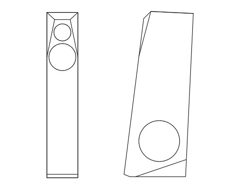

cabinet will not be anything complicated
just 19mm MDF with double on front
wide of something like 19cm
hight of 100cm
and depth of around 40cm
Cabinet for 16P mid bass will be around 18L (thinking about closed - but could always add port)
and for subwoofer XLS 10 around 20-25L closed
I think it will do the trick
now I have to collect some money to buy mdf and a pair of 16P 😉
will get back once I proceed with build 😉

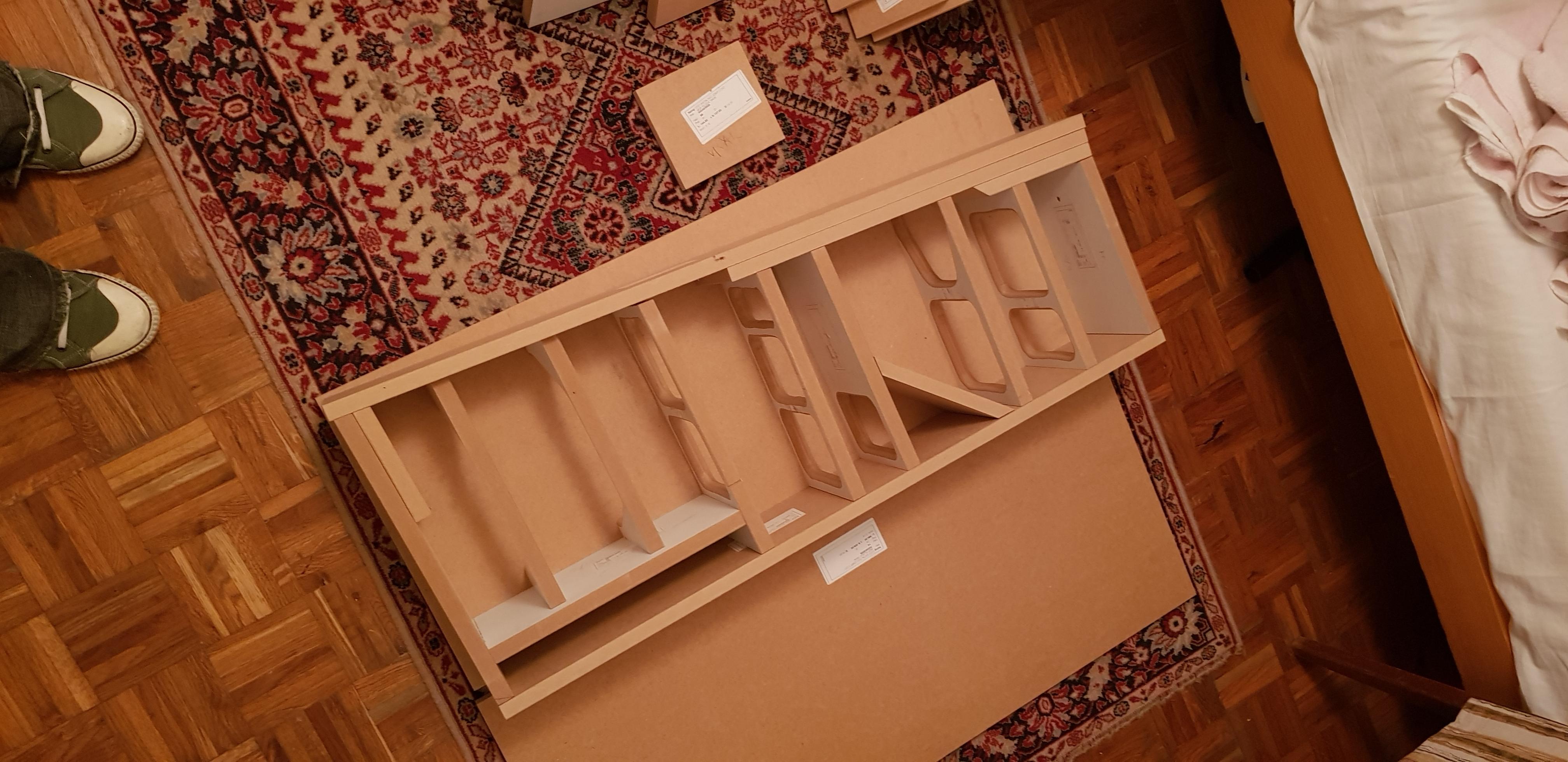

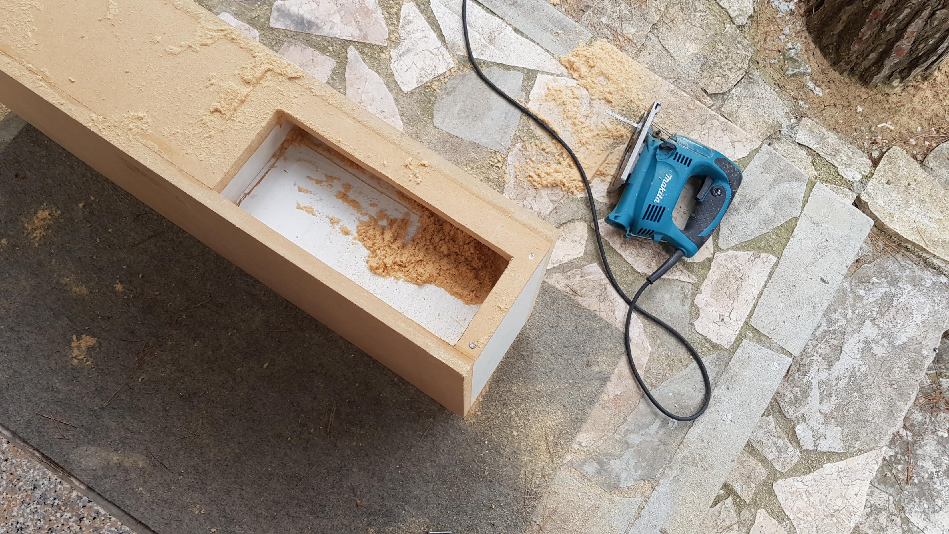

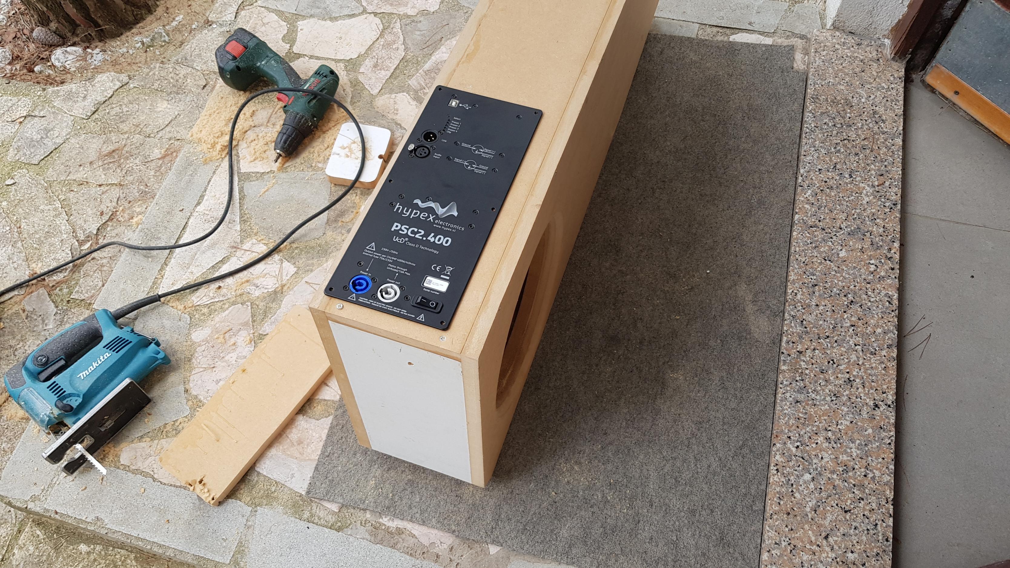

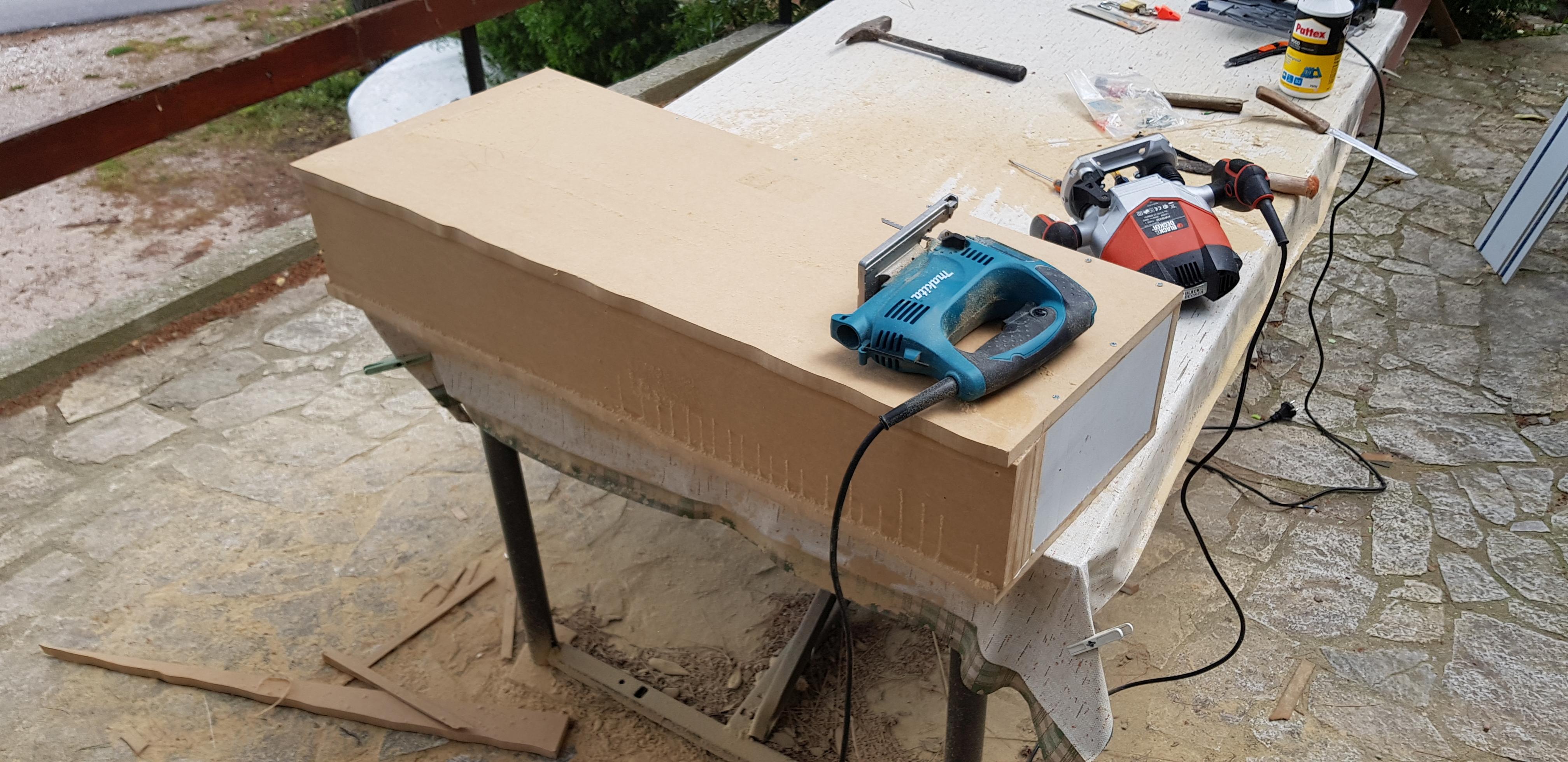

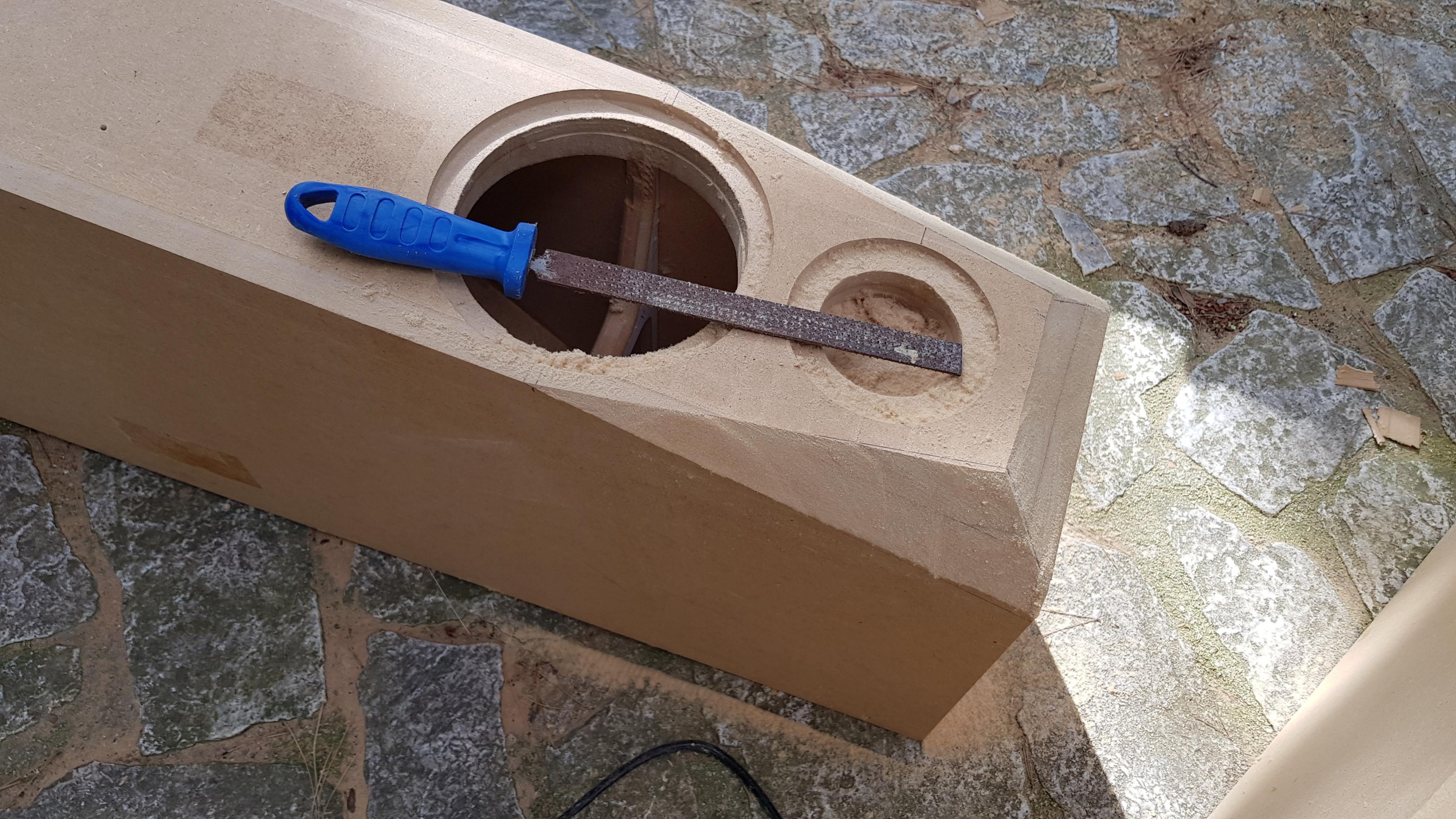

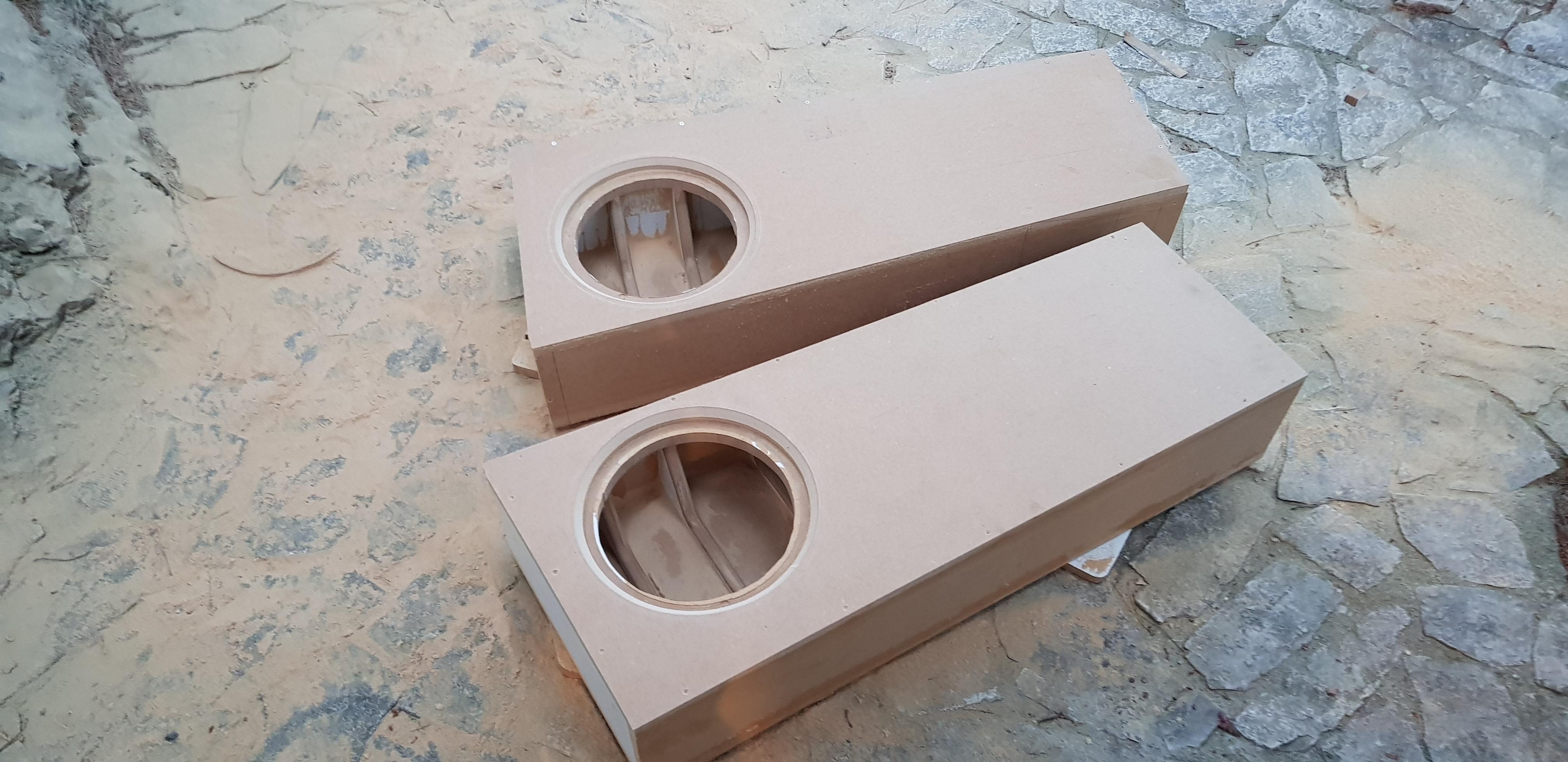

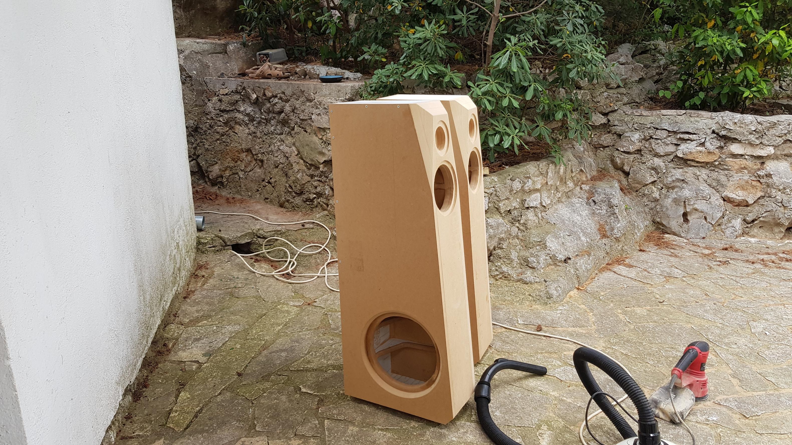

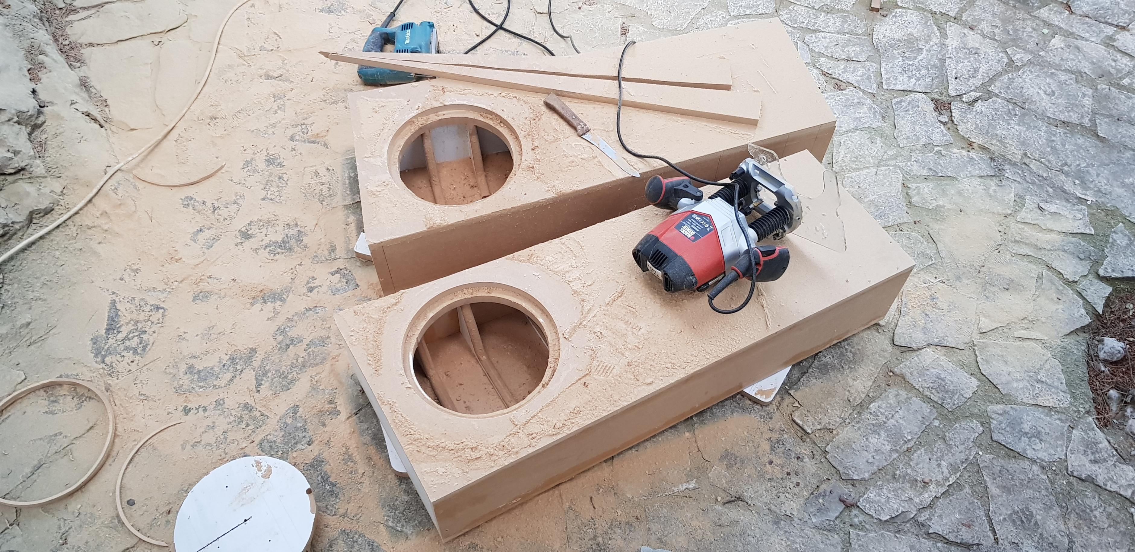

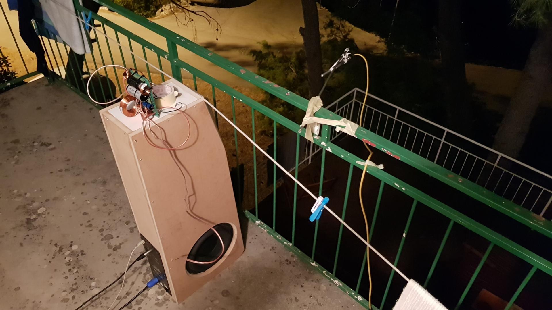

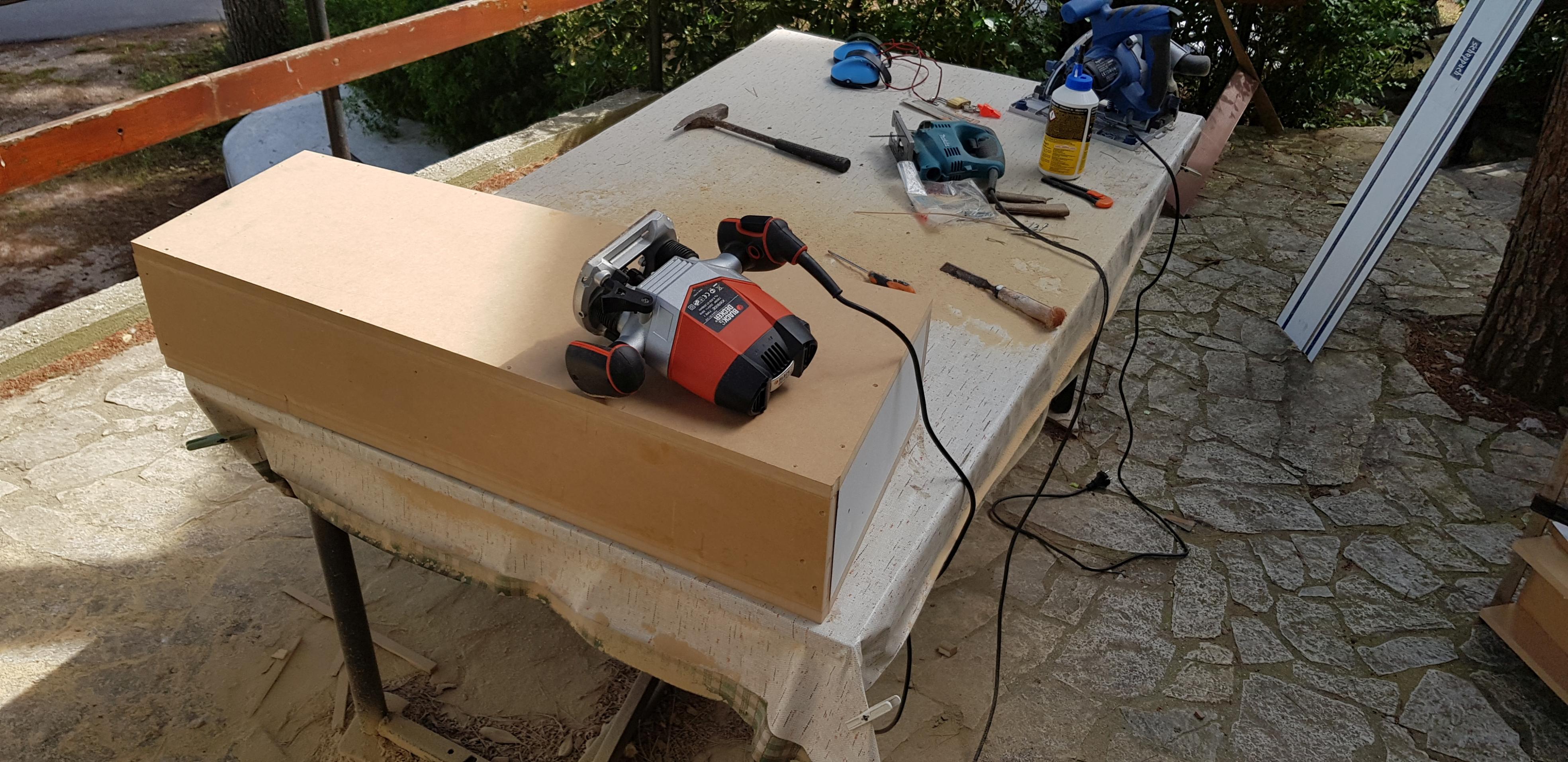

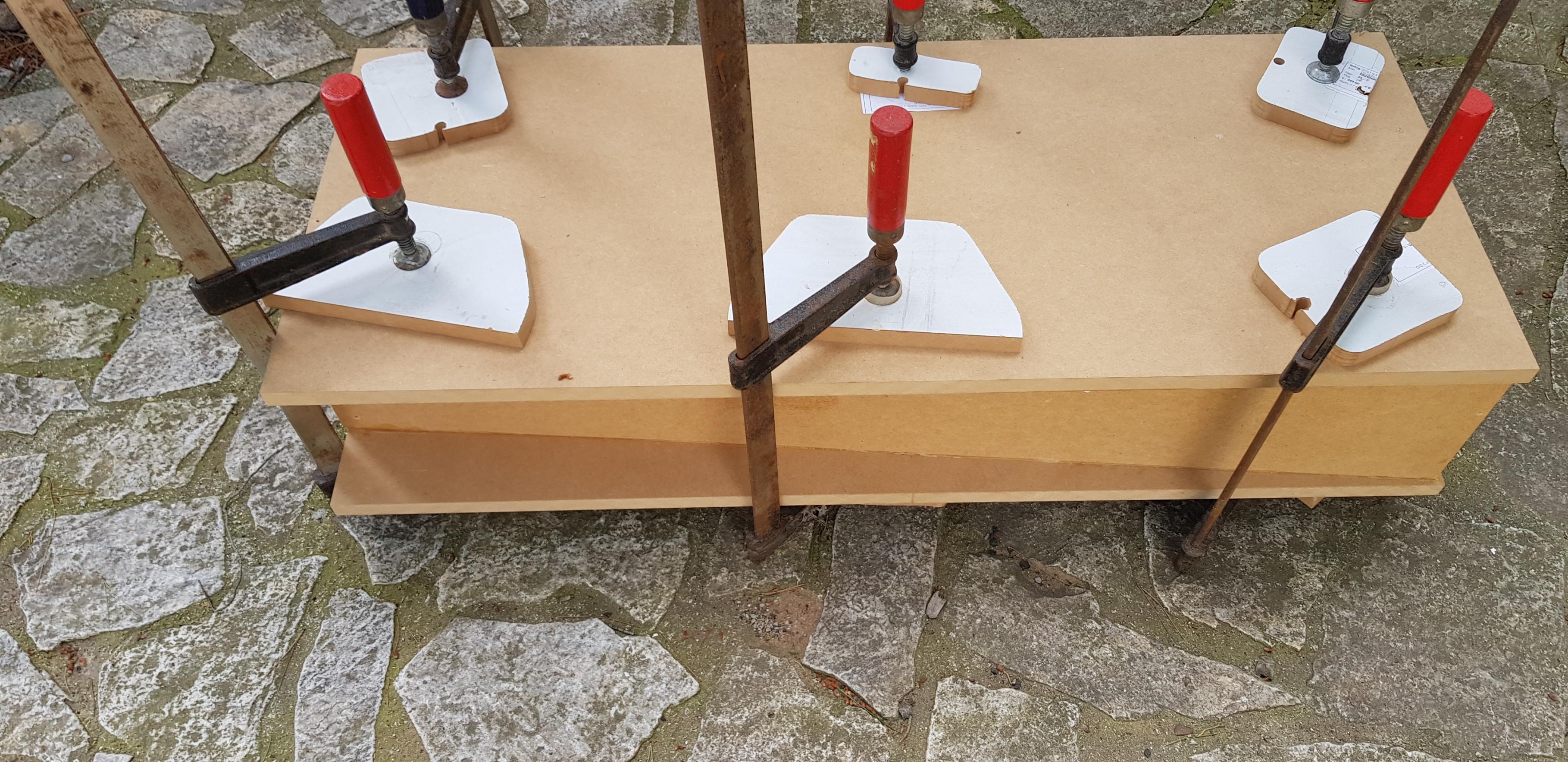

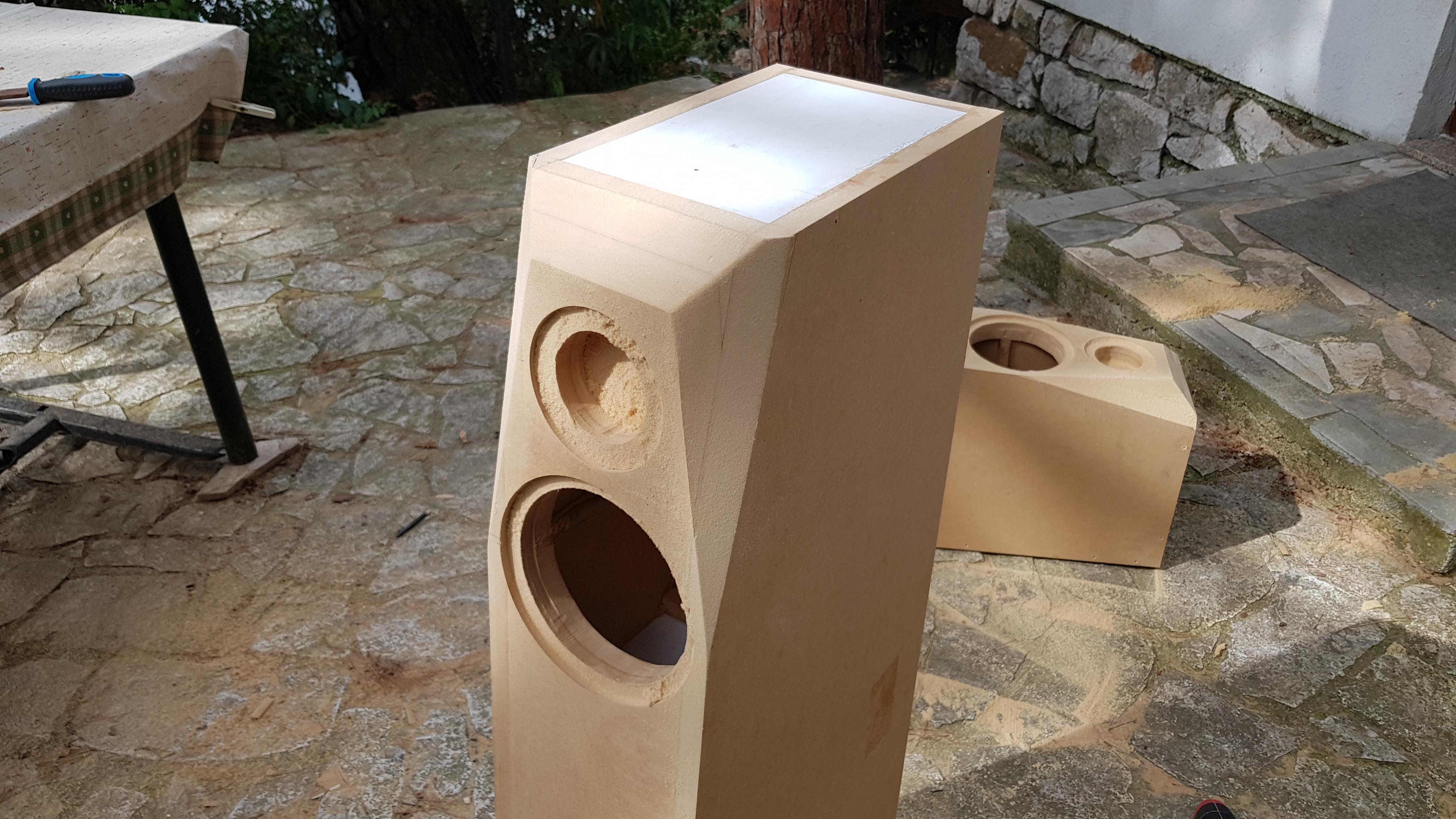

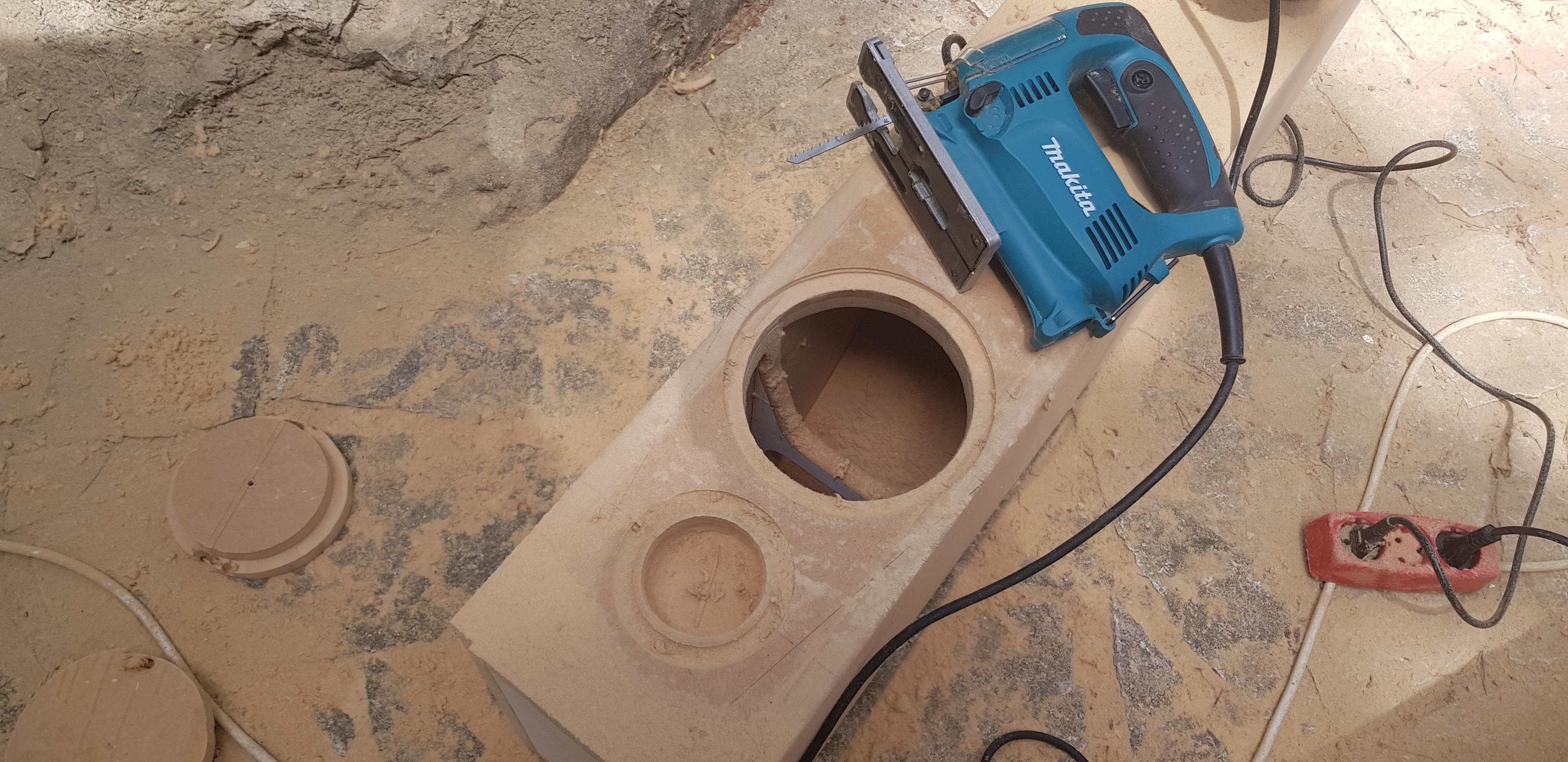

Hi all
It's been I while since I open this tread
would like to say thanks once again for help and advices
here are some pictures of work in progress and final results
The loudspeakers are based on Peerless XLS10, Satori 16P-4 and Satori BE (4ohm)
I'm using ARA BE passive crossover ( from SBacoustics site) be twin Satori, but have remove notch filter plus added some more attenuation on tweeter.

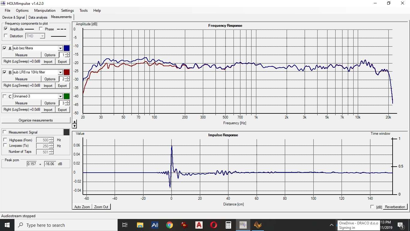

All is driven via Hypex plate amplifier PSC2.400 which are 2xUCD 400 (400W amplifiers) with DSP.
One channel, with linkwitz transform, is used for driving peerless XLS10, while other is driving Satori pasive combo.
Crossover point in be twin is LR4 at 140Hz.
I like the sound and it was fun project 😉
Here ara some pictures and measurement which I made at open space, at not perfect condition (have had some fence in front of loudspeakers/tweeter) but thay are good enough for me, to see what is going on at low end.

some more pictures
