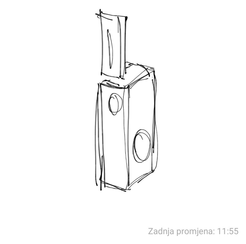

I've got an Ascendo-aesthetic idea rolling-around (based on a similar older design of mine that's no longer).
-the Peerless subs would work well with the idea, but ironically - the other driver's you are thinking about would not. 😱
The most particular point about the idea is that the midrange is radial (as in "upward firing" - toward the tweeter, inset to the lower cabinet's top panel). And I know of a driver that should work well in this capacity. 🙂

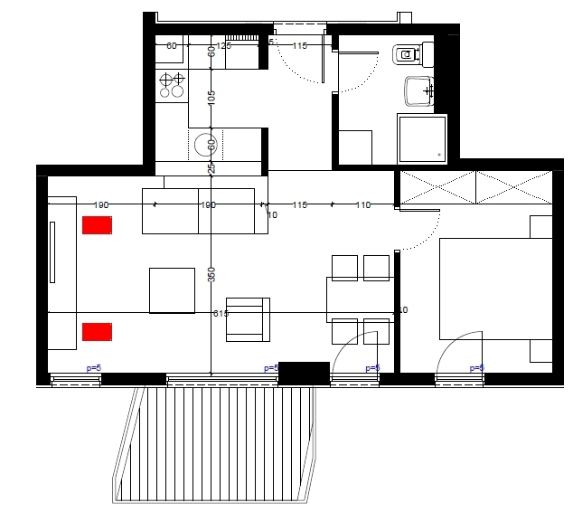

As I have very small room with an even wall's some say horror room for music 😀
the plan was to build 2 small subs with XLS10 to tray to even bass response

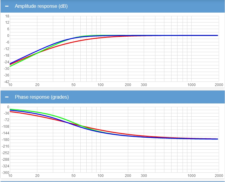

WO24 would go into 30L ? ( with use of DSP to rise lower response)
would I get anything with rising box volume for WO24 to 45L ?
it attachment is box model for WO24 in 30L in green, 45L in blue
and XSL10 25L in red

and the blue print of my apartment,red is loudspeaker placement, to give you idea

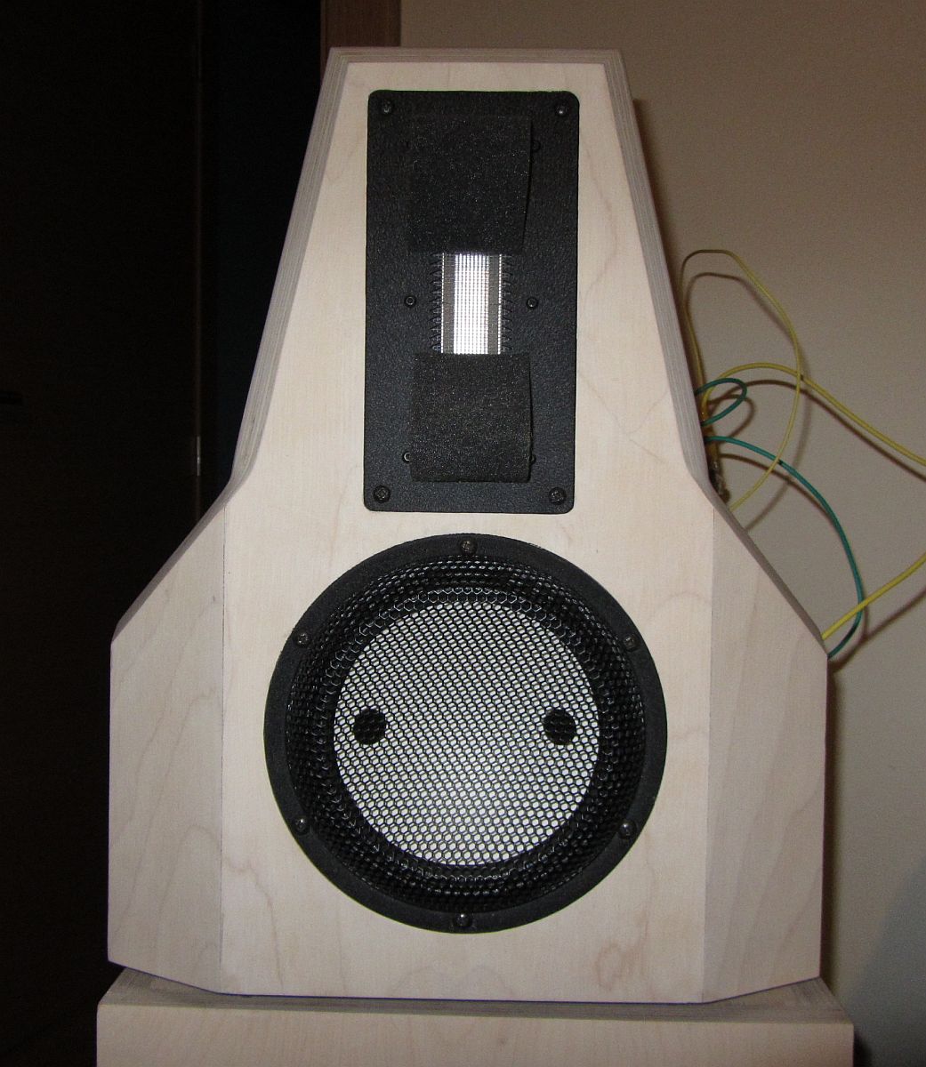

-you could do a mild horn loading of the RAAL to extend the useful response of the driver down to a lower freq. and a more appropriate radiation pattern relative to a larger midrange/midbass driver.
In fact, if it were me I'd do that on both sides of the tweeter baffle and go with the dipole version. 😉

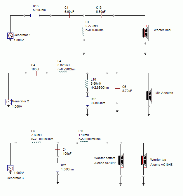

Based upon Google, the RAAL 140-15d is a popular ribbon tweeter with documented high quality measurements. On a medium width baffle, a 3kHz Butterworth topology uses:
5uF input // 0.27mH to ground // 6.8uF at ribbon
A series input resistor around 4-8 ohms should balance SPL with the Satori MR13P-4
Once you decide upon the baffle size/shape a CAD baffle sim will allow good 3kHz crossover ckt for the MR13P-4
Will you put the woofer on the side? On the front? A tapered narrow top, wide bottom woofer baffle?
You will want to run a room and baffle sim before you design the woofer Xover circuit...or are you going active?
