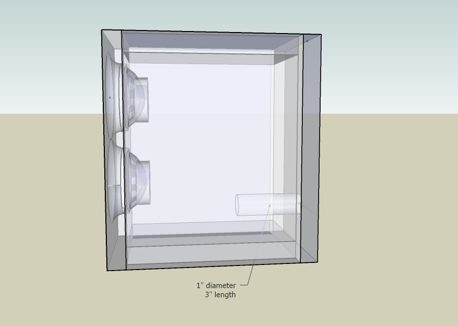

As I posted above, I was originally planning on using 3/4" plywood for the enclosures, but realized that I have suitable hardwood planks that I could easily cut for the panels. The dimensions of the finished design lend themselves to use of US-market dimensional lumber. Rather than being lazy, I'm attempting to use as many good "factory" edges as I can. I don't have a table saw and although I've made some furniture cabinets using a straight-edge and my low-end circular saw, blade deflection, cheap tools, and inexperience led to somewhat wavy cuts. The front and rear baffles would be made from 3/4" Paduak ("Puh-dook" in the local parlance) and the remaining panels from 3/4" rock maple. From what I gather reading other threads, hardwood seems to be a controversial building material from both sonic and mechanical stability perspectives. If I use these materials I'll be applying 3 coats of lacquer to both the interior and exterior surfaces to limit moisture-related expansion and contraction (and hopefully cracking). All glue-joint surfaces will be masked before I apply the lacquer. Any other advice?

It is awfully hard to freehand-cut a 3" diameter hole with a jigsaw

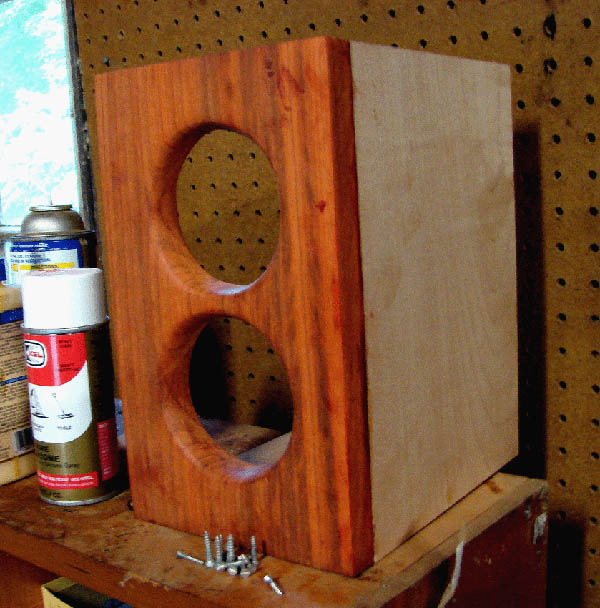

1st box
This shot "artfully" obscures my 8th grade shop-class level woodwork. The Paduak is beautiful, but quite orange in color. It will darken significantly over time and look more like rosewood. Please ignore my sloppiness with the glue...everything will be sanded again once the panels are fully glued.
On a side note, I somehow neglected to foresee how far recessed the drivers will be when mounted to the rear of the front baffle. I know, it's 3/4", but 3/4" looks a lot deeper than I imagined. They look like shallow horn loaded mid-range speakers. Given the irregularities in the contours of the baffle (done with a rasp and dremel) I think I might be on my way to the world's first "Stochastic Horn Loaded 0.5 way PC Speaker".

damping
I've been reading other threads on vented cabinet damping. I was planning on using urethane foam sheets to line the rear and bottom panels. From what I gather, many folks believe (know?) this material works very poorly, but zaph suggests it's suitable for low-cost projects. The stuff I have on hand is packaged for use as chair pads. It's a medium density foam cut to 16"x16"x1" sheets. 1" thickness seems a bit much in such a small enclosure, and I'm concerned about the loss in net volume. I bumped the height of the cabinets up another 1/2" to 10" to compensate for the driver and port volume, as the WinSID modeling suggested slightly larger volumes would be more "forgiving".Would cutting the foam material down to 3/4" or even 1/2" be a good starting point for experimentation? I did end up purchasing a small can of plasti-dip that I will use to coat the interior surfaces of the panels before applying any foam. I just need to get a small amount of naphtha to thin the coating before brushing it on. I was unable to find a local source for the aerosol can variety.
All of this is taking far longer than I imagined when I started day-dreaming about the project, but I'm trying to avoid any MORE rookie mistakes. My choices to re-style a proven design (Timn8ter's PC speakers), switch to a 0.5 way design, AND use hardwood panels have introduced a lot of uncertainty in the final results. Thanks again to those of you kind enough to help!
The foam must be open cell - i.e. porous and sponge like.
Closed cell foam will not do at all.

Thanks again, sreten. The foam is open-cell. It's a little dense compared to the shredded and bonded urethane foam carpet underlayment sold in the US. This stuff is homogeneous, white, and spongy.

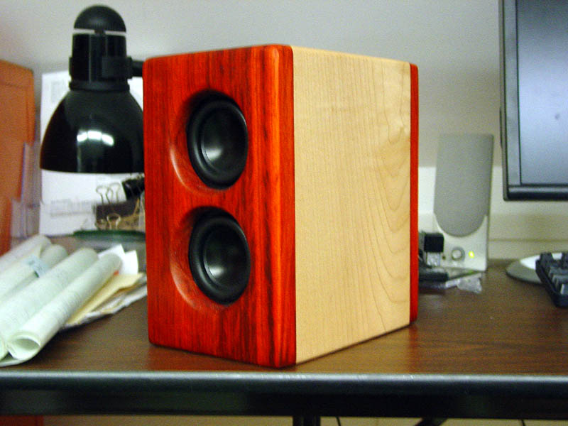

I've finally had some time to get back to this project. I thought I'd post a couple of pictures of the first completed speaker, for those of you that might still be curious. I'll post some interior shots of the 2nd box build, as I really just wanted to get this 1st one banged together.
The finish is just a satin lacquer - 4 coats. The Padauk is REALLY RED when sanded to fresh wood. From a moderate distance (~2 meters) it looks a lot like rosewood. Once you get up close you can see the open pores in the grain, but I think it still makes for a striking enclosure. If I had more woodworking skill, they might have been something special. As it is I'm vacillating between moderate pride at the end result and flashbacks to the paper-towel dispenser I made for mom in 8th grade shop class.🙄 Most of the glue joints are nice and tight, but the rear baffle gave me some real headaches. Hand sanding with a large sanding block evened out the adjoining panel-ends, but I rolled the outer edges just slightly, leaving a narrow gap in the edge of the joint. It's structurally secure, just not as aesthetically pleasing as the rest of the joints. By far the worst of the mistakes I made during construction was the hand cutting/sanding of the speaker cut-outs. No one will mistake them for a router job.

I have some rear mounted speakers like yours and the midrange was a little harsh until I put a strip of adhesive wool felt around the inside of the cutout. You might want to experiment with that, you can get the strips from:

although your finish is beautiful, so maybe do it in a way where it can be removed without leaving residue.

1st impressions of sound
Thanks for the suggestion. I've only tested this single speaker at low volume and my preliminary impressions support Sreten's suggestion that an eq notch around 8khz will be needed. I knew I was going to have to play with EQ to attenuate any output below 60-65hz, so a little touch-up in the HF is not a problem. If I can't arrive at an EQ solution, I'll be inclined to try the felt ring treatment. These are just PC speakers, and already sound much better than I expected.
A/B comparison with my Paradigm Atom V3's definitely indicates a little harshness in my single speaker. As expected, they are also far less efficient than the Atoms. I'm very happy to report that the upper bass is clean. I was quite worried that male vocals and voice (NPR news broadcasts) would sound "chesty"due to the overlapping output of both drivers. They don't. As to the harshness...it's not bad, but noticeable in direct comparison with the Atoms. I'm quite glad that the inductor is there to roll off the lower driver's HF. I'm guessing the harshness would be more pronounced without it. I'll be playing with them more once the second unit is completed.
