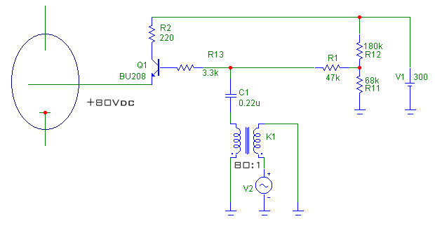

what is the best way to drive a tube (getter???)
The tube is PL519 and needs 80V DC offset.
At the moment I have a transformer driving a simple transistor stage driving the tube.
Now it is not possible (?) to use a bridged Aleph-x or equal because the tube has only one 'input'.
Should I use a classA circuit with DC offset ?
Or better a bridged supersymmetric circuit and a transformer direct to the tube (How to get the offset ?)
Greets, Bernhard

Do you have a circuit drawing for that?
Quite a bit of solid state parlance for a tubeguy like me but I assume you want to provide a -80VDC bias to the controlgrid of that penthode?
Do you use it triode-strapped?
There are several ways to go about this, one of them is simply using a separate bias supply.
Keep in mind that tubes don't come in complimentary pairs so you'll need some trickery if you need a PP drive/output.
Here you can resort to a SEPP configuration as used in OTL amps, it's not perfectly symmetrical by nature but has the advantage of nulling any DC offset at the output...
But again you'll need a dual voltage rail of about +/- 170VDC.

fdegrove said:Is the circuit meant to oscillate?
The tube yes, but the circuit driving the tube is not of course.
The tube generates HF ( plasma tweeter 🙂 )

Yes, I know all the links, my question is:
is there a way to use a bridged amp without using a transformer ?

Interestingly, I have had good luck driving plasma type
tweeters using a high voltage tube to cascode the
smaller Mosfet which serves as the actual gain device.
The Source of the Mosfet goes to ground, the Gate forms
the input pin, and the Drain goes to the Cathode of the high-
voltage high-power tube. The Grid of the Tube is biased at the
appropriate DC value, and the arc of the plasma is driven
by the Plate of the tube. Worked great on Plasmatronics,
and had quite a bit lower distortion than other approaches,
and also better reliability.
This approach is also really effective in driving electrostatic
loudspeakers....
ps. This approach operates great without a transformer,
bridged or unbridged.
