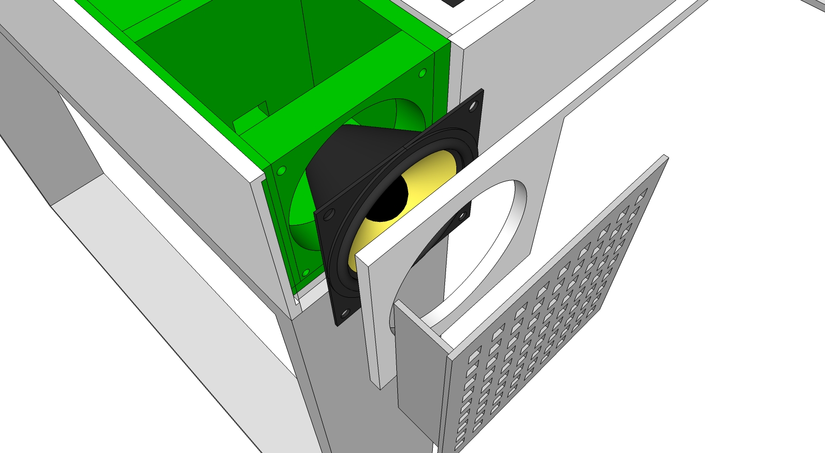

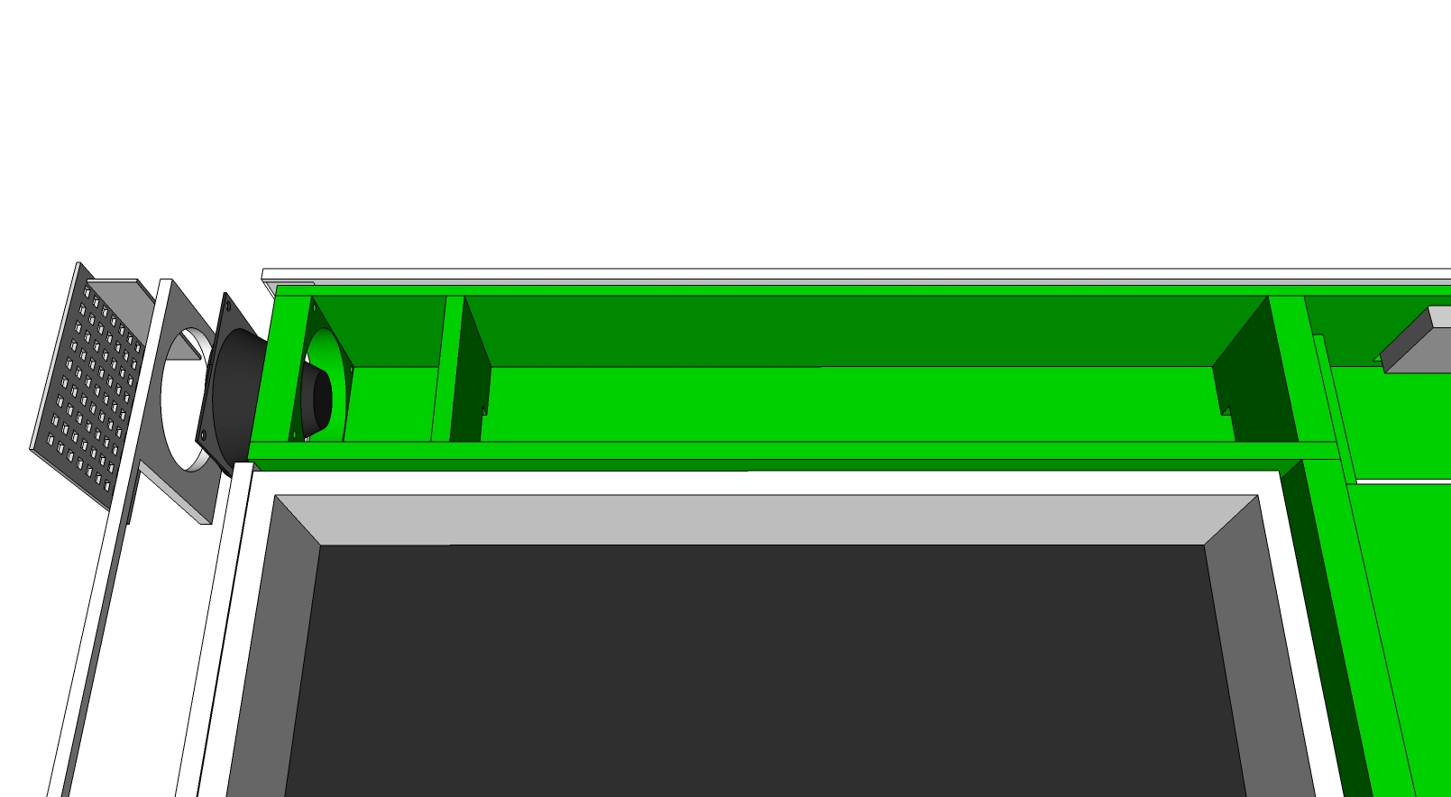

The volume can be altered to whatever is good, i have attached an image to show the interior configuration.
The width of the channel for each speaker is 79mm and height is also 79mm.
The block of wood behind the speaker can be moved, it is there for no other reason than to isolate the driver, is this even needed?
In the images below, green is moisture resistant MDF, white is 6mm corian.
I have hidden the driver behind the corian cladding but looking into how I can still make it removable, saw my b&W 685's and saw how clean they looked 🙂

Sorry I thought you meant to build your own sub. You seem to be new to audio DIY so maybe it would be best for you to look for an off the shelf small stereo amp that you could hide away?
You want to be looking at about 0.83 litres volume for each driver. I suggest you also use some wadding to tame the reflections due to the square and small box.

So for the volume, would it be best to put the block of wood separating the speaker 133mm away from the driver? this would equal .83 litres in volume, does it matter if its in a rectangle shape?
Yup put wool in the last prototype, will do the same here and stuff it with a good amount.
