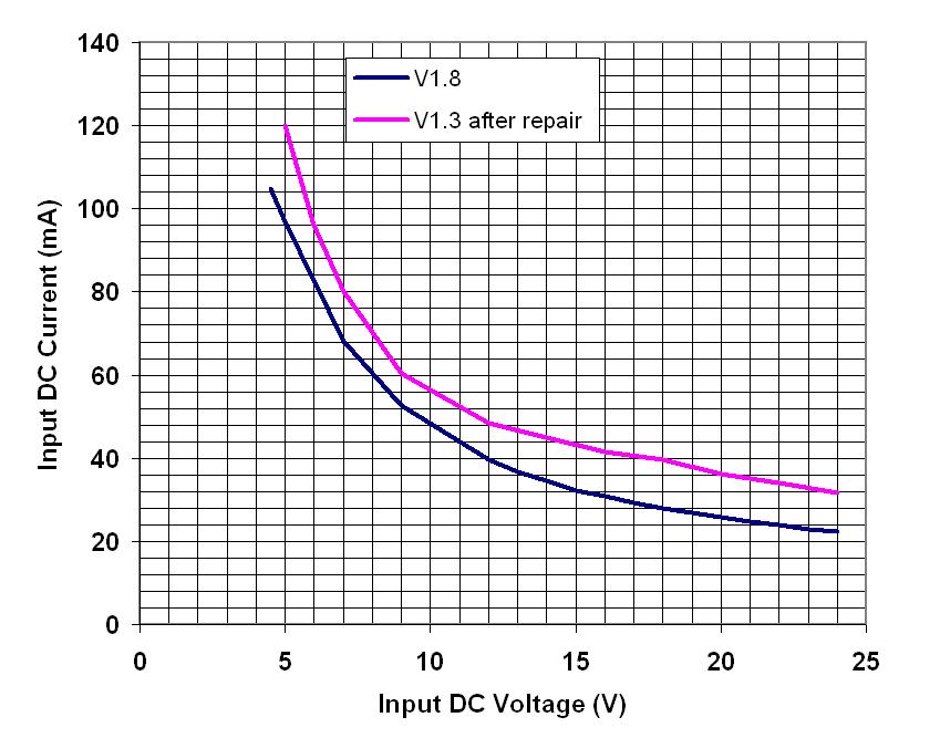

The guys at miniDSP were kind enough to offer a free repair for my fried old (V1.3) 2x4 board but I have managed to repair it myself. The fault was on a dual Schottky diode. Now it is up and running.
Just on time (yesterday I received a miniDIGI and a miniStreamer so there’s work ahead 🙂 )
George
