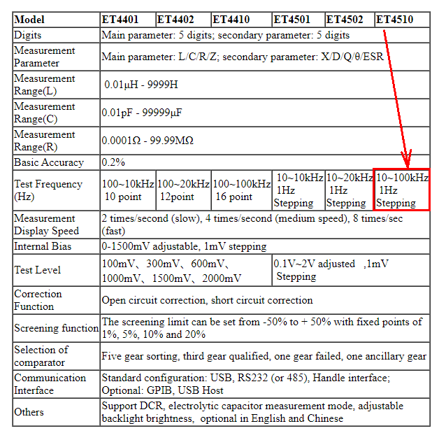

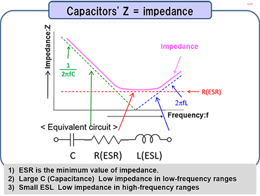

I'm happy with my East Tester ET4510 (sales link). It lets me choose the test frequency with 1 Hertz resolution, and thanks to the nifty "Impedance" feature, it can also measure the self resonant frequency and the Equivalent Series Inductance ("ESL") too. It's nice.
_
