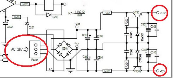

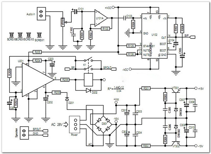

I assume that this reference is to a 28ct VAC power transformer offered by Hammond Manufacturing in the link I am providing? I have posted a schematic of the amp in case that holds any clues on the power transformer I am looking for.

Going back to the original amp schematic,(in the first picture) it shows a 28V source resulting in 15VDC supply rails.

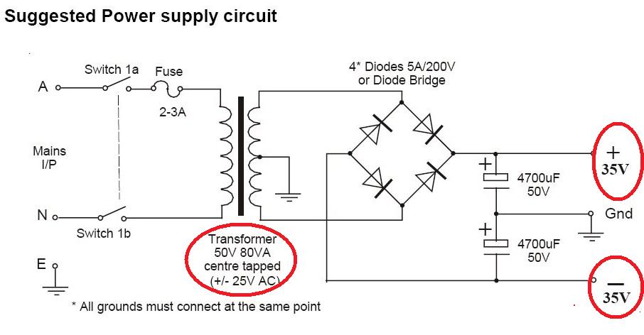

In the second picture is a suggested power supply for the TDA7294 IC (courtesy of Quasar Electronics) which shows a 50V 80VA center tapped transformer (+/- 25V AC) which results in 35VDC rails.
If I take into account the specs in the original schematic, my guess is the designers of this amp module are calling for a 28V center tapped transformer that results in (+/- 14V AC).
The transformer I posted the link to at Hammond Manufacturing seems to reflect voltage values that I am looking for here(picture 3).

In your 1st diagram your totally missing the point, note +Vcc and
-Vcc. The 15V rails are for the op-amps, not the power amplifier.
No you do not want a 28V centre tapped transformer, that is wrong.
Your old transformer should work, perhaps a little high for 4ohm load.
rgds, sreten.

disconnect the transformer and test it. If it passes, then reuse it.
It should be ideal for a 100W into 4ohms mono, or 60+60W into 8+8ohms stereo amplifier.
