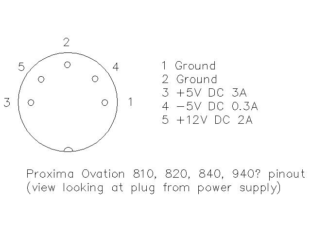

I just won one on Ebay for a cheap price, but it needs the power supply. Does anyone else have this model?

The Infocus panel uses a 5 pin din connection like on old keyboards.
I called Infocus technical support and they couldn't help me. They refered me to a store out in CAlifornia that wants $150 for the power supply!
I just wish I knew how to make my own. Can anyone help me?

Thanks HanClinto and Bixs. I actually have the 5 pin din from an old keyboard. And I can lay my hands on an old power supply.
Do I have to make/buy an adaptor to connect the 5 pin din to the power supply or are you talking about soldering connections from the power supply to the wires of the 5 pin din?
If so, is it easy to figure out which cables from the power supply need to be soldered onto the wires for the 5 pin din?
Also, are the input requirements for the panel, (100 - 250 V, 50-60 Hz, 1.2A), normal for the average ATX power supply?

I would use an AT power supply that way you can turn it off with the switch. I tried using an old keyboard cable but it didn't work. Panel draws to much juice and the cable got hot pretty quick. You can get the connector from radio shack and then solder the wires from the power supply to the correct pins. Most power supplies have a diagram showing which wire carry what voltage. The power supply should have no trouble powering the panel.
