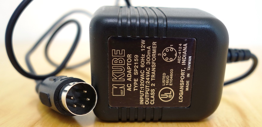

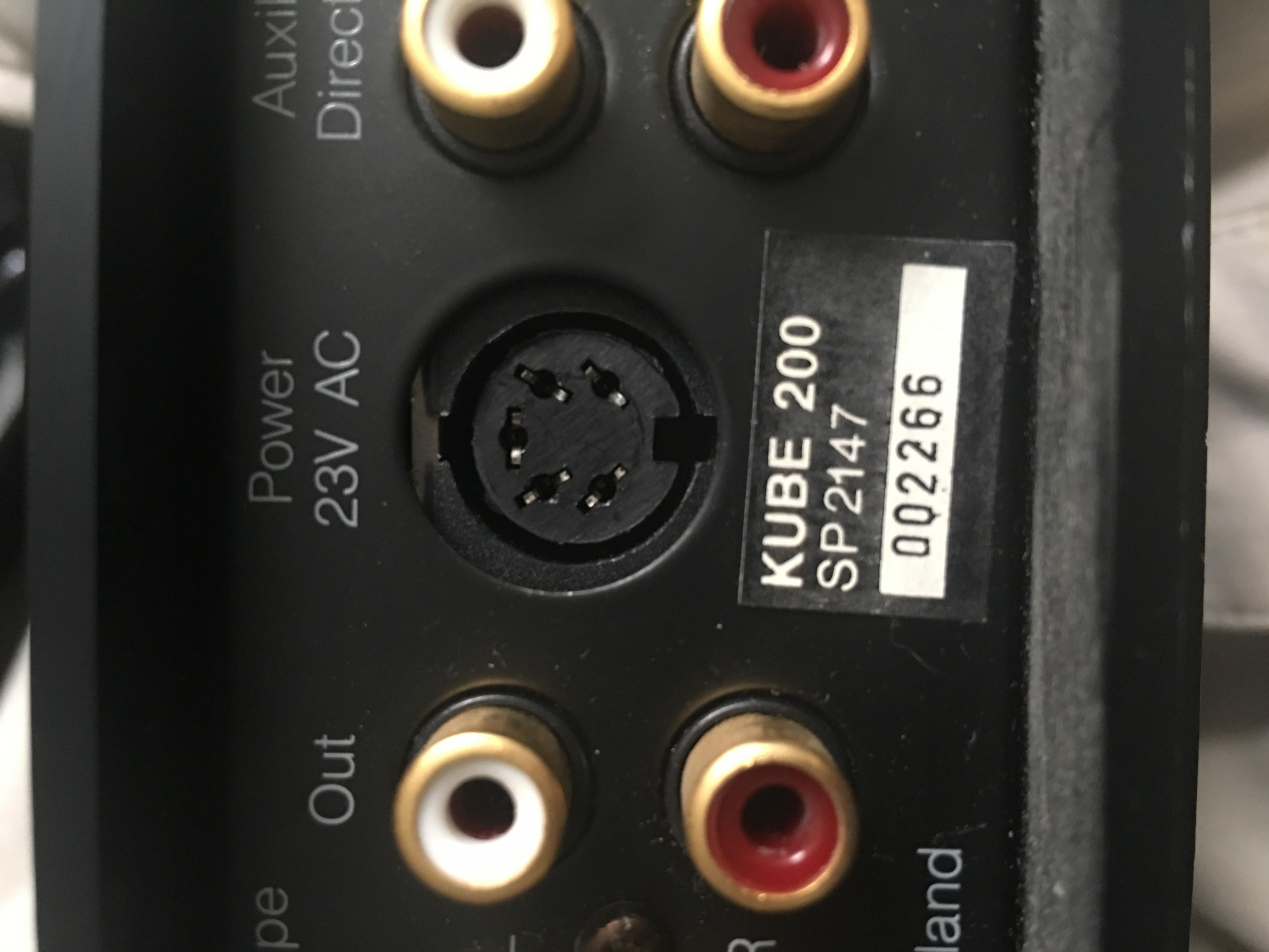

I have a KEF Kube 200 and naturally I can't find the power supply. It's a 5-pin input on the back (see attachment).
I assume KEF used off-the-shelf power supplies/wall warts at the time?
I also found a pic of what I think is the correct power supply - searching online doesn't seem to yield exactly what I am looking for. Particularly with the 5-pin input.
Any tips on finding something like this? Or where could I go to have someone make one for me (I don't have any electronics skills so I would need someone to do it for me)

No chance of finding a power supply with a 5 pin DIN output plug.
You need someone who knows what they are doing to check
the power input wiring and fit a 5 pin DIN to a suitable supply.
Though it appears to be 20VAC across pins 1 and 3, FWICT.
