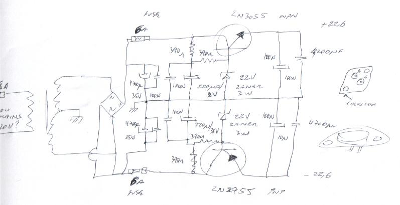

Your transformer is 120 VA..... so it is weeker than the needed trafo....they asked 150VA... thinking in 3 A current.... thinking in 36 watts on 4 ohms, this way, i think your voltage will reduce a lot when in hard use.
And i could not understand clearly if this is both channels driven or just one!... so, everything can change.
This way i scratch a reduction voltage circuit.... an electronic filter and not wonderfull related stability of voltage...but reduce voltage and protect your equipment.
Use enormous heat sink.... area may be something bigger than 2500 square centimeters.... alike, not precise, 25 fins of 10 by 10 centimeters..... and if you push it hard, reaching 48 Watts maximum, put a fan to help you .
Cheap is protected inside..... when overheat it will reduce power to some amount of battery powered equipment... small batteries... it will go down to something around to 5 watts when overheated and can shut off to protect when heated.
Chips is very complicated because their metal size to transfer heat!... this way, when they say 100 watts..... really, count with 25 percent of that.... or .....booooooom!
Scratch (ugly, i am running, my daugther want our micro to MSM).
If you wanted you can move voltage changing Zener voltage.... this way you control... a 22 volts zenner will result in 22.6 because of transistor junction diode (0.6)...you can go to 28 volts zener if you want.
If no good, i know how to improve this simple supply.
Good Luck

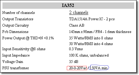

Ok, I am very sorry about that. I am going to be driving just one channel. Now that I do remember I'll only be driving one channel I am sure that the Transformer will work since the reccomended transformer is for 2 channels...
Hmm, yeah.
Alright, lets pause for a second. I have a few questions in reference to the data sheet below. Areas circled in corresponding colors as to the question.
Red; Since the original AMP is two channels, maybe the given rating is asking for two positive 20v outputs (one for each channel) and a common ground the channels would share? or does the amp really need both +20 and -20 voltages. If so that would simplify things for me.
I would ask the guy who runs the site but he is away on vacation. So if you could help me I'd appreciate it 🙂
Blue; Could I assume I would only need half this power for powering just one channel?
Reference:
Reference:
Yes, you can assume that you need a half
Only a half of this power will be enough, this way your 120VA transformer will be very good, you will have around 30 volts and when hard use voltage will down, lets say...hummmmm, 26 volts. this way things will work very well.
I Made a better circuit, the same, but a little bit cleaner.
Can use it or not, better to use.

My young friend, i put a schematic up... there, you can understand clearly how to obtains plus, minus and ground with a transformer.... must measure resistance in secondary to be shure where the extreme points are (primary, mains conection has bigger resistance values than secondary, where voltage is reduced).,bigger resistance will find when you hold extremes coil wires (the ones that goes to the bridge rectifier... ground will go direct to condenser junction)..... the third wire will be ground...lets see...hum..... 10 plus 10 ohms measuring three wires, two each time with an ohmeter... resistance scale, low resistance, reading X1, or digital 200 ohms resistance scale. Measuring 10 ohms and 10 ohms, you will discover the one is common for both measurements... this one will be the ground. Resistance will be variable, can be 50 ohms, or 1.2 ohms, depends of the transformer power.
Must conected in a bridge rectifier, have to buy one that can hold more voltage than you need and better to be 3 or 5 times more powerfull related current you will need... have a 10 amperes bridge rectifier.
The way to wire them is showed in schematics.... but primary, the mains voltage will need some friend better qualified to give you assistance first time to discover how to connect input mains wires.
Some transformer have a lot of inputs: 110 Volts, 125 Volts, 220 Volts, 240 Volts... this way may be confused. Need assistance near you, together, sitting at your side.
