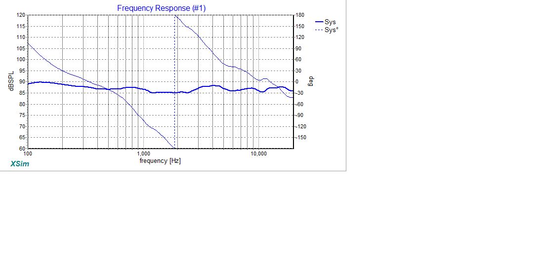

Here is the listening position FR for the small thors with the nextel drivers after much help from Allen and Lojzek GM and many others they are now in the campfire and the braces are in the new speakers

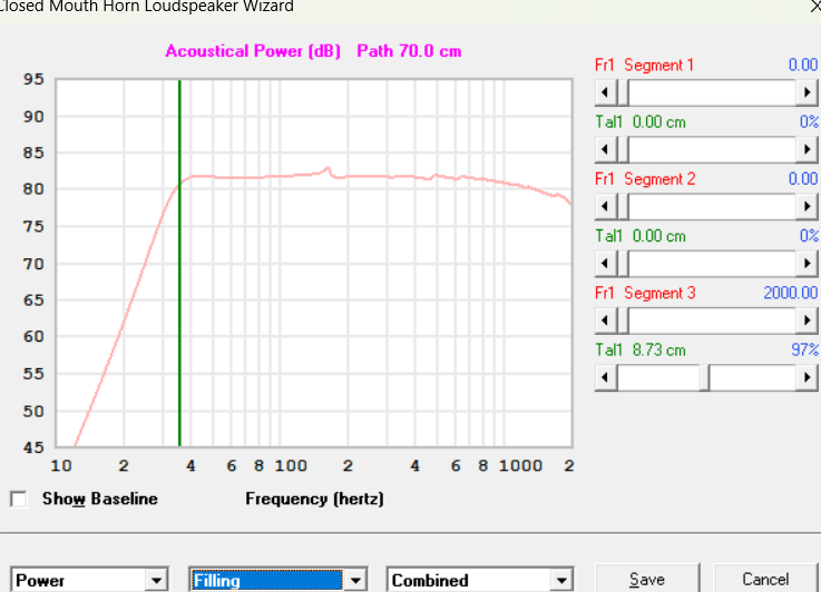

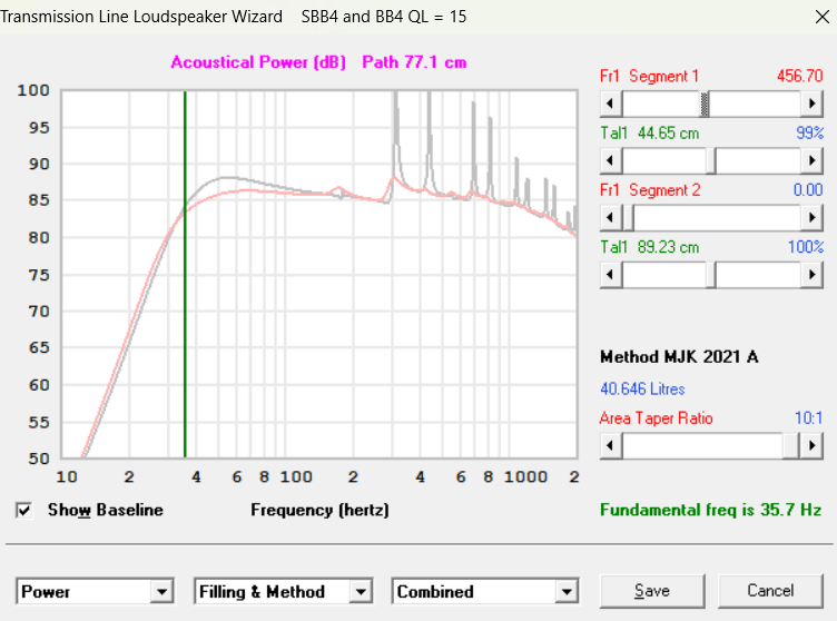

thank you I am using the tweeter because it is an mtm. using double the sd - I do not understand how to calculate s1 I get the following chart Does this mean I need to add a pound of fiber fill to the top of the chamber? to minimize the resonance? thank you
switch to the "schematic" view in the loudspeaker wizard to see how the sliders change the filling and it's graphic representation.
also note that your wizard seems to indicate a traditional transmission line, not an offset port mass loaded TL, if I am not mistaken!
the offset port MLTL is essentially a bass reflex box with a long enclosure that allows you to simulate the longitudinal resonance.
the advantage of an offset port mass loaded TL is: much less length required and a very good possibility to cancel all unwanted resonances.
the disadvantage is a slightly reduced main resonance output.

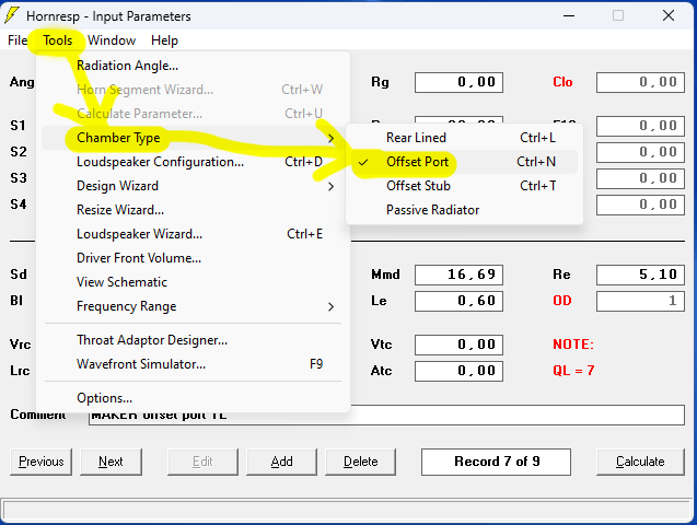

How do I find that I looked thru the help and menus and I do not see offset port mltl. I would like to see as the boxes are built and I am painting them. I can add material to make the box smaller and add material to decrease the volume and the location and size of the port but that is about it. when I run the loudspeaker wizard I get a wild power graph.
How do I find that
in the loudspeaker wizard you can adjust the port under the "chamber" settings.
the Transmission Line Wizard is not available for mass loaded TL, by the way!
EDIT:
alternatively if you start with the input wizard (under "help") you can chose "offset port" in the transmission line input sequence.
EDIT 2:
I think you will only find the options as shown in my screen shot when there is already a port defined... but input wizard is probably the best method, anyway!

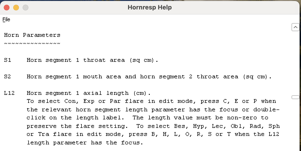

To Run hornresp as a TL - With the holey braces in how do I calculate the S1 S2 S3 ?
The Help file includes some explanation of of the modelling inputs and outputs such as for S1, S2...
If using Hornresp, I find the Design Wizard useful in understanding how a speaker driver will interact in the closed, box, bass reflex and TL and default options are provided. From there, user adjustments can be made to see what gains are possible or for other options, the Input Wizard is useful. Dave in the full range forum and others eg GM have over the years posted on their advice for bracing such as positioning etc for maximum effect. A search could chase that down.

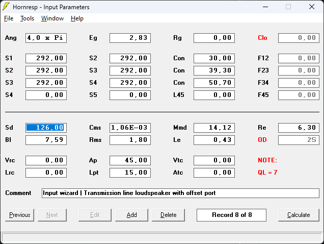

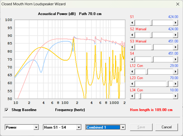

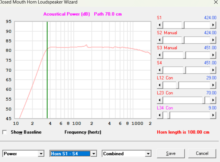

thank you well its worse than that the drivers are fixed as well the boxes are built but I have not put the ports in yet. here is the input screen I assume the s1 s2 and s3 are the area of the inside of the box. I am confused. as a ported enclosure the graphs look ok with many small spikes but as a TL it looks really bad. I can of course add to the box to make it smaller volume and to some degree make it shorter. is Vrc the total speaker volume and Lrc the total length? I used the holey brace from Dave and Scott in both direction so at 6 1/4" from the front baffle there is a 3/4" vertical brace that has many holes in it. about 1/2 of the cabinet has a brace from the drivers to the back of the cabinet. I am hoping that I am just inputting something grossly incorrect. thank you again
We may have found the issue:
If you input the "horn" dimensions (S1-S4 and lengths of the Con horn sections, defining your speaker enclosure) and a rear chamber (Vrc+Lrc) you essentially build a 4th order bandpass. So you should just set both Vrc and Lrc to 0 (zero).
The enclosure volume is calculated using S1-S4 and L12-L34. The total volume is shown in the "schematic" view.

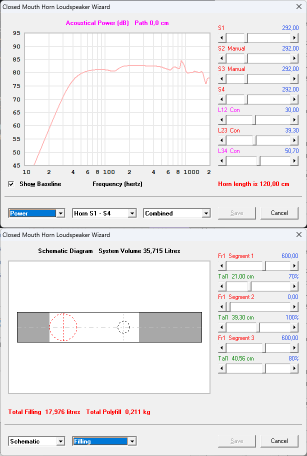

But you still adjust the port in the "chamber" settings.
EDIT:
By adjusting the L23 slider you change the port position.
have a look at the "schematic" view to see the change.

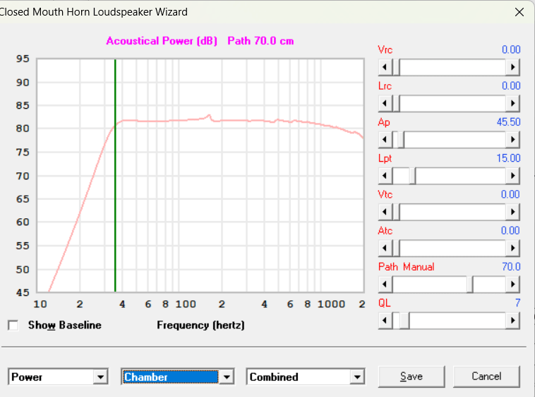

attached a quick proposal with changed port position by adjusting L23 and a filling suggestion.
adding further filling may even out the remaining peaks and dips (but also reduce the bass output slightly).
By the way, because you have two drivers at different positions the peaks and dips will probably be less severe than shown in the hornresp simulation!

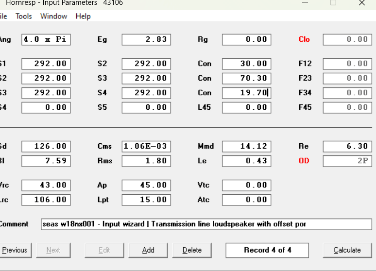

and the respective input mask:
thank you stv that helps me alot I was very unsure about the vrc and lrc that makes me feel much better. I have been working on it for some time and I appreciate your help on it. They should sound good I have a few more coats of paint to put on and then I can start to measure them. thank you again I will update as I make progress. The hornresp program is really something an amazing work of science.

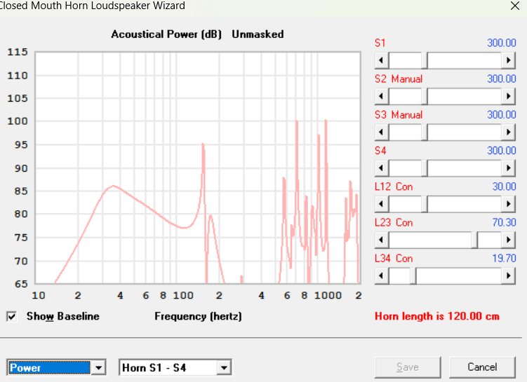

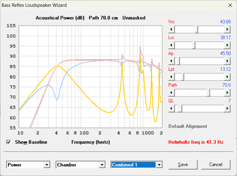

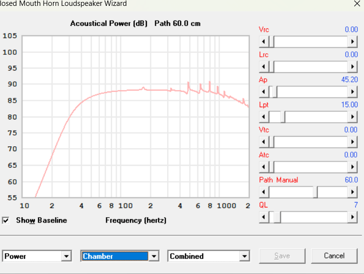

So according to these charts it looks like pretty good power line. I will post once I finish the speaker and start testing. It looks like output 2 is making most of the issues is this the port? and is there a fix? when I run in bass reflex instead of TL the port (i think) still has a negative impact.
Yes!
and is there a fix?
Yes and no: the 180 Hz peak is caused by the enclosure length and could be reduced by changing the driver location. But I think that is not possible anymore, right?
The other higher resonances are caused by further enclosure dimensions and by port length. (Partially) filling the enclosure or just lining the walls will reduce those peaks.
For further information on those peaks have a look at my port resonance thread!
Yes.
Directing the port to the rear side of the speaker will help.
You could also use passive radiators to reduce resonance peaks.
But don't be too concerned about them. It's common with all bass reflex speakers.

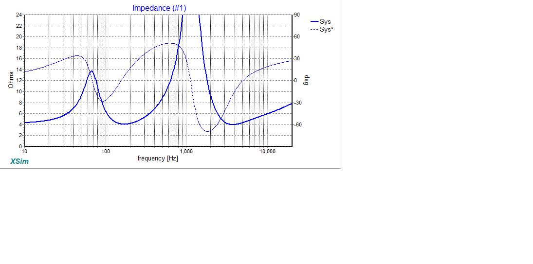

Would I be crazy to try a sealed cabinet I am waiting for the ports which will be a while in coming and never considered a closed system. I think once the speakers are painted and assembled I may try it before I cut the hole for the ports. Not sure if the crossover will work at it is the original thor crossover with the tweeter cap and resistor removed to match the increased db of the nextels over the magnesium drivers. the last screen shot is with the tweeter inverted to show the actual crossover freq. which matches Joe's.

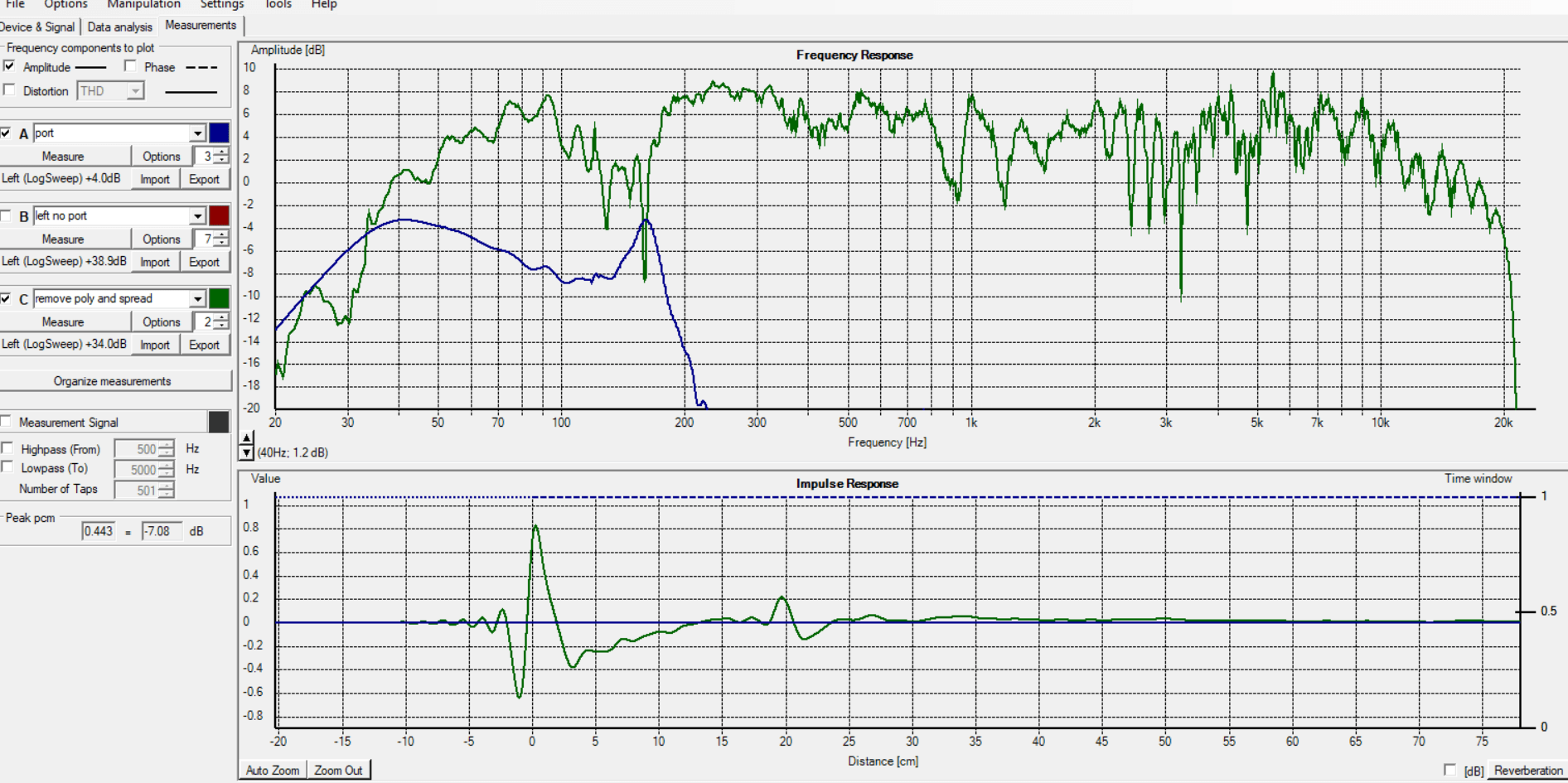

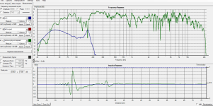

here is the first results I have a suckout between 100 and 200 spreading the wool out helped a little measurements are outside. any thoughts on how to raise the suckout?
thank you
did you do nearfield measurements? otherwise it might just be the room.
There is a strong longitudinal resonance that exits the port at around 150 Hz (also visible in your hornresp simulation in post #15).
If filling both ends of the enclosure and moving the port position does not help (try with the hornresp simulation) you might consider an internal helmholtz absorber: see here (also find a link to a german in depth description - eventually use a translator).
installing such an absorber might need some tweaking, but once it's installed it works very well!
