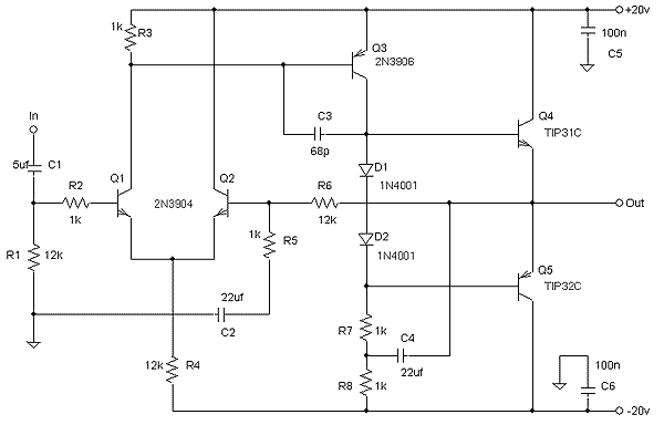

well if you do decide to build one from a schematic this is about as simple and cheap as it gets. This a stripped down p3a that works surprisingly well for it's lack of parts. It's only good for about 5 watts but can be made from fairly cheap.
If you would like to try this I can send you all the design and construction info.
