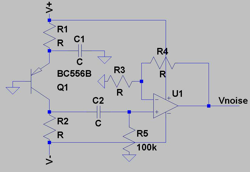

Anyone have a simple test circuit?
I have a bunch of BC556B (pnp) and want to select them for an LTP stage.

That is matching for Hfe, he asked for a circuit to measure noise. I assume he wants the 'quietest' specimens for his LTP.

RJM1, how do i work out the component values for a +/-12v supply and 1ma thro Q1?
what R values for the opamp?
use a scope on the output?
thanks.
thanks.

R1 = 11K, R2 = 5.6K for 1ma at +-12V, caps about 10uF, R3 about 100, R4 I’d just use a 1M pot and adjust it to a good level since you are just comparing transistors and don’t need to measure actual noise levels. Measure with a scope or a volt meter. Scope is better.
Note that:
* There is voltage and current noise. You want to test for both unless you're sure one is negligible for your application.
* To measure noise you want a well-defined bandwidth which is meaningful for your application (e.g. 20 kHz for audio). In other words: you need a low-pass filter somewhere.
Samuel
