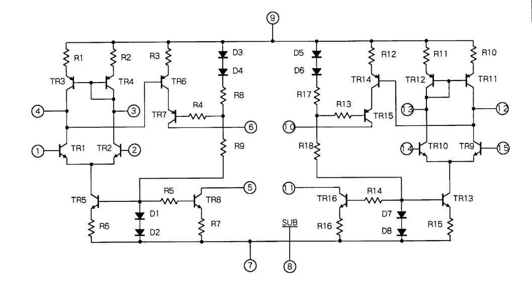

I have a service manual, and noticed there is this STK-3122-3 soldered to the main board. It seems the job of this STK is to run the power amp outputs.
So I took my meter to the 15 leads of the STK-3122-3 and I found something interesting. Here are the results of my readings presented this way:

I have already ordered a replacement STK-3122-3 but I wanted to ask you experienced people your opinion of what might be happening with Pin 7 and 9 and if this is a failure mode? In your experience, does this show a dead STK?
Thanks for any help.
Cheers!
Pin 9 is the positive supply and pin 7 the negative.
So pin 7 measured value looks correct. The marked value is incorrect (happens all the time in old service manuals).
Pin 9 should have PLUS supply present. You measure a negative value which points to a missing supply (fuse or safety resistor open circuit). That doesn't tally with it working on one channel though as the chip is a dual.

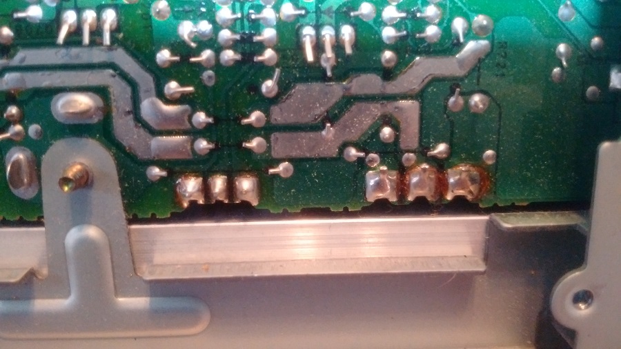

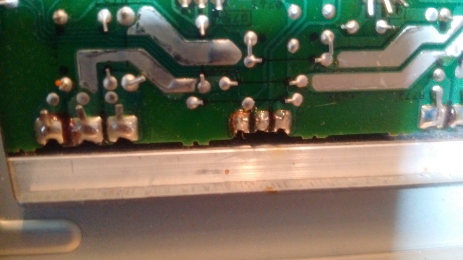

- Photos taken of main board output transistor solder connections for your opinion - attached

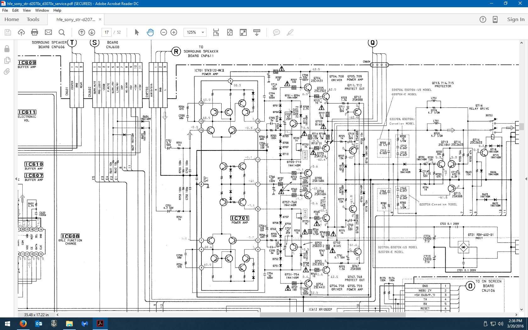

Regarding your comment of checking the supply voltages, I want to make sure I am measuring the correct location. Can you have a look at the crop of the schematic to point that out to me? I have the service manual in PDF here I could email you to help me sort that out and where to find that safety resistor.

The different numbers sound like production codes... no problem. As long as its an STK-3122III it should be OK.
All the resistors with exclamation marks are safety resistors but the two we are immediately interested in are those to pin 9 and pin 7. You should have PLUS 60 volts or so on both ends of R787 and MINUS 60 on both ends of R737.
I think that is where we left off... and they are the first things to check.
To measure the speaker output voltage you need to be checking this before the relay, so that is on the line L751 and L701 connect to.
If the safety resistor to the STK is open circuit then you need to confirm there are no other obvious issues such as failed output transistors and that the 0.1 ohms that connect to the output transistors are OK. You then have the option of trying a new resistor (more in hope) or perhaps simply replacing the STK and the resistor together and then testing.
