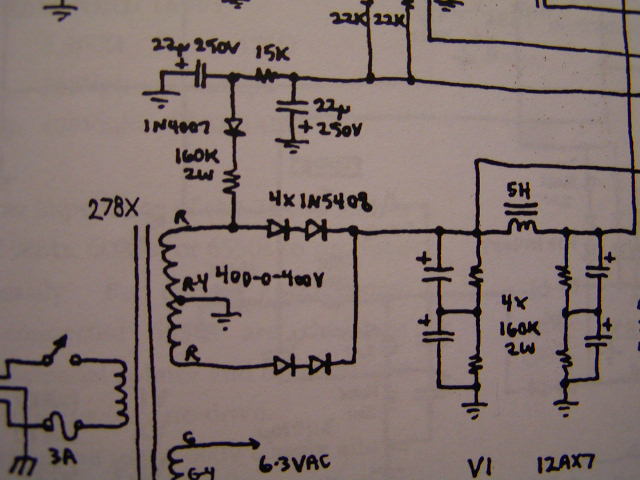

Craig mentioned in an email a circuit that would work.
I did some digging and found this circuit in "Principles of Power"
page 5-29
I will include it for discussion.

In a prior post I posted a circuit that made a negative bias supply off of the secondary of the power transformer. This so far has not prompted any discussion as to its merits so I guess its not the thing to do and the Radio Shack route is the way to go.

I used a very simple setup in a design I did in the early 90's.... a 0.03uF film cap (orange drop) from one of the secondary ends in series with a 43K resistor to ground. At the junction of the 0.03uF cap and 43K resistor, take a diode for rectification to a 50uF cap to ground. From this point, use a series resistance of about 40K between a pot and fixed resistor(s)... take your adjustable bias for the pot wiper to another 50uF cap... it will easily bias a pair of EL-34 tubes. It's been working on several amps for over 15 years... has never failed and doesn't make a lot of heat either.
Regards, KM

here are the old-school variations...just google on fender bias circuit or marshall bias circuit etc
