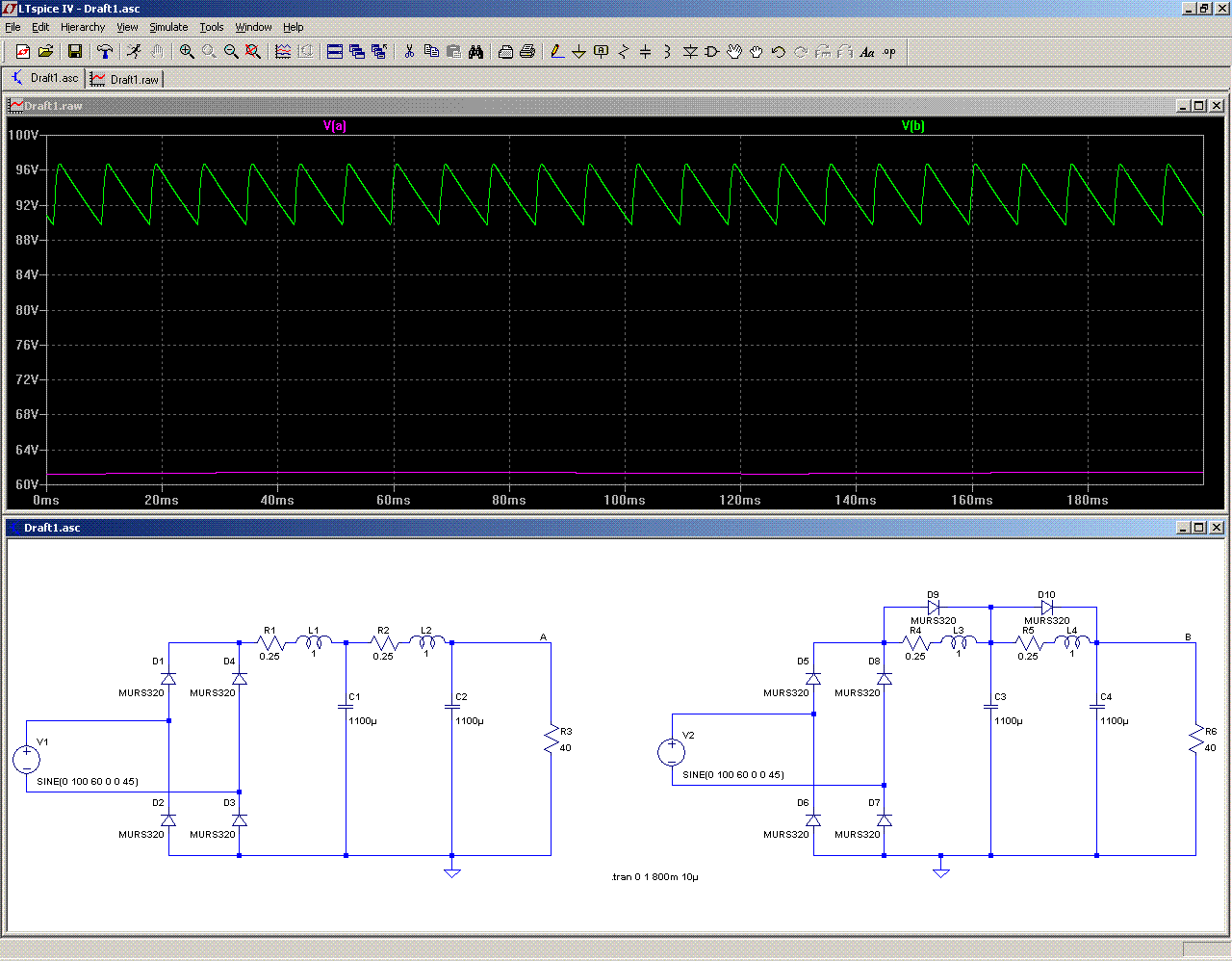

regarding your schematics of a +-100 VDC unregulated power supply posted above.
Wat are the diodes parallel to the chokes good for? -- since the current is going thru the diodes instead thru the chokes, the would bypass the chokes, wouldn't they?
okmog
The current is going through the diode AND the inductor in parallel, so it's not bypassed, it's just an optional route.
since the inductor is there only to fill in gaps in the current acting as a filter, not a primary power conduit
This design has several advantages including transient performance and it allows you to use cheaper low power inductors

OK, let's see what that means. Let's arbitrarily assume a current of 100mA for simplicity. The choke will have an IR drop of .01V or 10 mV. That means the diode has a forward bias of 10mV. Look at the data sheet for 1N4148. At 10mV bias, it passes ZERO current. It's an open circuit, it does nothing. Not until about 650mV at room temp.
Let's now crank up the current and assume that "quite low but then changed" current means the limit of your inductors, 5A. Now we have an IR drop of 500mV across the inductor. Look at the 1N41248 sheet again, ZERO current at 500mV.
One more time. Let's say the inductor can be overloaded and we go to 6A, the rating of your diodes. At 6A load current you have a 600 mV forward bias on the 1N4148. Data sheet, current still ZERO. Open circuit. See where this is going?
It will take 6.5A of load current before the 1N4148 does anything. That exceeds the ratings of both your rectifiers and chokes and requires 650W++ transformers 🙂
Now you tell me how you envision the operation of these diodes, what they do and how they do it.

The diode is installed so that it does not conduct under normal conditions. When current to the inductive load is rapidly interrupted, (such as turning on and off ), a large voltage spike may be produced in the reverse direction (as the inductor attempts to keep current flowing in the circuit). Yes I believe its a snubber circuit, and this is the intention Krell had using it.
No, that can't happen either.
First and foremost, you don't use a signal diode as a snubber. 1N4148 can only carry very small currents. Any inductive spike of any size will blow it sky-high.
Yes, in some circuits, when you turn the current off, an inductor can produce a voltage spike at the downstream side. For a diode to snub that spike, it would have to be connected backwards from what you show.
In this circuit, there will most likely be NO spike. See if you can figure out why.

I judge things on their merits, not reputation.
This scheme is not only worthless, it is detrimental, because it removes any benefit brought by the inductor, and the fact that it might have been used by Krell or anybody else doesn't change that reality:
Implemented that way, and in this context, it is a non-sense.

I am not interested in byzantine arguments about the meaning of words.
I said from the beginning the scheme is worthless because it removes the effect of the inductor.
Your post invites that it combines with the inductor in a negative way. does it for instance reduce the value of L ? does it add to the value of L ?
For a perfect inductor and a perfect diode, the diode will completely cancel the effect of the inductor for all conditions.
With real components, having a forward drop and a resistance, the effect will depend on the current drawn and could vary from none at low currents, conduction during part of the cycle at intermediate currents, and finally continuous conduction at higher currents.

And you? Did you try it?
But you guessed correctly: I didn't try it, for the same reason I do not need to push a fork into a mains outlet to know it will blow the fuse.
However, there is a good substitute for putting flaky ideas to the test: simulation. It takes 5 minutes and destroys nothing:
