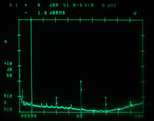

I measured different things with different levels and because I used the different levels of the attenuation (to use available resolution as much as possible) it would took some time to scale it properly every time.Bernhard said:OT: Why don't you scale your analyzer to 0dB @ 1kHz ?
That would be much easier to read the graph and see @ what level the harmonics are.
With a classic opamp I/V this can be done to be below the DAC chip’s distortion. However, I have found the things are sounding better if feedback is not used here. Hence the higher distortion figures. Btw, that graph above is pretty good figure for the common base I/V, ask Jocko.I know that the distortion of the I/V dominates when a 0dB signal is used.
Ok, this explains the things.Also even if the I/V would be totally clean, with 0dB signal the distortion of the TDA would be invisible on an analyzer unless you have a 1 million $ machine.
The lowest signal my analyzer can detect is -75dB, with averaging. ***
So this is why I asked for the -60dB signal.
*** The analyzer has only 12bit ADC but the repetitive accuracy is abolutely perfect.

Results from your undithered 0dB sine:
K2 -72
K3 -72,2
K4 below noise
K5 -73,9
but:
1800 Hz -66,9
2200 Hz -66,4
2600 Hz - 69
4200Hz - 66,5
There are two more OP27 in the signal path because I had to use my attenuator for best resolution of analyzer.
Oversampling was SAA7220B.
Bernhard

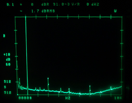

damn it...
Today I built a preamp with one OP27 and the 50Hz is gone.
Still I can not get the noise floor below -66dB with that amplification.
Tested is 1541 from CD650 with SAA7220B with 512 averages.
The bad news is that first I wired the whole thing to the other channel of the CD880 and I got a nice surprise...
The result was very different
Left ? K2 O K3 -59,5 K4 -63,8 K5 -49,3
Right ? K2 O K3 -56 K4 -63,3 K5 -64,2
K3 is better but K5 is worse.
So both channels need to be tested
I have still another 6 S1 silvercrown candidates...

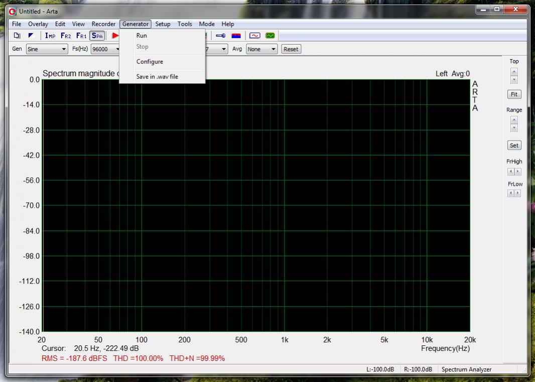

Sorry for bumping this... as we all know, Pedja's site is offline...
Where can I find these test tones, or can someone please send them?
Thanks!
Thanks!
I made one with Arta. It can save wave files on HDD af specified lenght and frequency (I used 991Hz so the harmonics are not on the "grid lines"), then you can burn those on CD.
mmm thanks.... only on the registered version though...
By the way, do you use 32bits and then dither (as explained by Pedja in this thread) ?
No, I don't dither, I think is cheating (lower bits will be noise, not data). Straight 16 bit.
I don't remember exactly, I did got somehow the Wav file on HDD... I need to get back home to check.
