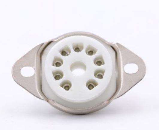

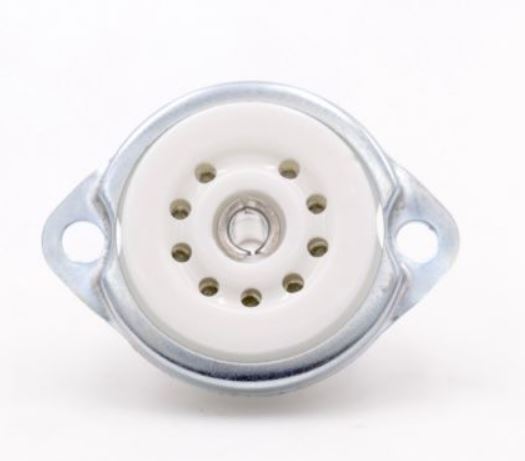

Lingwendil, do they usually mention the material from which the socket was made of? Or do you define that just by looking at the picture? I see there are brown and white ones.
kodabmx, thank you for proposal! Do they have pads for screws? I believe that's what I will need to mount sockets.
They are like the ones I linked. Chassis mount with solder tabs designed for point to point wiring.
And yes, the white ones are ceramic, and black ones are usually bakelite.

Personally, I find Chinese sockets work well enough if you don't do a lot of "tube rolling", but I prefer NOS Soviet parts.
I find GDparts to be reputable. Never had any issues, but of course you might want to buy them from the USA instead of China.
I like Soviet tube amp parts, but there don't seem to be so many available on eBay as in past years.
One caution about the ceramic Chinese sockets - some of them have smaller round pin holes and on a couple I ran into 'undersize' holes in the ceramic. So be sure to test before you bolt them into a chassis!
For the 9 pin mini (Noval) sockets, I suggest you acquire mica loaded phenolic, not ceramic, parts. Mica loaded phenolic has some vibration damping capability.
