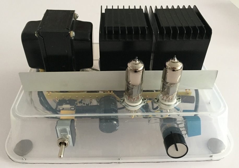

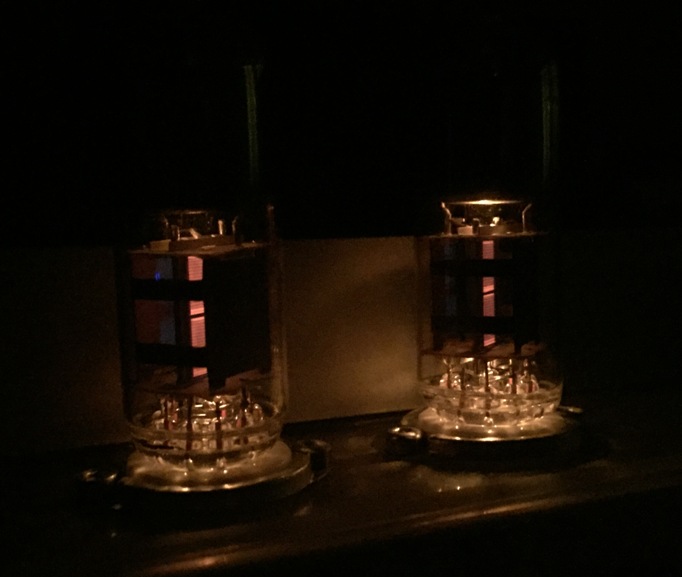

Nice project! Having a real tube amplifier instead of a fake one is surely a big advantage for the sound quality, if you use a high quality, high efficiency speaker. Tubes become hot, do not put any heat sensitive device near them. If you need to use plastic parts, use a sheet of metal as heat shield.

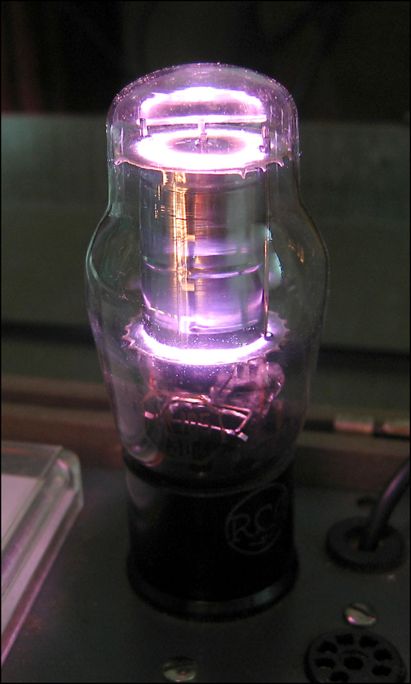

You are also looking for something that glows: I suggest a 6E5P "spud" amplifier. The cathode of this tube is exposed, so you will see it glow when the amplifier is turned on. The enclosed picture is my build of the schematic described here: Spud Amplifier with 6E5P Tube. It works and sounds really well, power output is lower than your requirements but it does not matter if you have a high efficiency speaker.

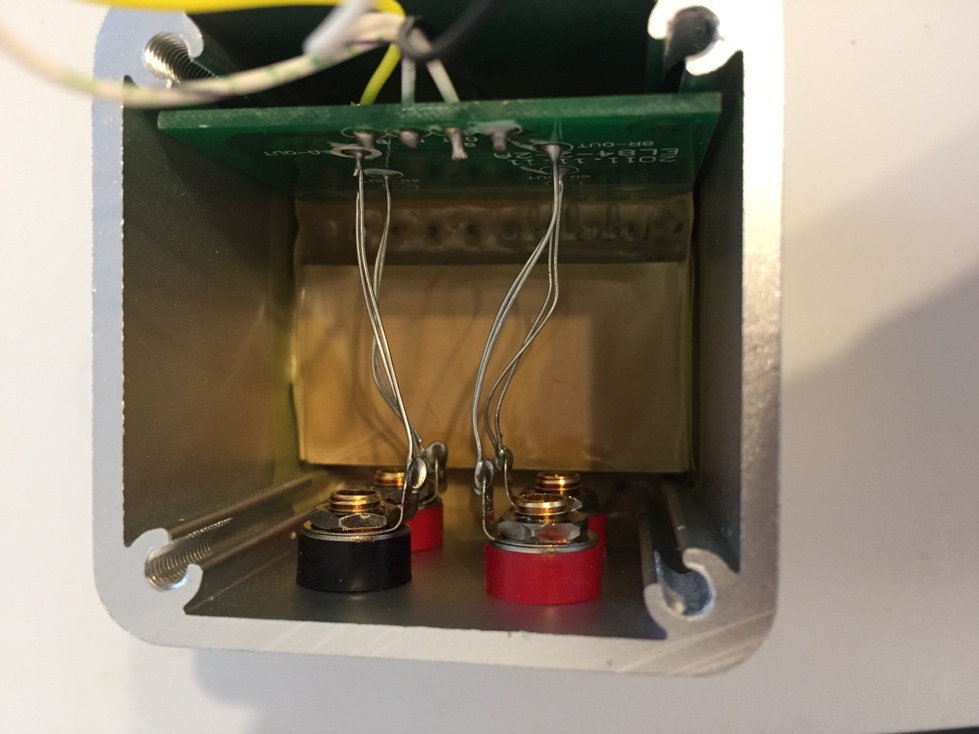

If you still want to buy the ready-made 6AD10 appj tube amp, be aware of the drawbacks. The output transformers are tiny and low frequency response is not good. I attach the picture of the inside of the transformer cover of the EL84 version of this amplifier, I believe it is the same on the 6AD10 version. As you easily see, the output transformer has the same size of those found in the kitchen radios from the '60 (but high frequency response is better on this modern part). For $200, you may get much better quality elsewere.
The 6AD10 tube is a standard one and therefore only the top and bottom part of the glowing cathode are visible. On most China sourced amplifiers there is a big red LED underneath the tube to light it up, but it looks fake to me.

Thank you pcan! That's probably what I need. The wattage is lower then I expected but hopefully I can find small efficient speakers.
The size of transformers is a bit on a large side but I hope that at least the one for the power supply I could keep outside of the enclosure.
I'm not sure which current is flowing in that amp. Could you give me the wattage of the resistors used in the amp?
Is it better to buy a matched pair of the tubes or it doesn't matter for this amp?
How long the pair of tubes can serve if I will use the amp let's say about 2 hours a day? I'm just wondering how many pairs I have to buy.
