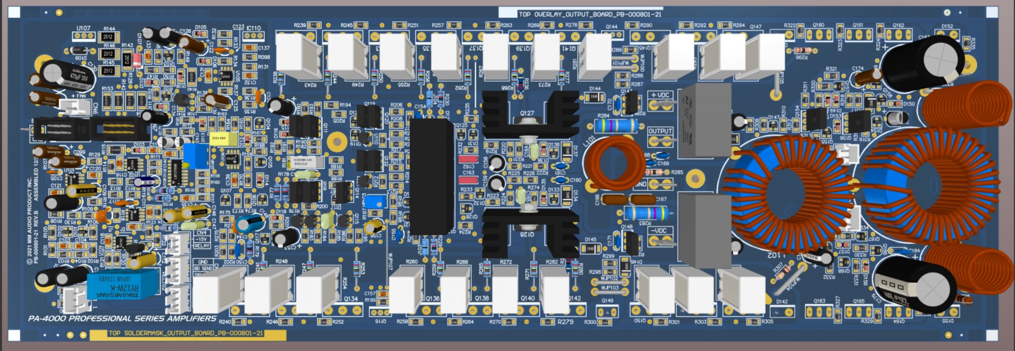

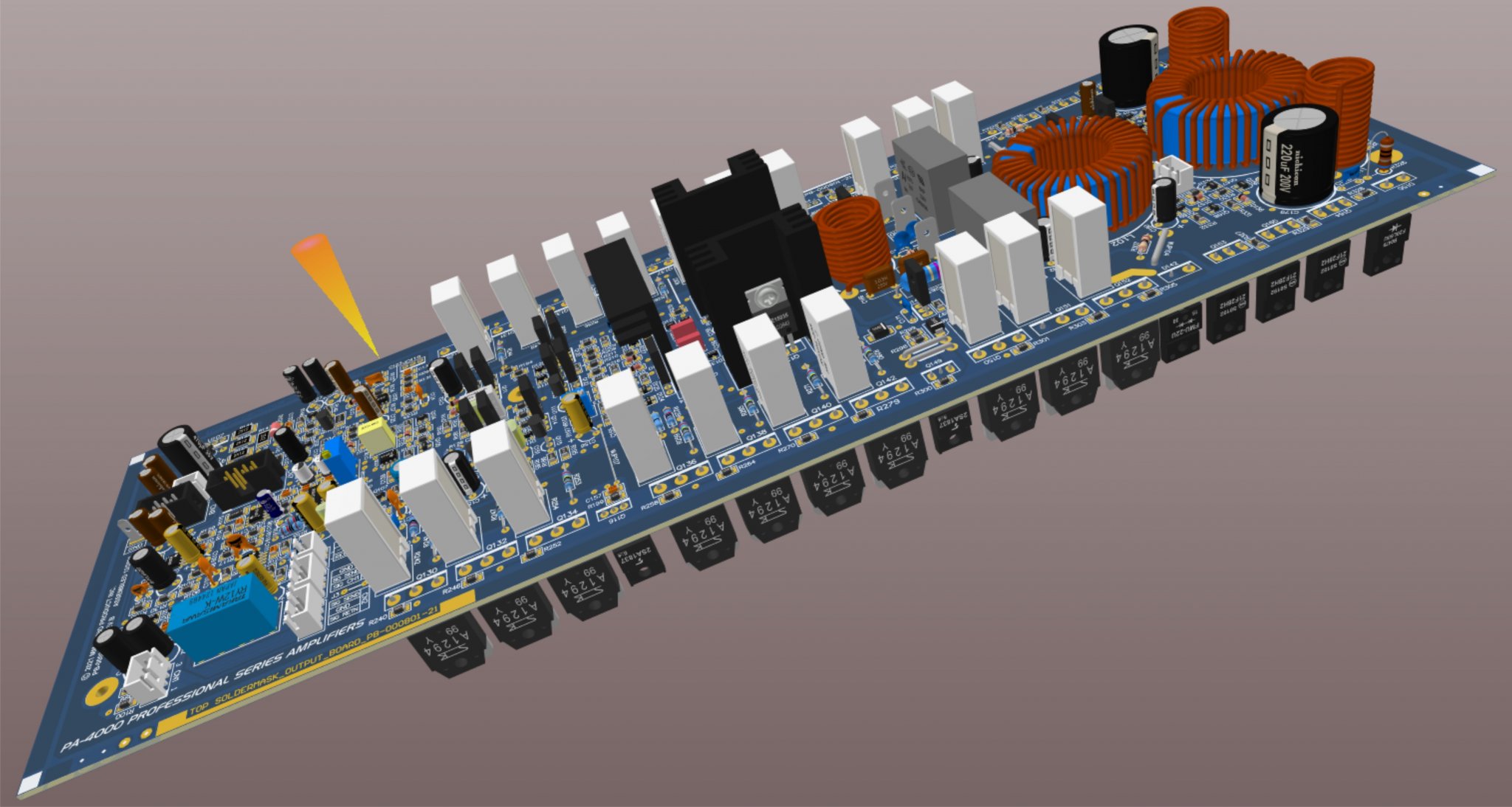

Well, actually I'm cloning Yamaha's T5N power amplifier but without that digital crap. After all these years I just want to get this done. For fun of course, not for commercial purposes. I don't want to go deep down into technical details since everything about Yamaha's EEEngine is explained in datasheets and on the net as well. So, it's a 2300W amp. The supply voltage is +/-160V. That's why I'm insisting on high voltage transistors, see datasheet. As you can see 2SA1924/2SC3425 are used in a cascode configuration and as pre-drivers. Since these transistors are way obsolete and unobtainium I decided to replace them with KSA1156YS/KSC2752OSTU. Btw, I have a bad OCD (perfection) 🙁 when it comes to matching transistors. I know it's hard to match PNP/NPN transistors but I wanted to find pairs with a reasonable close parameters. That's why I ditched KSA1156YS/KSC2752OSTU and now I'm trying with 2SC3840/2SA1486. Yamaha is also using them in their TXn series. The project has gone to the point of no return. Only a nuclear war with Russia can stop me. 😆 All components are in check except the transistors above. The PCB is almost done, some minor corrections needs to be done. Btw, the power supply is another story and I won't go into details here.
@wg-ski, you're an experienced member here and I appreciate all yours comments. Please look at the schematic and share with me your thoughts. Other members are welcomed as well. Regards.
You could probably sub either pair and not know the difference. The predrivers are in the main signal path, but it’s a triple EF. In a triple EF, the second stage beta and linearity are what is important. First stage current swing isn’t a lot, except when driving 2 ohms where the output stage beta falls to less than half. It’s expected and acceptable for distortion to increase at 2 ohms. In the EEEngine control circuit where the cascodes are the gain just isn’t that important.
I was using them as predrivers are VAS beta enhancers (First half of a darlington). in neither case was a screaming HFE needed, but a relatively low Cob and being heat sinkable were required. Supply voltage was a little more than what you’re playing with.
