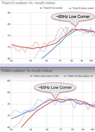

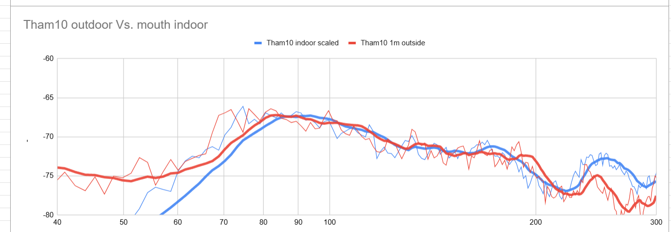

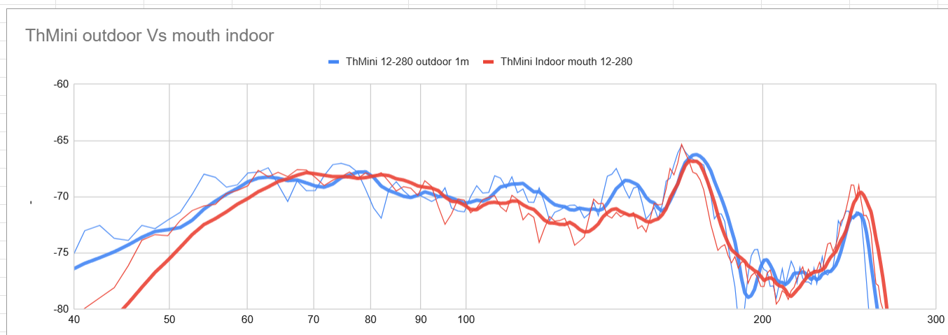

My main interest was some feedback on the measurements and the method. I got that so thank you..
