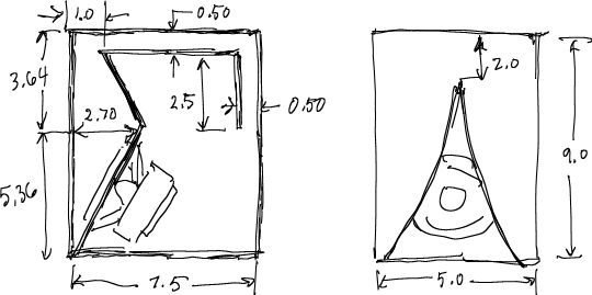

Nearfield "truly" fullrange speaker with Dayton RS100-4

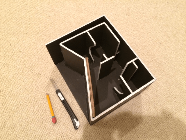

There is the XKi speaker (fitted with RS100-4) that works great near-field. It needs damping pads in the front chamber and aperture but has a nice deep response and sounds quite nice. This is the alignment for the 6th order bandpass reflex: 4.0 liter rear chamber and 1.0 liter front chamber with a 0.5in x 5.0in x 9.0in long vent.
I made it in foamcore to test it out:
Here are some plans out of wood that a member made:
rs100-xki-png.1063863
More info here:
https://www.diyaudio.com/community/threads/xki-xs-ab-initio-karlson-6th-order-bandpass.268524/
The advantage is wider dispersion and the aperture acoustically filters some of the mids and highs so that the bass is more well matched. Almost like a baffle step compensation. There are some dips here and there - it’s not a “monitor” but sounds very musical. You might try it in foam core first to see if you like it. Not everyone does - but I think when built of wood, care must be taken to use enough damping pads in the front chamber or it sounds a bit reverberant.
Reactions: GM and Booger weldz

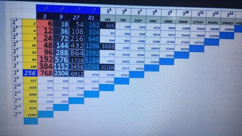

The nasty phase anomaly that exists at mid 80s causes all kinds of issues that are hard to discern or predict.(
All of these numbers if lined up perfectly would be as seen here where its all exposed ?

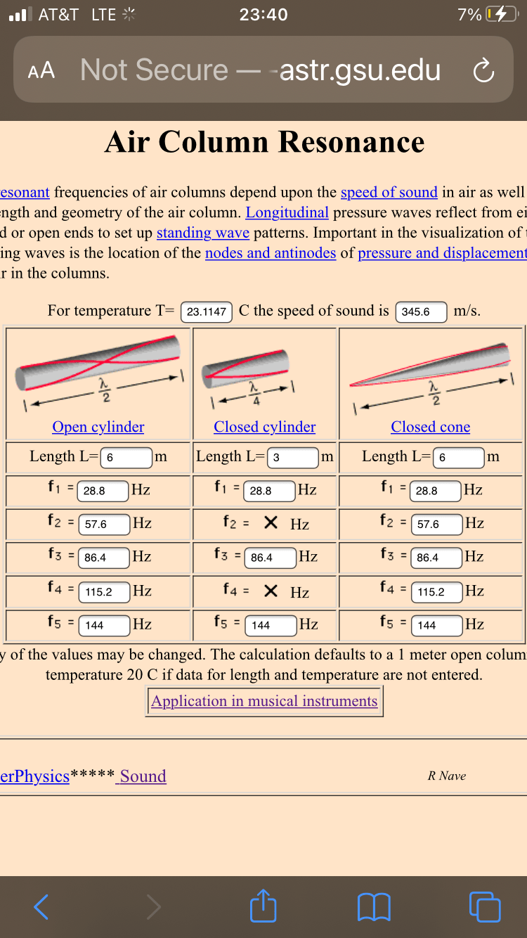

At a certain point somebody has to admit around infrasonic something happens where you might as well just give in to the big fat knee , Because that’s the only way you’re gonna enjoy it(???) feel it, Is by enforcing and designing it to be in there so it is very potent

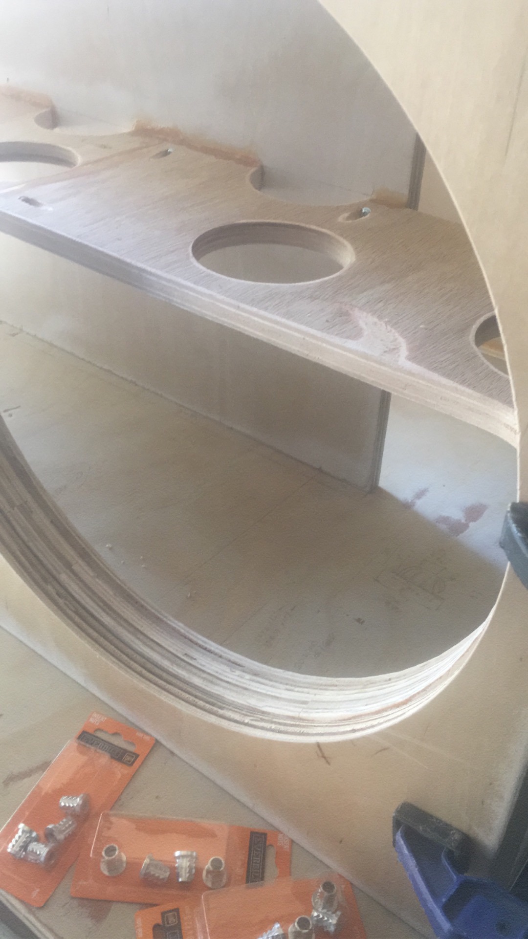

iI (as of the last ~year or so religiously put the mid bass and midrangish driver in a stuffed TL (full range TL often too). maybe it’s how we ‘hear’ ? I had ‘tubes’ in my ears twice as a kid. adenoids and tonsils pulled out? 😨??

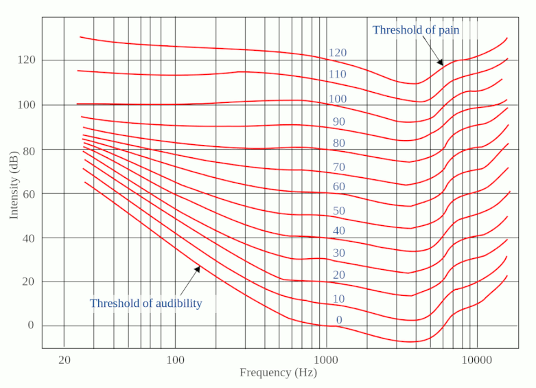

Right, we all hear the same, yet not so much!
You know, evolution spent hundreds of millions of years perfecting our hearing - so that we could hear a lion roar in the distance, or the rustle of the dry grass where the tiger was hiding, or the call of a family member across the savannah.
Our ears are also excellent at all sorts of sophisticated audio signal processing. We can walk into an unfamiliar room blindfolded, speak or clap our hands, listen to the sound, and our ears can give us a pretty good idea if it's a small room or a large room. If our ancestors really did live in caves, it's easy to see how very useful this ability would have been.
But you know what our ears were never designed to do? Listen to music! That was not an evolutionary need. Our ears make terrible measurement microphones, with absolutely horrible frequency response. Just look at the Fletcher-Munson equal loudness contours. They're anything but flat!
Then there's stereo imaging. The illusion of stereo is based on the idea that if the same identical sound is produced by two identical speakers symmetrically placed left and right in front of you, we hear a single sound source in the middle. We're all familiar with that idea.
But can you imagine if our vision worked the same way? If there was a terrifying lioness on our front left, and her twin sister on our front right, can you imagine if our eyes only saw a single lioness in the middle?
How long would our species have lasted, if our vision had been that faulty? If we saw only one lioness where there were actually two? We'd probably run straight into the path of one of the real lionesses, while trying to run away from the non-existent lioness in the middle. Chomp! Snarl! Growl! One more slow, stupid, ground-dwelling ape gone to the great grassland in the sky.
So our hearing is terribly flawed. It's great at the things that kept our ancestors alive on the African savannah 200,000 years ago. But it stinks at critically evaluating music played back on loudspeakers. We even believe there's sound coming from places where there are no speakers at all (stereo imaging).
Music came along long after our ears were done evolving. It was just an accident that long-ago ancestral monkeys on our family tree started hooting and screeching as a way to signal their territory, and as the millions of years rolled by, those hoots and screeches eventually evolved into music, then into speech.
Another 300,000 years go by, and humans invent ways to capture and play back music. And now some of us get very obsessed about how our music sounds. 🙂

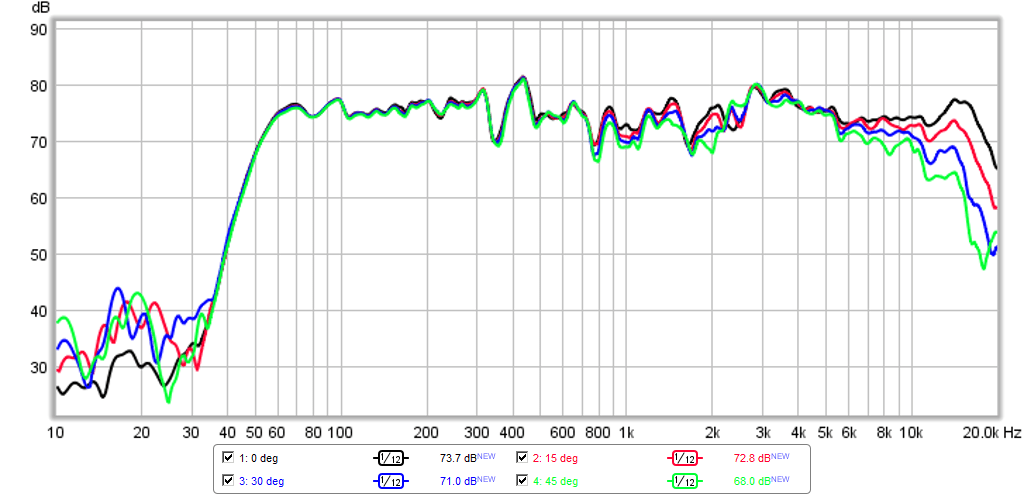

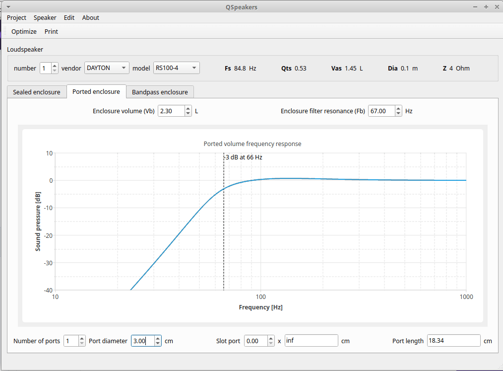

For fun, I entered the Dayton RS100-4s parameters into Qspeakers, and played with it a little.
Qspeakers thinks a 2.3 litre ported enclosure, with the port tuned to 67 Hz, produces a pretty flat response, with a relatively gentle bass roll-off, and still gets down to 66 Hz (-3 dB).
I like White Dragon's suggestion (post #37). A pair of Dayton RS100-4 in 2.3 litre enclosures with the above tuning could cross over to a sub at 70 Hz or so, which is low enough to have no problems with directionality or "phantom bass" appearing to come from somewhere else.
I know the original intention was to avoid a subwoofer. But 4" speakers are tiny little things. IMO it's hard to get them to go much below 70 Hz with any reasonable sensitivity or SPL capability.
-Gnobuddy
