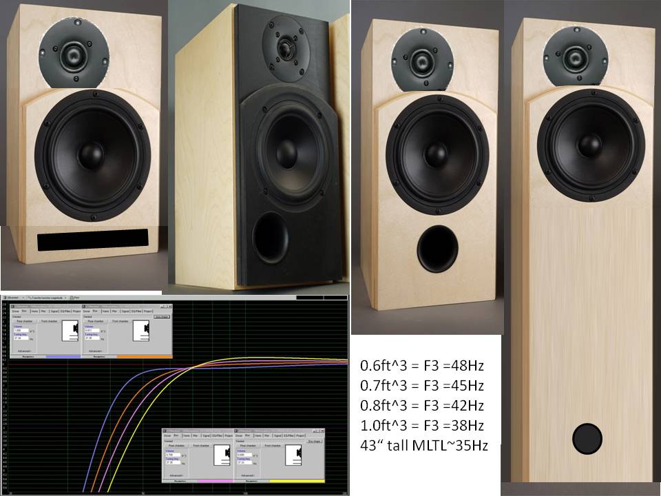

Consider this SB_Acoustics ported example.
=============The Devil is in the Details.
I would like to work on a small Nearfield monitors. For first run and test I will use active crossover.
??? Will you ALWAYS use DSP crossover -OR- must the design also work well with a passive crossover
??? Does your DSP include time delays to compensate for driver physical offset
??? A passive design will require a larger ported cabinet for bass goals than active with DSP bass boost

The port is normally put on the rear panel behind the tweeter, or on the bottom of the front panel. Troels Gravansen monitor cabinet is one example.
Example: Volume vs F3 for SB17NRXC35-8
0.6ft^3 = F3 =48Hz
0.7ft^3 = F3 =45Hz
0.8ft^3 = F3 =42Hz
1.0ft^3 = F3 =38Hz

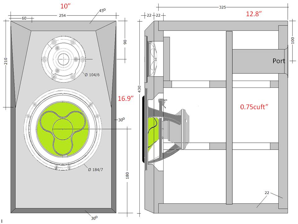

The tweeter in the pic in post #2 is SB26STAC-C000-4. The crossover is my design which has been posted here previously but I have no idea about the enclosure as I do not know where it came from or whether it uses that crossover.
I would not use it nearfield as I think it could go too low but could be modded (size and tuning) as well as if it was sealed instead of vented it should be OK for around 65Hz. The woofer could be changed to SB15MFC30-8 with minor crossover changes to give a smaller design.
For nearfield work I usually go for an F3 between 50-60Hz and all the ones I use range between 60-75Hz. For nearfield I use drivers 5" or smaller.
One of the speakers I use for nearfield is Jeff Bagby's Soprano but may be a bit small for what you are after.

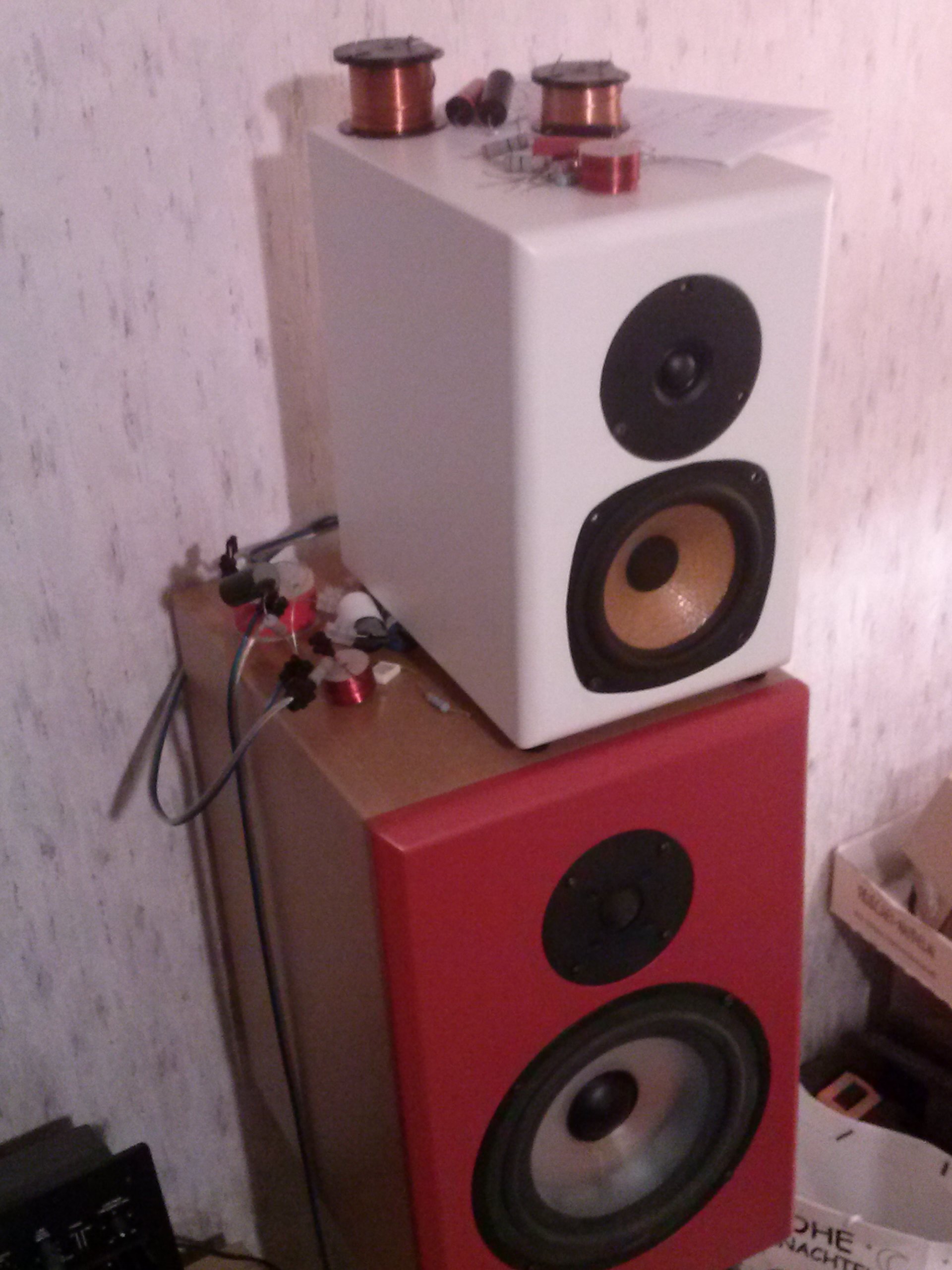

an Oldie Davis 13KLV5(M)A
Hi gug,
may a bit idea to older speaker.
I like the Davis 5", it is real a very old chassis, it has 91dB/spl and goes to 57Hz in ~7liter vented volume and is linear to 4kHz.
Newer chassis you would difficult find all combined.
My tests are based on B. Timmermanns construction in late 90'is.
I have experimented with Expolinear RT-4Pro and finally a result what i like to
listen.
Many other options with own magic possible.

1) A cabinet design with 20-21 Liters (0.7-0.75cuft) completely empty, ends up close to 17 Liters (0.6cuft) after adding the speakers + crossover parts + bracing + port tube. Internal sound absorption material like fiberglass and wool will increase the effective volume.So you can go sealed or vented in 17 Liter cabinet.
2) For greater usage flexibilty, you can include a port which is easy to plug, or easy to unscrew and remove.
--sealed 0.6ft^3 produces -F3 =62Hz
--Post #5 ported 0.6ft^3 produces -F3 =48Hz (2" internal diameter pipe, 11" long)
--studio monitors typically favor a front port for direct impact, home speakers typically favor a rear port for room intergration.
3) Bevels or Rounds... on top monitor cabinets. Reducing edge diffraction distortion is worth the effort to cut top edge bevels around the tweeter as in Post #5, or use a router to round the cabinet edges. A router with a 0.5" chuck can run a 1.5" radius quarter round bit. A 2xThick baffle is required.
