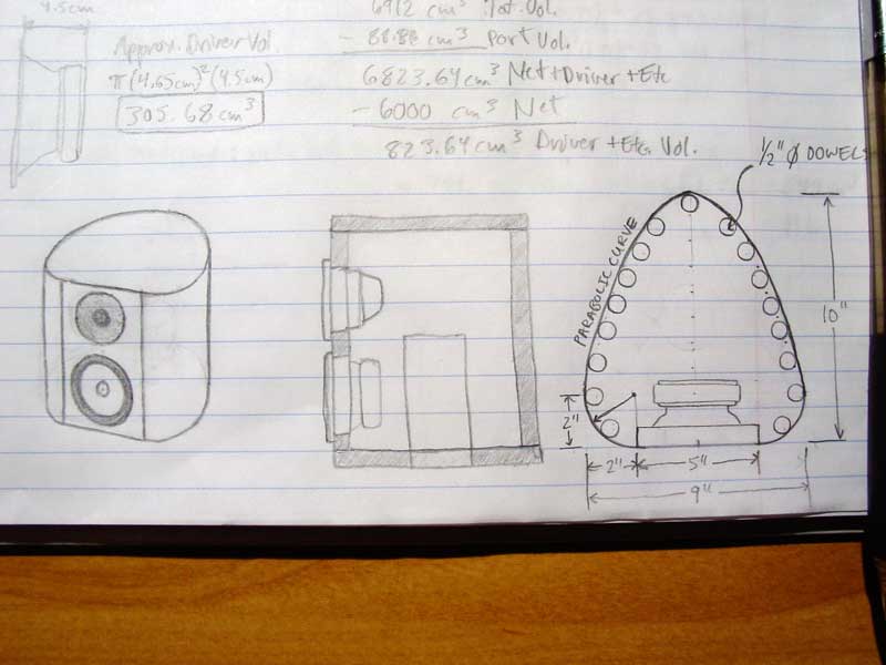

I'm looking to build some nearfield monitors using a pair of FE103E's (possibly with a pair of tweeters as well with an active crossover in a bi-amped configuration), and it seems like the best route to go for that would be a bass reflex enclosure.
I've come up with an interesting enclosure design but need some help figuring out the best internal volume and port tuning. You can see the concept sketches I made in the attached photo.
From my drawings and measurements I came up with the following numbers (I overestimate a bit so I end up with slightly larger volumes):
Approx. FE103E volume=14.518cu.in (0.238L)
Approx. Tweeter volume=12.622cu.in (0.207L)
Port volume=25.243cu.in (0.414L) *The tube I have has an outside diameter of 2.75in and internal diameter of 2.5in and should be about 5in long for a tuning frequency of about 95Hz - this will obviously change if the tuning frequency is changed, I picked 95Hz because that's what the Fostex recommended bass reflex enclosure is tuned to.
Net area of a horizontal cross section of the enclosure=60.53sq.in (368.980sq.cm)
(for the English unit folks) Approx. Net Internal volume (in cu.in)=(60.53*internal height in inches)-(14.518+12.622+25.243)=(60.53*height)-52.383
(for the SI unit folks) Approx. Net Internal volume (in L)=(390.515*internal height in cm)/1000-(0.238+0.207+0.414)=(390.515*height)-0.859
The max. height the enclosure can be is 12in internal, so that ends up being a max. net internal volume of 637.977cu.in (11.044L). The min. height the enclosure can be is about 8.5in internal, so that means a min. net internal volume of 462.122cu.in (7.572L)
Can anyone help me come up with a good net internal volume and tuning frequency? Anyone with Martin's worksheets willing to model this little guy?

A couple things regarding the construction of this enclosure. The idea is to cut a top and bottom out of 3/4in MDF and drill 1/2in holes through both panels so that 1/2in dowel rods can be inserted to link both panels and to provide the framing so that I can wrap thin sheets of wood around to make a nice curvy enclosure.
As far as that goes, I was wondering if that sort of construction along with some fiber fill in between the dowel rods would basically nuke any sort of standing waves inside the enclosure and how that construction would have an effect on the internal volume perceived by the FE103E?
I also wanted to place the port on the bottom, but then I'd have to raise the enclosure up off the stand/surface by at least a couple inches for it to function properly, right? I was even thinking of keeping three of the dowels (two closest to the front and the far rear one) longer to use them as legs to lift the enclosure up a few inches or so. Any reason why I shouldn't/couldn't have the port firing upward instead (besides dust or objects getting in and that can be remedied using a little piece of acoustically transparent cloth)?
Also, will the baffle diffraction step be calculated assuming the enclosure is 9in wide even though it has the 2in radius on both sides?

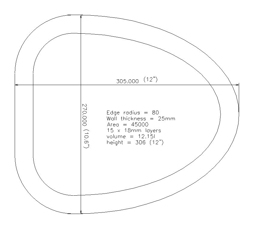

It's certainly serendipitous, although mine is not quite the same as yours as it will be a closed box driven by an amplifier with significant output resistance. I modelled it using WinISD (very good software). I wanted to make my box out of a composite of 3mm plywood skins with a 1" balsa core but couldn't work out how to cut the balsa blocks accurately, so I'm having to go the wasteful route of cutting loo seats of MDF and stacking them..

If you plug up the port on my design you would basically have the same enclosure as your design - although our construction methods would definitely be different. So you'll be using a tube amp to drive these then(high output impedance)? I plan to use some small class d amps which are in the works as well. It will be interesting to see what we think of these guys when we get them built.

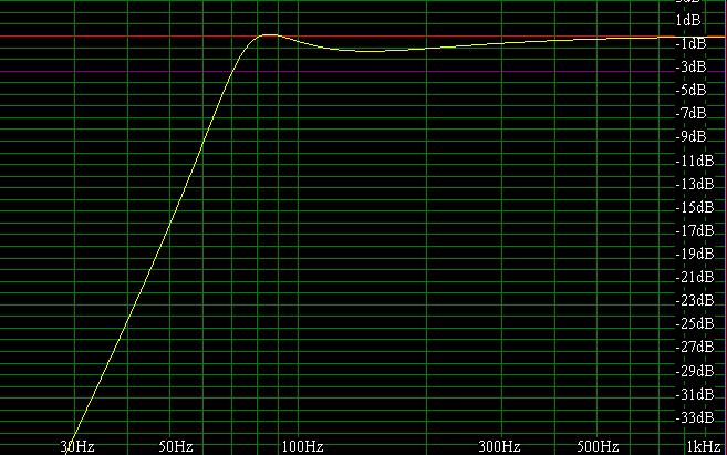

Yes, I'll be using a valve amplifier with a deliberately high output impedance. I popped FE103E and 11 litres into WinISD and asked for a reflex box, then played with the tuning. A port diameter of 68mm and length of 114mm yielded the following.

That's not too bad, although I think it would be better to get rid of that little droop in the response by tuning it a bit higher. The T/S parameters I measured are a bit different from the ones quoted by Fostex:
Fs 104.379997
Qms 3.585399
Qes 0.561606
Qts 0.485550
I'll eventaully measure Vas whenever I get around to building a test enclosure. I've been using the quoted 6.9L in the calculations.
